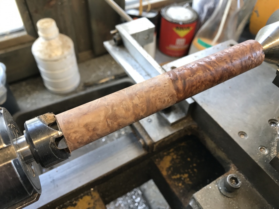

I've just done a quick test with a couple of finishes I had to hand. On the left side of this blank is Matt Acrylic which is touch dry. On the right side is Satin Polyurethane which is still wet. I'll wait until it's dry but I may buy some Matt Polyurethane to try before deciding on a finish. The blank is Brown Mallee Burl.

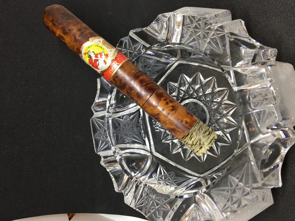

I sand to 320 then apply a sanding sealer. After it dries I apply Yorkshire Grit and then finish with Hampshire Sheen Original. Gives a nice "feel" of wood without the glitz of a plastic cover (as with CA). The pen in the photo (Thuya Burl) was done with this process.
I bit the bullet and bought some Matt Polyurethane. I've turned the finish off the blank and painted half Matt, half Satin. I'll leave it to dry overnight and see how it looks tomorrow.
