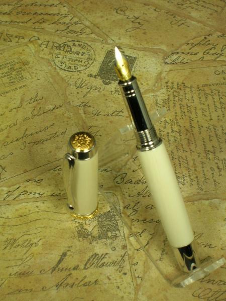

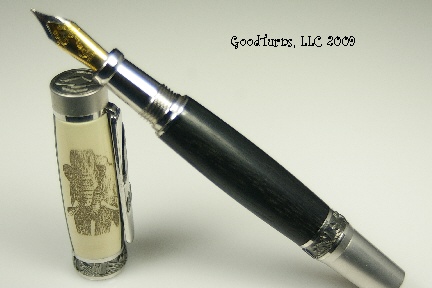

Ivory is probably my favorite material to turn (don't use it a lot $$$, but it turns like butter). As Mike said, temp is key, be gentle when drilling or it goes boom. Also make sure to reduce your couplers by sanding when pressing the pen together or you have a good chance of cracking the tube...and that really sucks (so I have heard).
Same treatment for mammoth, nice to turn, just be reasonable with it.
I do not use any finish on either, they feel too good to cover up.
Good luck if you give it a shot. I have gotten very nice blanks from the Warther Museum (Ivorybuyer.com, follow the links)
