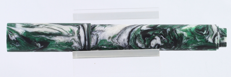

This is my first attempt at a kitless. . I used a 5" Alumilite blank so being limited by the available length, the cap is a bit shorter than I would like.
I chose to "copy" an El Grande because it seemed fairly easy with the tools I have (taps and dies).
Like Sandsini, I kept it very functional, straight lined and square shouldered.

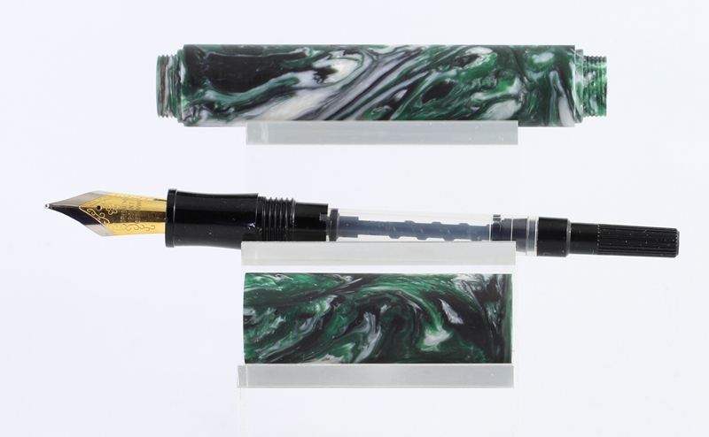

I didn't make the section ... it's borrowed from an El Grande kit.
The cap and body are not flush, and overall it's a bit on the fat side. Plus it is unpolished but I like the matte look. . All of that can change at a whim !

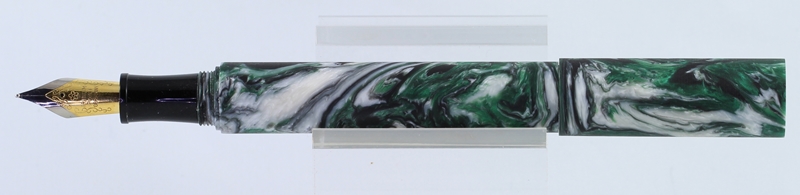

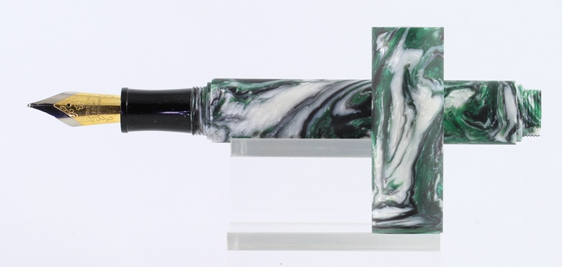

I decided to make it postable as you can see.
I can still change a few things, like adding a clip and a feature cap to extend the length of the screw-on cap.
This being my first kitless is a practice pen and I won't say what mistakes I made ! . Not the same finesse as Eric's posted this morning but it's a start ! I must say that I had a lot of fun making it up to this point.
As always, C & C are very welcome.

Well, Chris ... truth be known ... I *did* have an extra blank !
But I measured carefully and set myself the challenge of doing this first kitless with just one blank.
I have an existing El Grande assembled, and measurements showed I could do it with a slightly shortened cap.
So, I turned the whole 5 1/4" blank round, then used a parting tool to cut into 2 pieces, the longer of which was just a few thou longer than the minimum necessary for the lower barrel. The shorter piece was for the upper barrel (cap), of course. I did not ever need to shorten either piece.
Needless to say, I drilled the two pieces very carefully to the correct depth based on my measurements of the existing El Grande pen.
My finished pen, closed, measures 4 15/16" long. Screwing the cap on results in the threaded ends overlapping by 3/16".
So the total material length is 4 15/16 + 3/16 = 5 1/8", just 1/8" short of the blank's starting length. . The 1/8" missing from the blank's starting length is the width of the parting tool !
The kit pen has an overall length of 5 3/8". . Its cap is 7/16" longer than my kitless cap. Everything is accounted for !
Next time I make one of these, I will make the cap longer by adding a clip and a contrast band at one end or the other. . I try to get as much mileage as I can out of each blank !
