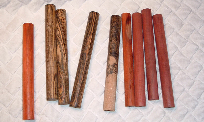

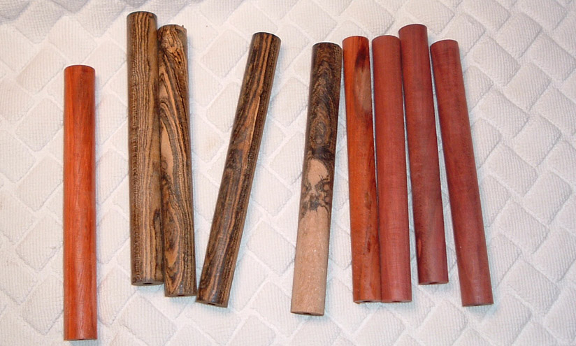

I had 10 blanks to use for making pens for the troops so I gave it a go with a 1" rectangle skew.
First I sharpened it properly. All of these blanks were turned from square to round without a single catch.
Amazing, and I dare say it did not take any longer than my old methods.

You say that you started with 10 blanks ???
I count only 9 in the picture. . Did you utterly destroy the 10th one ?
Never mind. . You seem to be in complete control of your skew and I congratulate you heartily for that achievement.

In my defense, I did not say there were 10 blanks in the picture! :rolleyes:

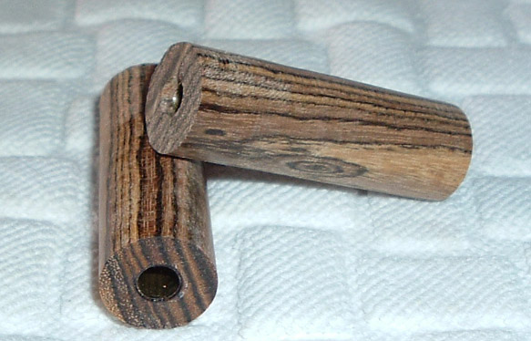

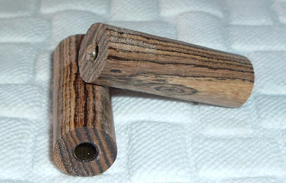

It has been a while since I've turned a pen so I got the first one to the point where I will square the ends before the last bit of turning.
No catches on this one either.
