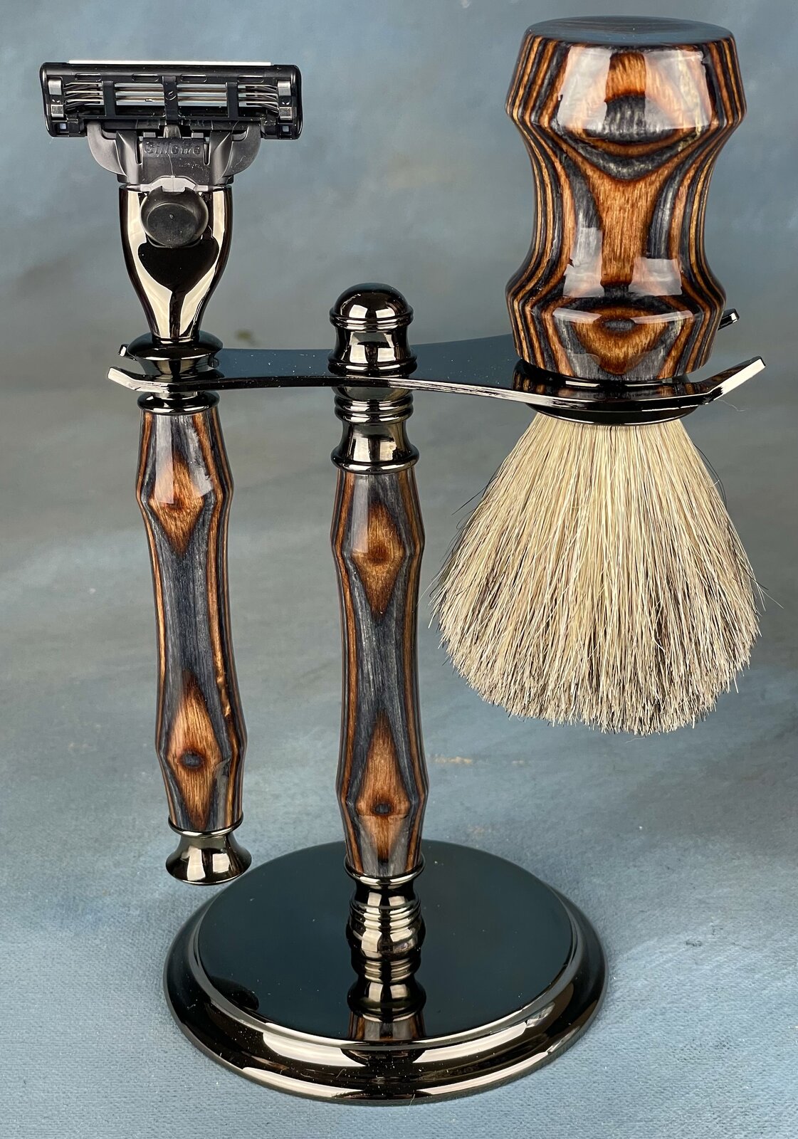

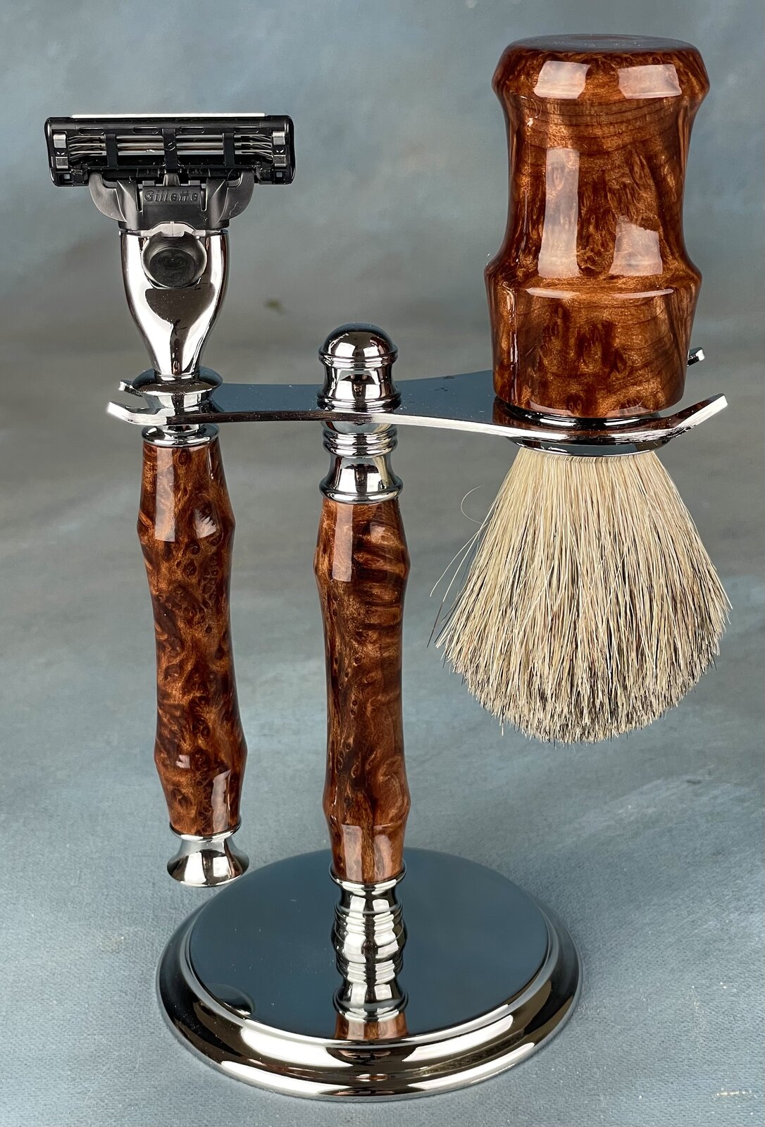

Redwood burl and spectraply.

I love turning shave sets and just wish they sold better in our area. Yours are exceptional and I never tire of seeing the sets that you make.
Your finishes are the best I've seen Mark. Something to aspire to. Also, beautiful Redwood burl! Is that from Rocky Bemis?
Either Exotics or CSUSA.
I use:
4 coats of EZ Bond thin 5 cps
12 coats of EZ Bond thin 50 cps Pen Finish
Sand with 400 grit plus three Scotch Brite (maroon, gray and white)
Flush sand ends
Seal the ends with thin 5 cps 3x
Buff with Tripoli and white diamond
