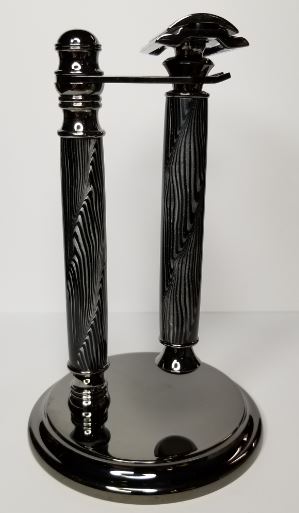

I made one of the CSUA Artisan for my son-in-law and was impressed with the quality of the kit. Very nice fit and finish. I used some very old Cellulous Acetate that complemented the gunmetal finish. Very poor photo, but the finished razor and stand came out fairly nice.
