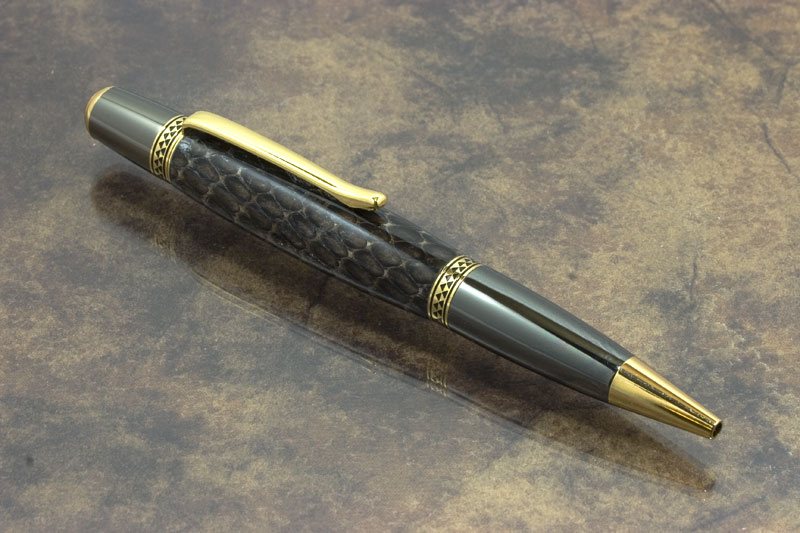

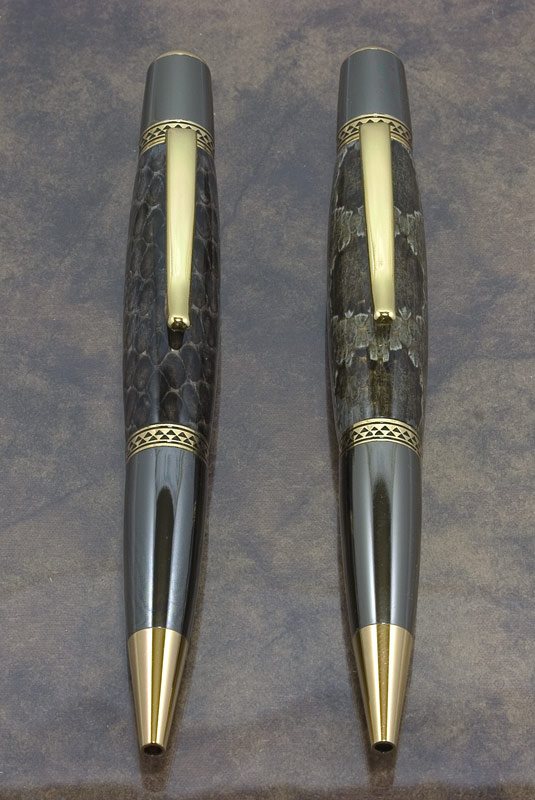

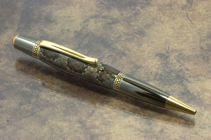

Here are some castings I made with them. For anyone new to casting skins read the tutorial from Don and don't skip steps such as not painting the tubes; they will show through :(
On the cobra one I can't figure why it seems like the PR did not fully stick to the skin. I cleaned them with denat alcohol to make sure there was mo oils from my fingres. I guess I have to try some more.
Thanks for looking and your comments

Sorry to read you are less than pleased with these. Tell you what, send them to me. I will take good care of "orphans" like these. [:D][:p][}:)]
These pens look great from here.
Tim
Man, I've got to try some of those. I don't cast, but after seeing those I sure need to buy some. Great pens, the color combination is on the spot. Great photos also.
The casting came out great and so did the pens. For tube painting I use a flat green from from colors used in Camoflauge designs. The can's label is CAMO PAINT but I forgot which brand. I get it at Sutherlands just because it is close to me.
I tried some cobra and the skin seemed to soak up the resin and turned very dark and a couple of spots did not allow the resin to stick.
