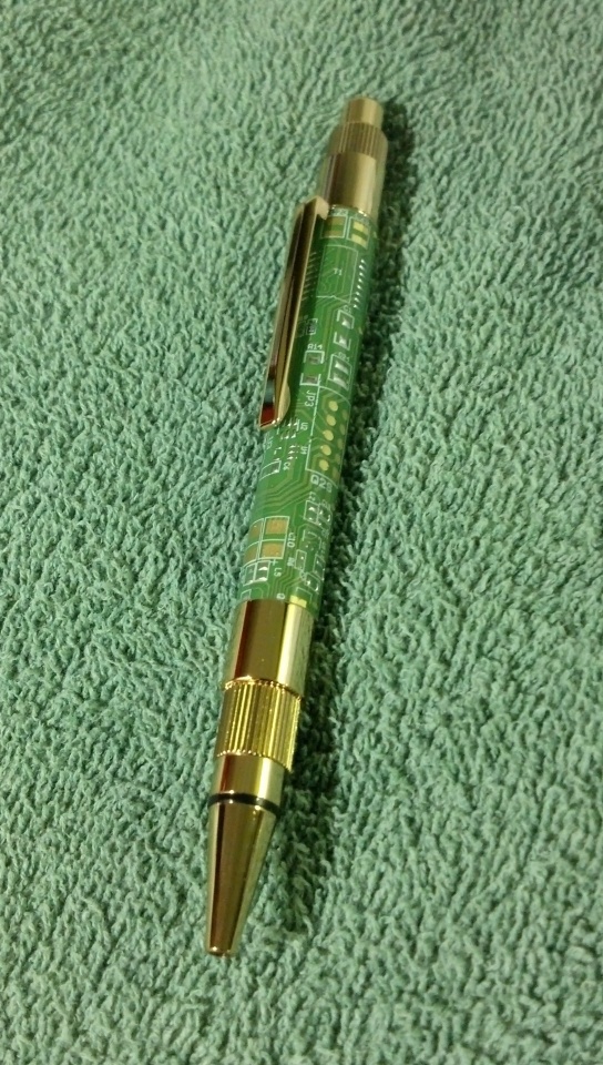

Circuit board on a 24k gold Stratus pen kit. I'll be keeping this one for me. This blank tested my patience. The acrylic was pretty dense and prone to chip out, had that scraping sound and produced hardly any ribbons during the turn. Had to be careful being my garage was cold at the time. I'll try the black circuit board once they are back in stock. No doubt we are all moving lots of pens this time of year. Anyway...

Thanks, but it seems the idea for these types of blanks were initiated here on IAP a few years ago. How the process is done may take some asking around. The circuit board blanks do have some topography to them and if they are using something to soften the backings to bend them would be a guess on my part. Manufactures have more money than we do so they figured how to mass produce them.
Never turning one before I found that these are a poly-resin? and turning them are different than acrylics. I quickly found that wearing a face shield, breathing mask, and latex gloves kept my face from being pelted with schrapnel, particulate out of my mouth, and 'snow' produced from the removal of resin off my hands. The skew and gouge only went so far. With an 1/8" left on the blank I turned the flat skew sideways and scraped off the rest down to about 1/32". Wet sanded down to just proud of the bushings, (didnt want any potholes). For the Stratus I was looking for no less than 11.88mm which is what the front end and clip measured out to be.
The result was worth the effort as anyone who has done one of these will attest.
