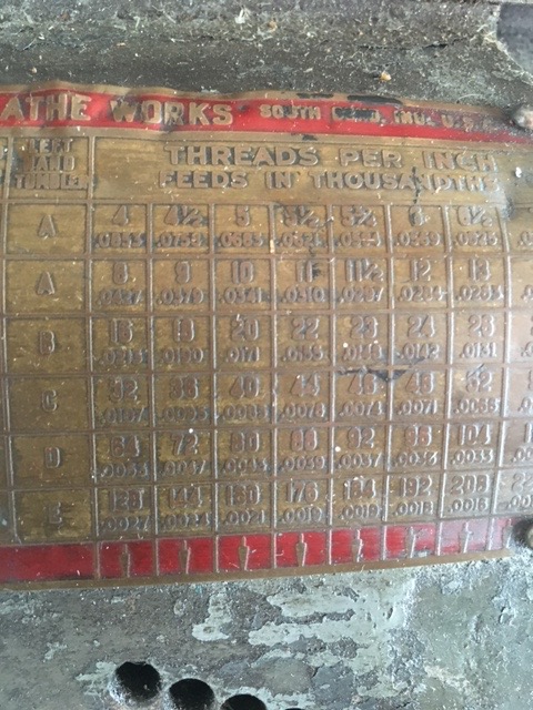

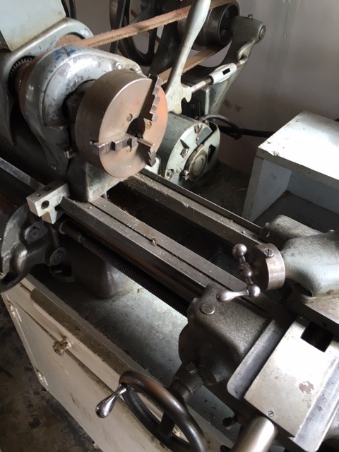

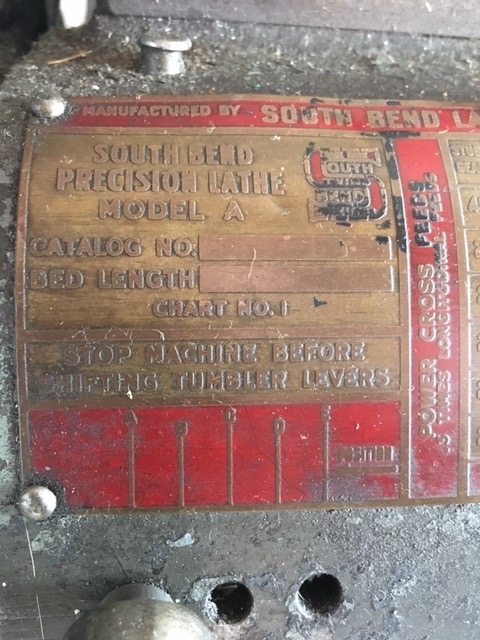

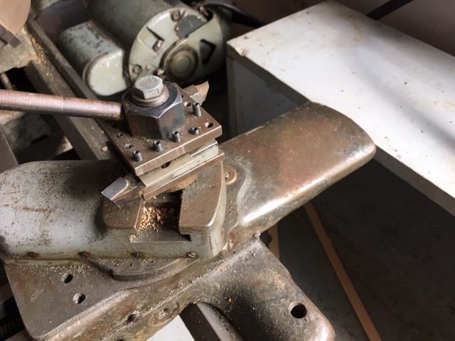

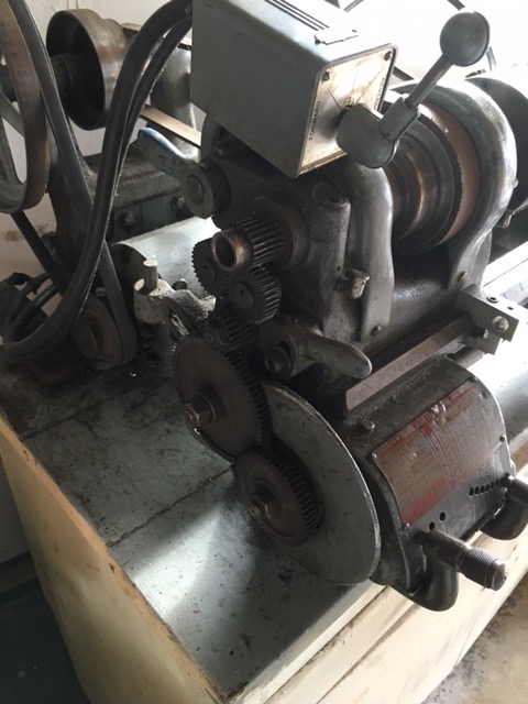

Its an early south bend Precision Lathe Model A Here are several photos

Good lathe to start with. Are there ridges at the top of the V ways that is one wear point. I had a SB that the lip was very noticable. Also the saddle would move very easily up at the front where all the wear was and get stiff as all get out back by the tailstock because it was adjusted for the wear at the front. Its a Quick change gear box, most people consider that a plus. Those gear boxes sell for $500- $700 on Ebay by themselves.
If the flat belt needs replace it can be done, they are available, you have to cut the new one to length and crimp the hardware on the ends. Is he looking for offers or does he have a price in mind. The SB variety goes for stupid money down here. They are few and far between and if they are in top shape they ask $2500 for them.
What else does he have for accessories? Follower rest, steady rest, taper attachment, are all top dollar add ons. Tool bits, meh they come with the lathe. Any extra Chucks?
Collets? If it has a live center thats good but those are cheap to buy.
Agreed. Better jump all over that. 9" model A is a good little machine. There is a similar one on CL here. Went and looked a while back. Needs some work. The guy was asking $1200. It went off CL, then came back on a few days later.........at $1500. Still there.
