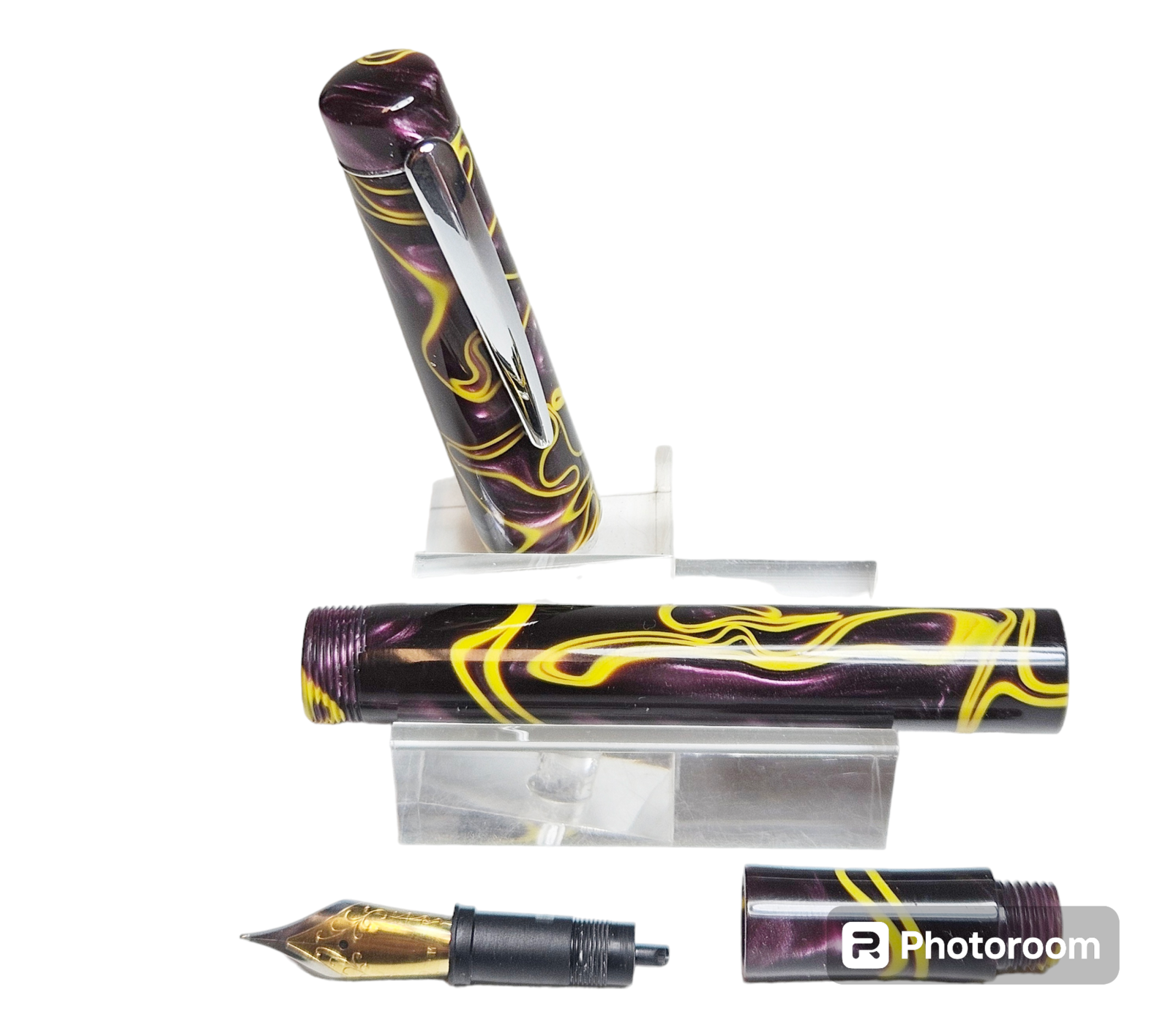

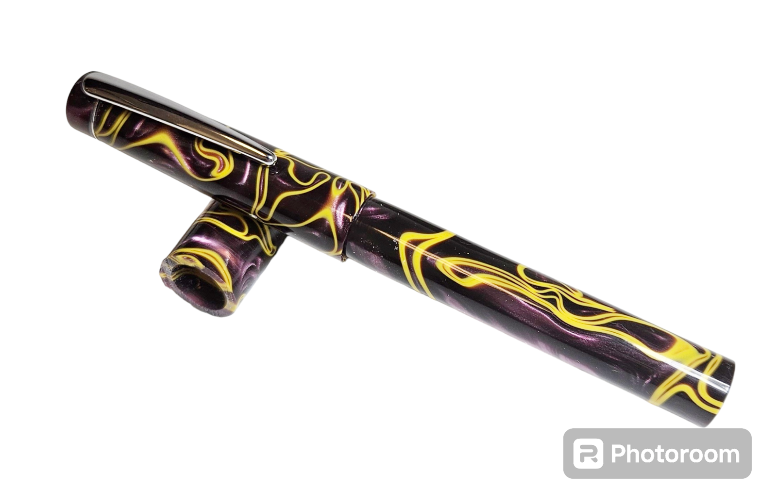

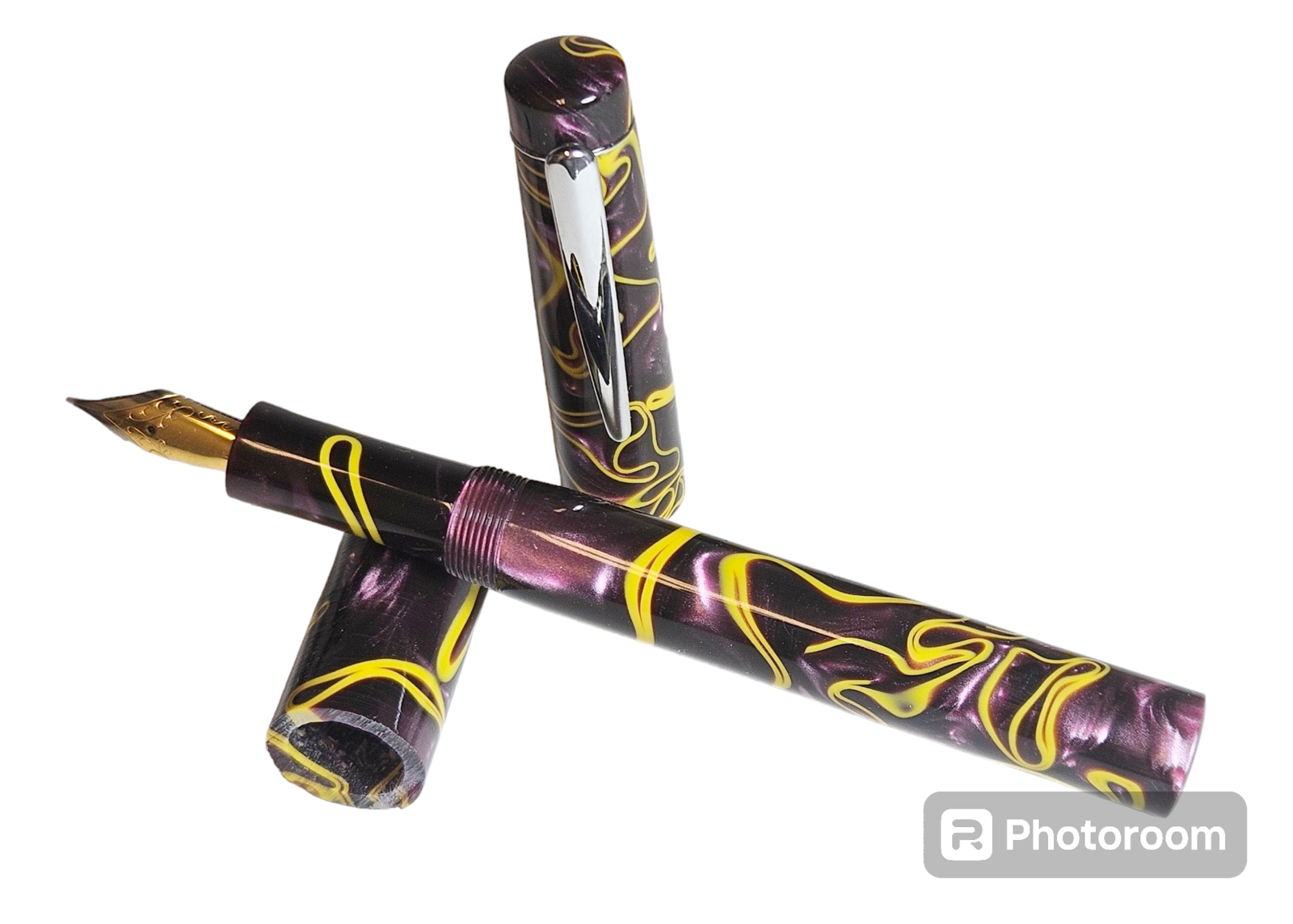

Material: Kirinite Acid Storm from Exotic Blanks. Threads nicely. No issues.
Cap-Barrel Threads: M14x.8 TL
Section-Barrel threads:M10x1
Cap Length: 2.31"
Cap Dia: .644 to .566(clip end)
Barrel Length: 3.11" (3.44" with threads)
Barrell Dia: .569"
Total Length: 5.86" capped
JoWo #6 Nib

Very Nice!
I haven't worked up the courage to try a clip yet.
It took me awhile. I have only made 3 pens with clips. I find it the most difficult part of making these pens. Two have had the clip ring exposed and one had it hidden. The hidden clip is the easiest for me. I would love to find the source for the clips with the roller on the end. I guess those are for the big players and they are keeping the info secret. I have searched and searched.
Thanks for looking and for the nice comments about this pen. The blank may be one of my favorites. First time to use the purple and yellow but it will not be my last.
