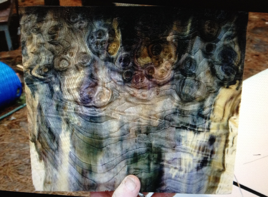

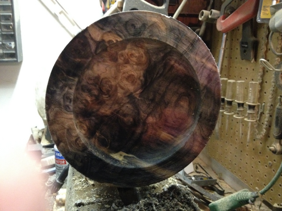

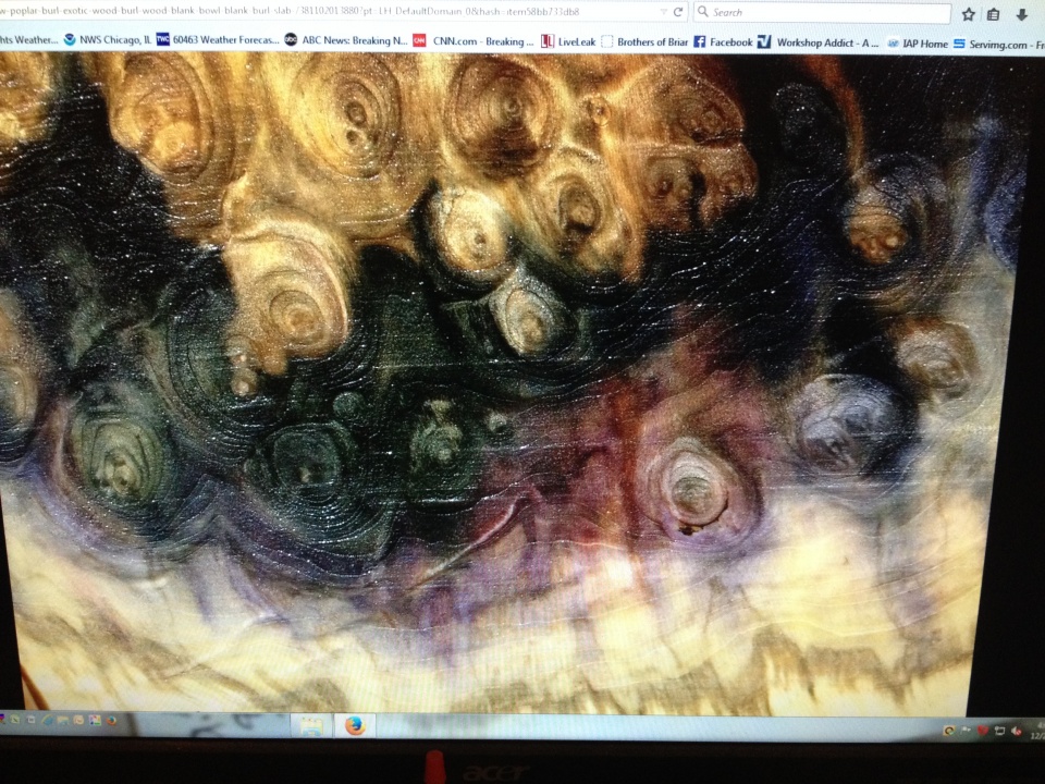

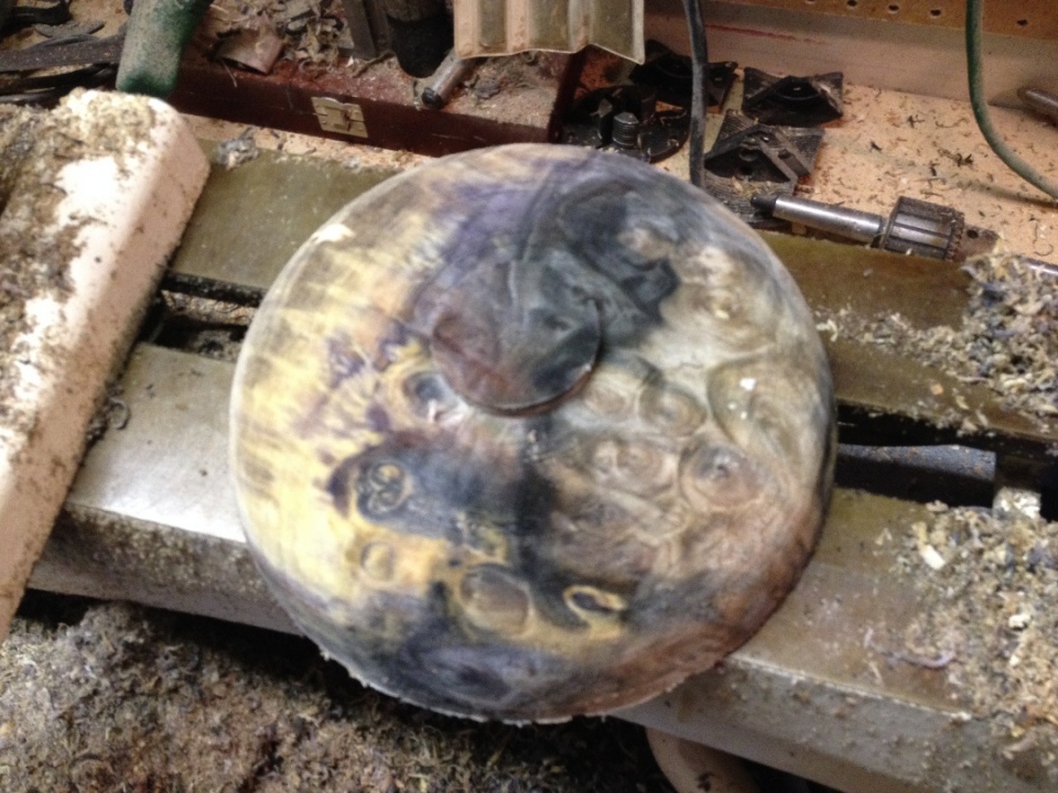

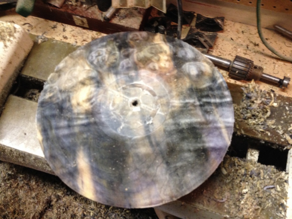

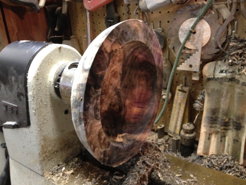

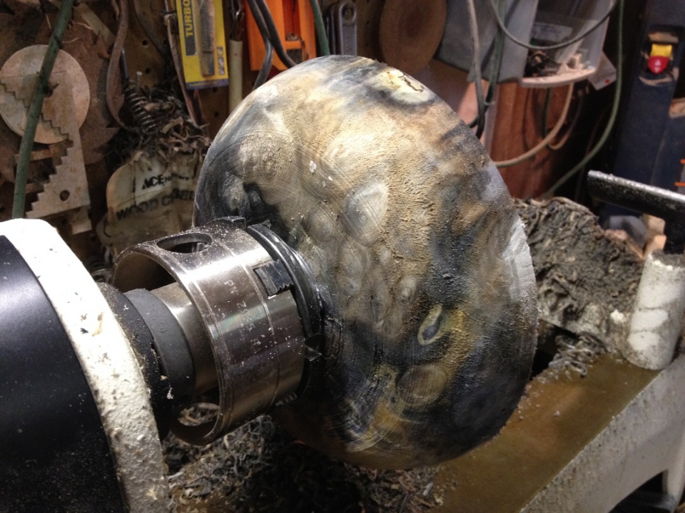

I got this piece on eBay a while back. Finally above zero around here so I decided to rough turn it today. I'm praying this doesn't crack while drying.
I don't know how you dry things in the land of ice and snow, but down here that sucker would already be buried in wood chips in a cardboard box, sealed, weighed and dated so I could check it every 30 days until it quits losing weight. I hope you wind up with a great bowl!
LOL, yup, she's in wood shavings in a paper bag at least.
That's a piece I would soak in my DNA bucket for a couple of days, then set aside to dry... I've had good luck with poplar drying...
Incredible piece of wood.... the last piece of "rainbow" poplar I found (at the local Woodcraft store and in pepper mill blank form) was almost totally black from laying in a swamp or somewhere... the wood stunk like puke and drew flies like crazy... but it did make some beautiful pepper mills....
Looking forward to seeing the finished bowl.
I made a decent sized bowl when I first started turning out of rainbow poplar. Nothing cracked and I had a little thinner wall left on it for drying that you prepped yours for. Mine had similar colors, too. Beautiful when just polished when done. Need to buy some more.
At the price of DNA around here (especially to fill a bucket), the DNA would cost more than the blank cost me. I'll give the paper bag and shavings a go.
That's one of the main reasons I like to turn to finish on my bowls :smile:
My DNA bucket is more than a year old... it's a 5 gallon bucket with a lid that I got at Lowe's and has about 3 gallons of DNA... I bought them over a couple of months from revenue from one of my shows... don't think I paid more than $15 per gallon.
But most of the time, I do like alankulwicki.... I turn to finish and if they warp, so be it... haven't had many crack that way... if they still feel really wet after I reach final sizes, I may run them through the microwave... I have one in the shop that I picked up at local habitat store for about $20... it's an old one that will hold about a 13 inch bowl.
Awesome looking wood, I will have to revisit E-Bay.
So this a new one for me, do you just dunk the wood in the DNA and how long do you leave it in there?
