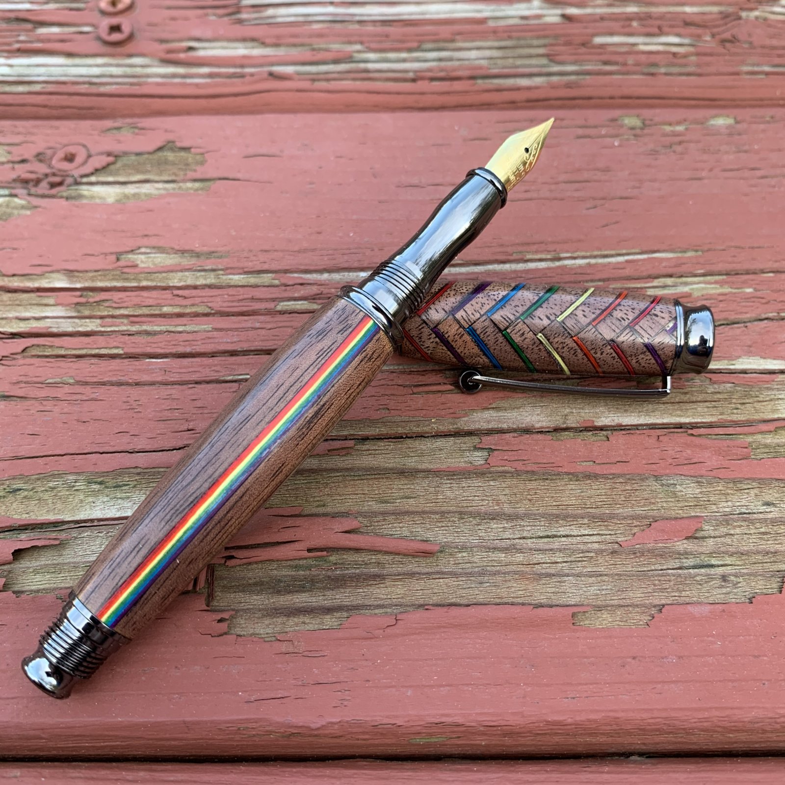

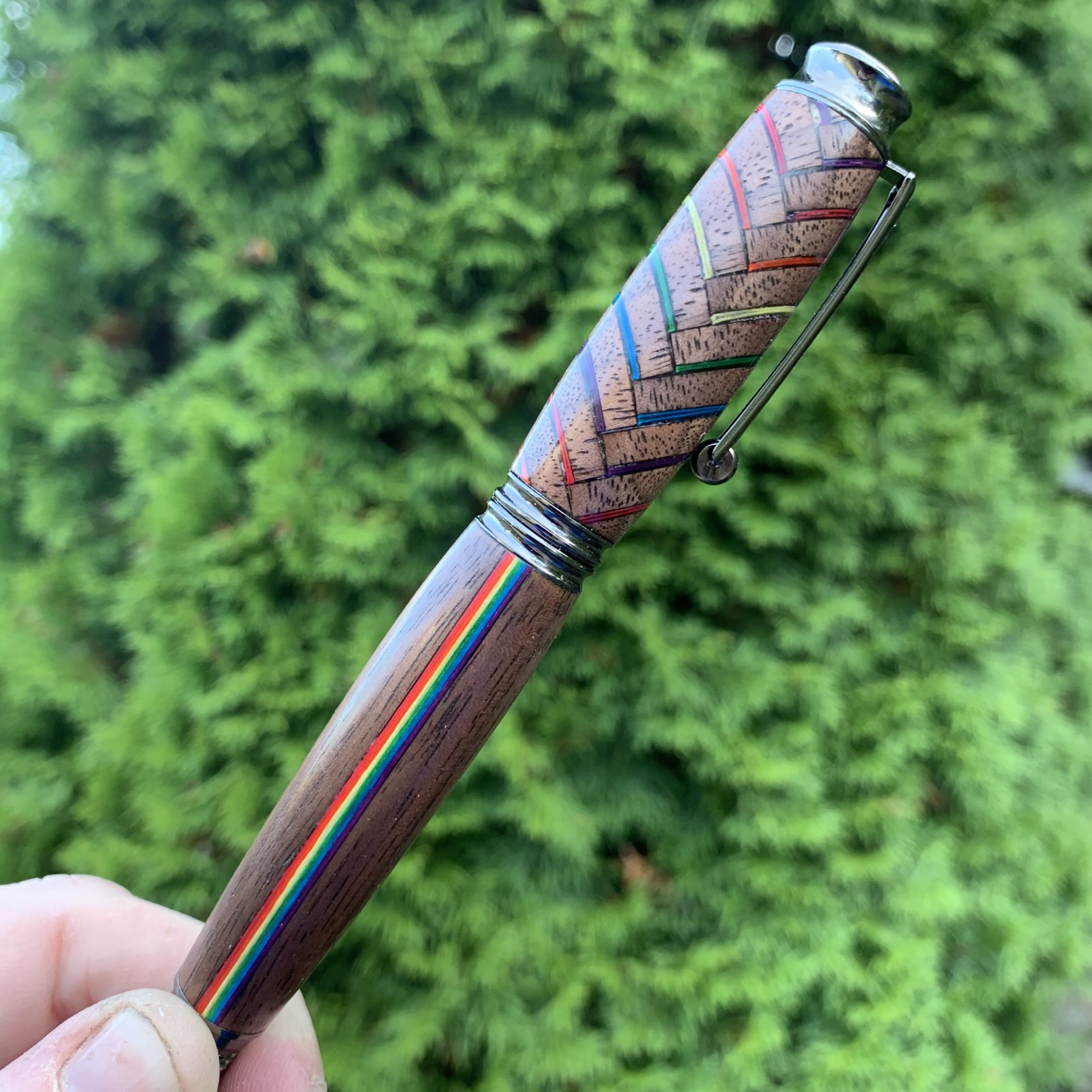

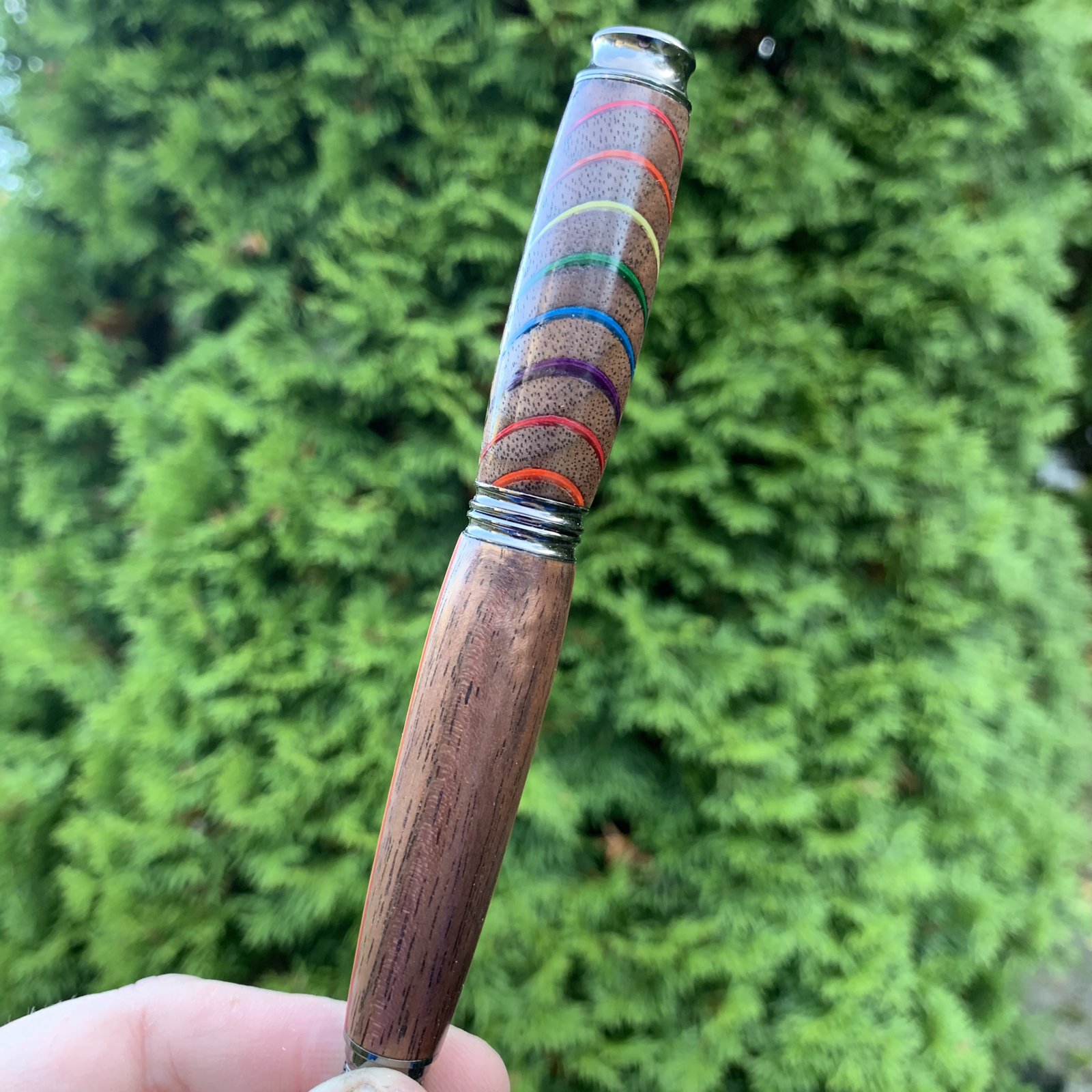

This is my first attempt at a rainbow herringbone. Not really happy with the results. At a quick glass it is cool, but upon any inspection you can see the many flaws in the herringbone. C&C always appreciated.

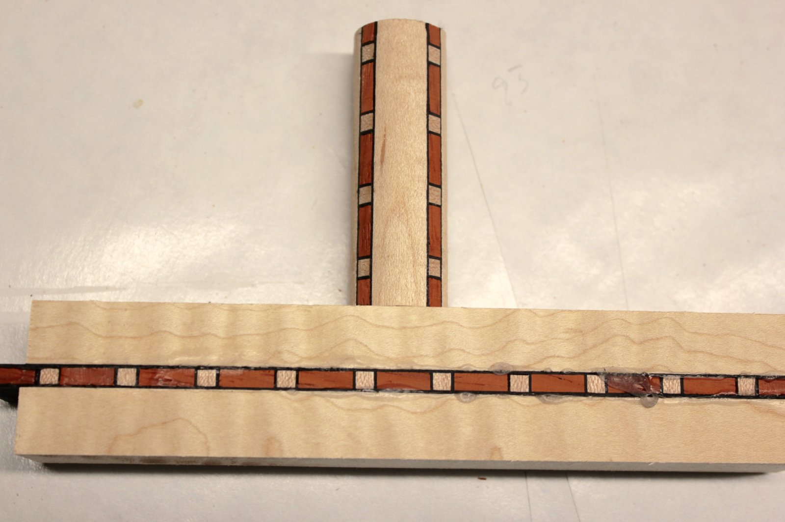

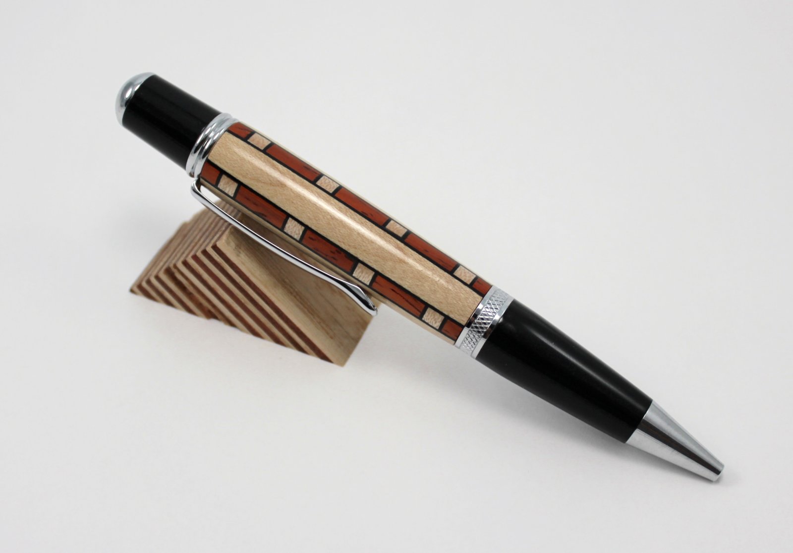

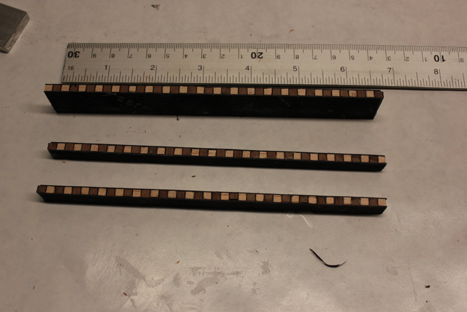

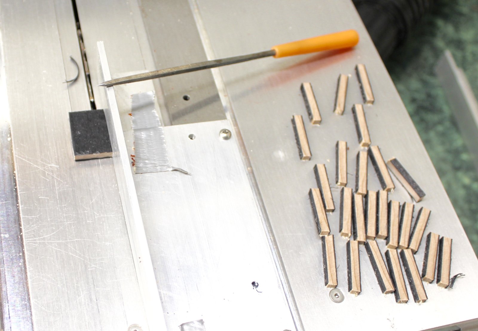

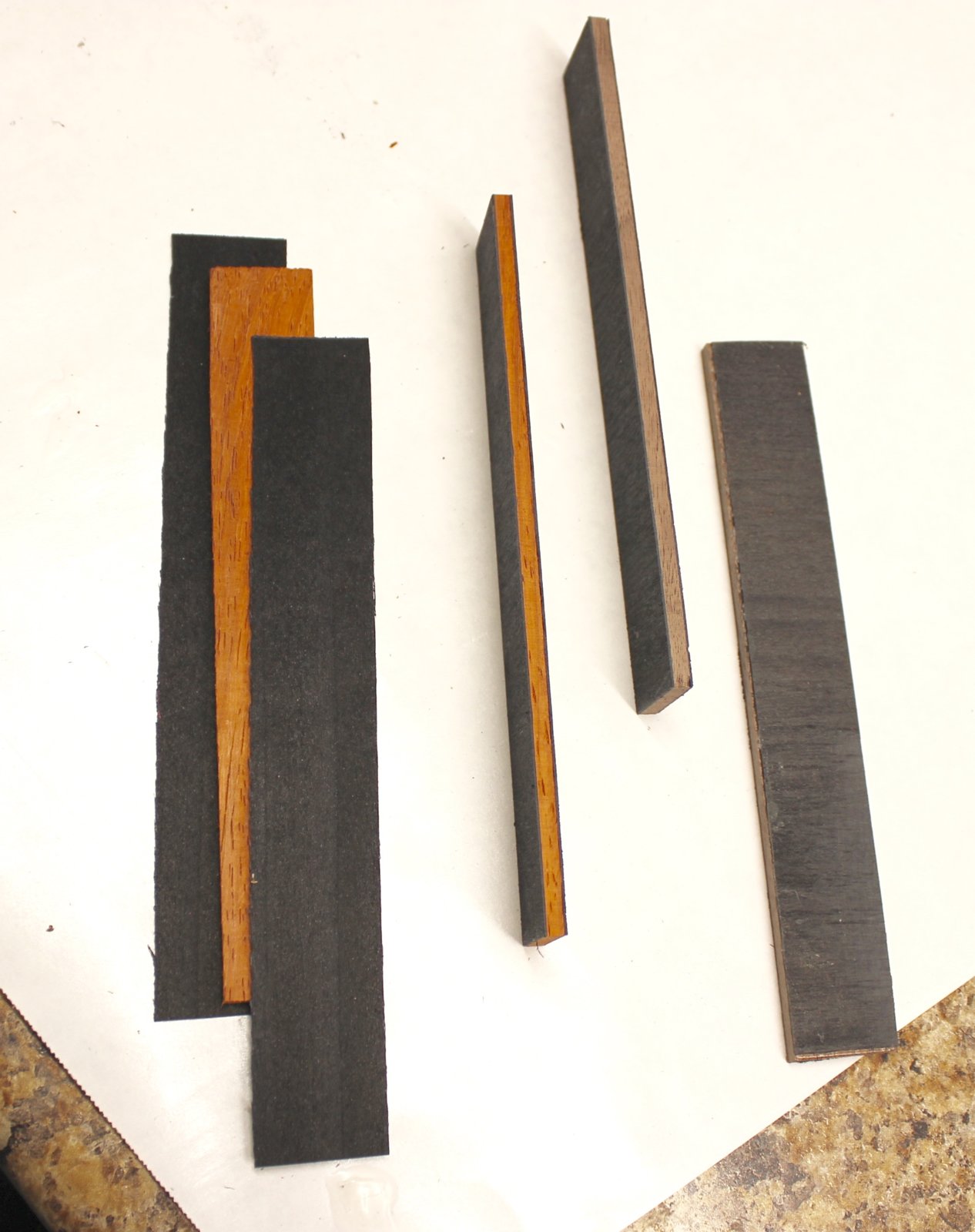

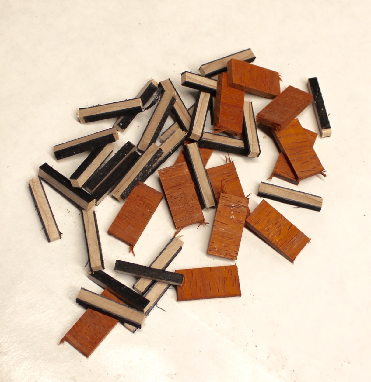

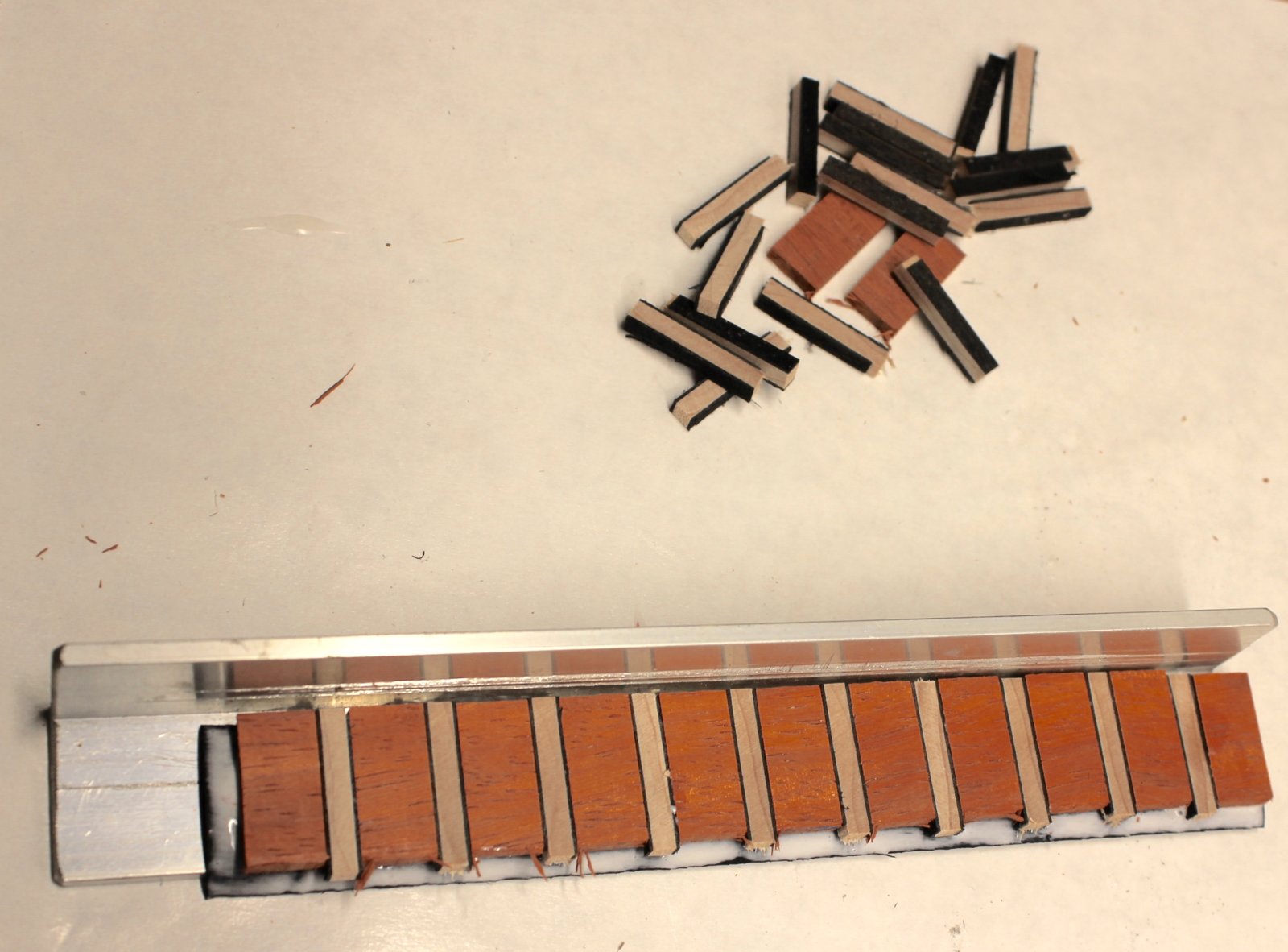

Just a thought for you to consider. You can get the colored veneers to totally surround the segments if you desire. My dimensions are not the same, but I think you'll understand the process. Basically you glue-up one side, or both with the colored veneer. The you cut the segments and glue-up the other sides. I then alternated the segments, one with the veneers, on without. You would need to play with the color combinations and the sides that are needing the veneers, but it's very doable.

I think it looks pretty good. I have made a few herringbone designs but to be honest, I didn't enjoy the process. I think it is very true that we are our own worse critic. That's how we get better though.

Angela, I like that rainbow herringbone idea. . Thanks for posting your resulting pen !!!
What is the main wood in that pen, please ?
I think what you have done is more difficult to do that it would seem at first. . I can't really elaborate what I mean.
The lower barrel is perfect. . The cap (with the herringbone) seems discontinuous, in a way, but that seems to be an intrinsic aspect of the design unless you take specific measures to overcome it. . I think it can be overcome, but it might be a bit tricky.
At first I thought that Mark (above) had the solution, but he might have chosen the wrong set of photographs to illustrate his point (which is not altogether clear to me). . But I think he probably knows what he is talking about because he has achieved some stunning results with that kind of very fine segmenting work. . I think we should press him to have another go at explaining .... :) ;) !!!
I think things would look better if there was continuity to the same color veneer on both sides of "the meeting point" if you know what I mean.
But exactly how you achieve that, I do not presently know.
One other thing relates to the grain structure of the main wood ... and that's why I asked you about what would you used.
I have the feeling that with a finer grained main wood the result would look better. . As it is, I think that the coarse grain detracts from the herringbone effect.
Overall, I think you have done an excellent job of cutting and gluing to achieve the herringbone effect, and I hope you will attempt and show some further refinements of this idea.
Thanks for showing, and I really would like to know what wood you used, please.

Unfortunately, the blanks that is used came unlabeled from one of the boxes that Mark is selling for IAP. So, ¯\_(ツ)_/¯.
As for the herringbone I kept going back and forth on whether the colors should touch in the middle. I might try touching next time.

I'll speculate Walnut.
Thanks, Angela and Mark, for the wood "identification".
Some walnut can have fairly open grain with "pores" so we will go with that as a likely choice for the "main" wood.
Angela, am looking forward to seeing your next attempt. . I am quite amazed that you have advanced in your pen-making so rapidly.
I have not attempted a herringbone yet, and I have been doing pens for 9 years. . Your work is an inspiration, and I might try one soon.

Thanks. You should try the herringbone it is challenging, but kinda fun.
