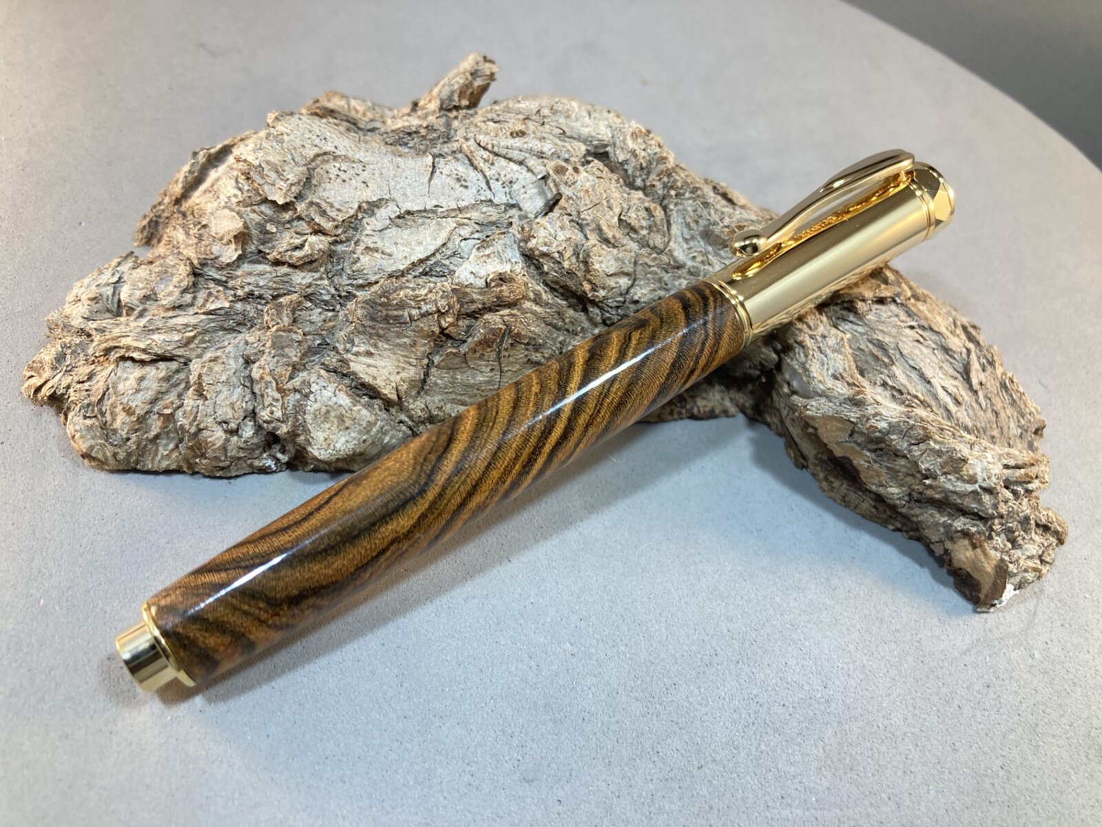

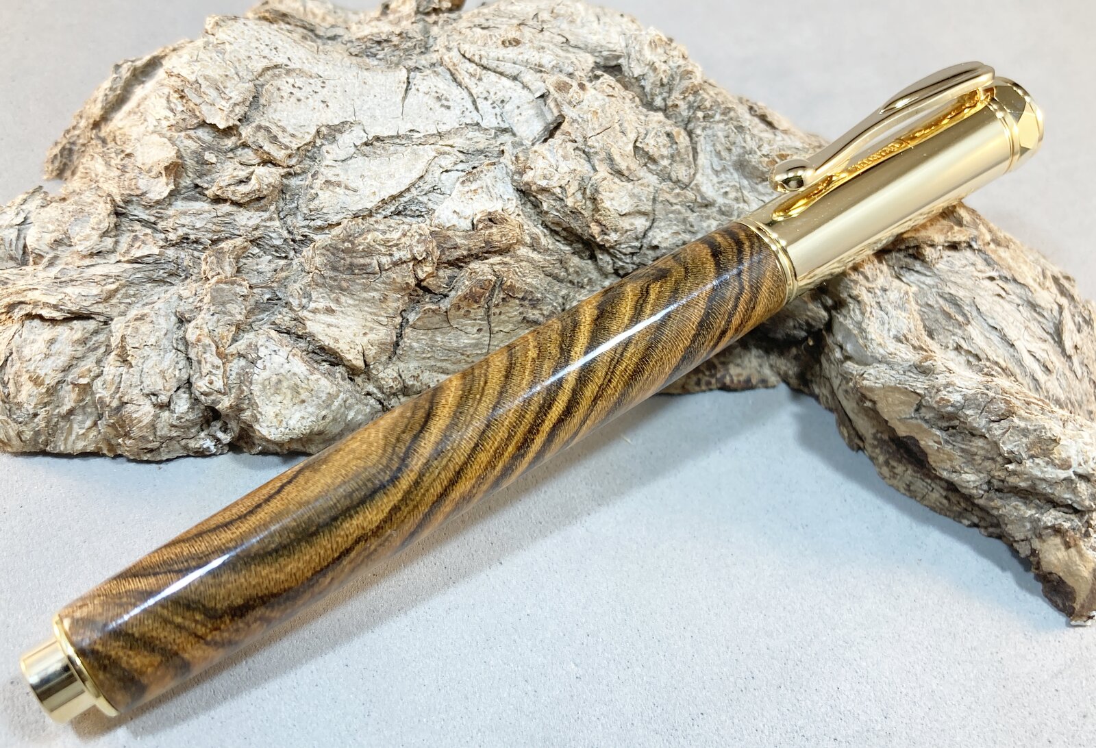

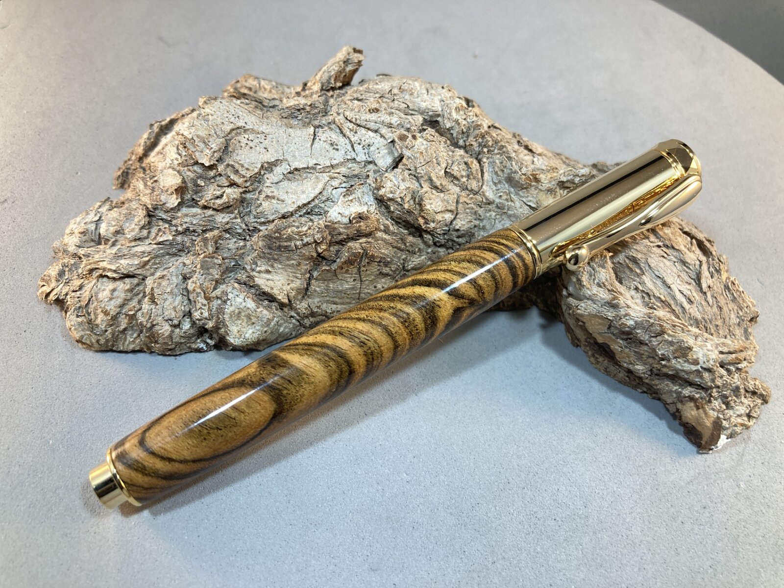

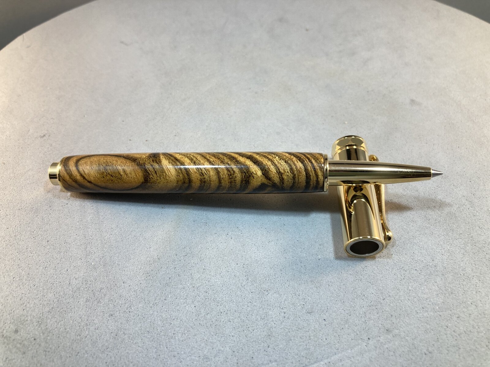

I'm pretty happy with how this pen turned out, but I'm not as pleased with how I got here.

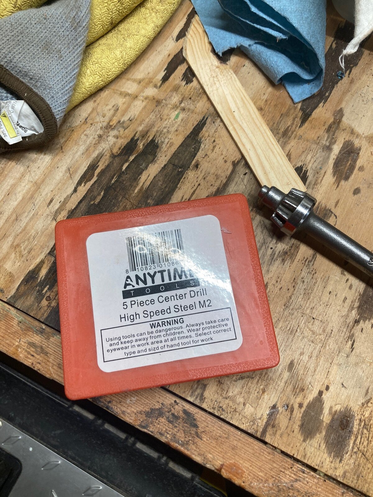

This radial Grain Bocote is beautiful, but's a terror to drill into. I ruined 3 blanks trying to drill a straight hole. The bit wants to follow the grain, and I end up with several angled blanks. With this blank I was fortunate to have enough "meat" on the thin side to turn it round.
I used regular drill bits, not brad point. My bits are sharp. I even tried using a center bit to start the hole, and that did not help.
I will probably stay away from this kind of blank in the future.
Any comments, advice or critiques are welcome.
I use those short machinists drill bits to start. I then switch to a regular drill bit. It has happened to me too when I just use the drill bit. Beautiful pen!

Not withstanding your issues, the final pen is beautiful. I love Bocote grain, and crosscut holds a special appreciation. Well done!
As much as drilling was a pain, it came out beautifully! I love how it came out with that grain orientation.
To be fair, that's a long blank, though. A shorter barrel and a stubby bit would probably play nicer for you.
I agree completely with Todd (sorcerertd) about the stubby bit as it is more rigid. Rigidity is one of the keys in trying to keep a drill from wandering when drilling into the end grain of a wood blank. For problematic woods instead of using my Jacob's Chuck in the tailstock for holding the drill bit (standard twist, 135 degree point angle), I opt for mounting the bit in my Collet Chuck.
For especially problematic materials, I like to drill an initial hole using a Screw Machine Drill Bit (Stubby Bit) as deep as I can go to make a guide hole and then finish drilling a Jobber Bit. (Again, this goes to rigidity). Of course, I also make a starter hole with the shortest bit there is, a Center Drill Bit. I usually drill at 500 RPM to 750 RPM for typical pen diameter drill bits.

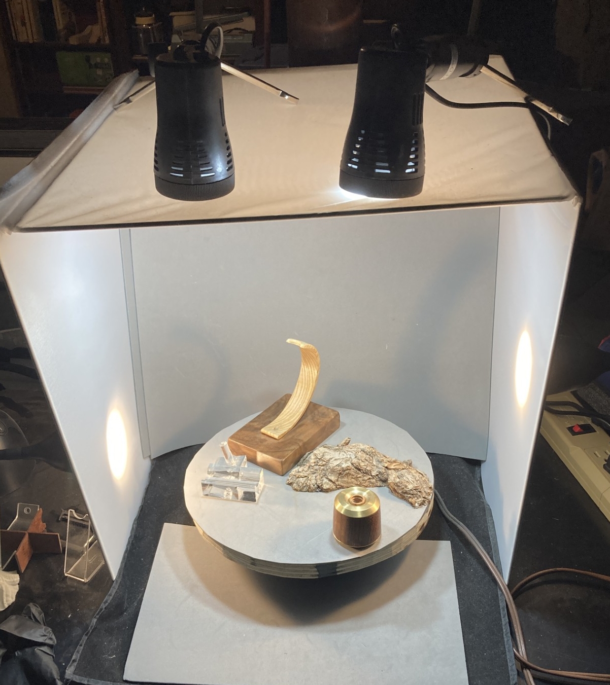

The pen looks great. but I have to say your photos are some of the very best shown on this site. Would it be possible to give a little insight as to your method? maybe show us your setup and tell us what you have found to be the key to such successful picture taking. Thanks in advance.

Thanks for the kind words, John, but I don't really have what I consider to be a benchmark process. I'll explain.
I use a basic, normal photo booth like you can get on Amazon. I have 2 lights facing down to provide overhead light. I also have 2 dimmer LED lights, one on each side to try to provide more light. See pic below.

I do use light gray foam sheets for my background, as grey is supposed to be neutral. I have received feedback that some folks with varying degrees of color blindness can't easily make out things in my photos. I'm not sure what I can do for that.
Anyway, I use my iPhone SE (so it's not even a fancy phone camera).
I think what makes or breaks it for my photos is the editing, not the actual photography. I think any photographer could relate to this.

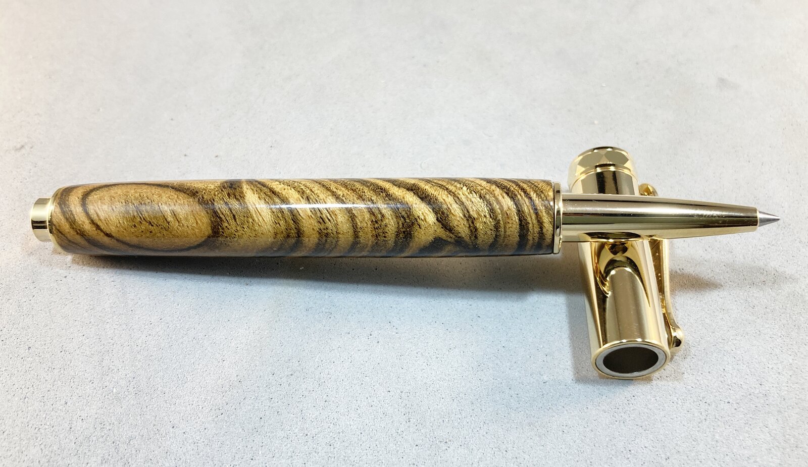

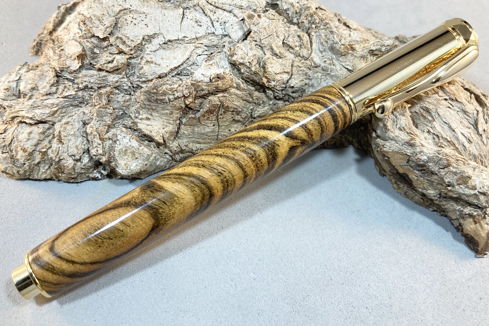

Below, I have the original pics for this Bocote Pen on the left, and then the edited photos on the right. You will see that the edited photos all look much better than the originals.
Obviously, one main edit I do is cropping, to remove things that are not the pen.
I then look at the brightness, or darkness, and increase or decrease as needed. There is also a parameter called Deepen, which sometimes brings out more of the color in the pen. I don't use it all the time, but sometimes it helps.
I DO NOT edit the pen beyond reality. I don't augment the color, or sharpen the image, or any of that. I just try to make the photo look like the pen. You don't want a customer to buy a pen only to find out the actual pen looks nothing like the photos.
I use a photo editing software called PhotoScape. I have had it for at least 15 years. There are many photo editing tools out there.
Anyway, my process is nothing special. I do appreciate the comments though, because I do fuss with the photos until I like what I see, and I am glad others can appreciate the photos too. :)

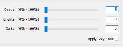

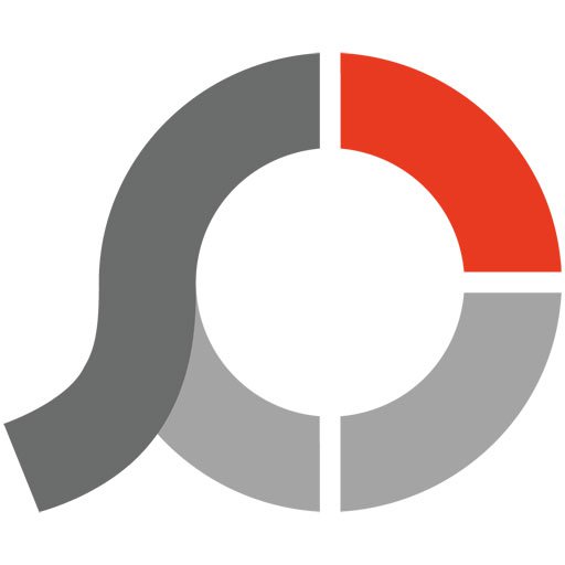

Not to change this thread to be about photography, but I love this program and use it frequently. I prefer the older 3.7 free version over the new one. PhotoScape is great to combine, resize, and do quick touch up work (like clone stamping fuzz out of the background) though it is capable of much more than that. It's also great for batch processing.
Here's a link for anyone who wants to try it and a snip of the opening screen. There's no spyware, no ads, and no nag screens to purchase or upgrade. Not bad for free!
For what it's worth, the Microsoft "photos" viewer that's built into Windows has become a pretty nice basic editor, too. Most of my pictures only get cropped and brightened there. I see we are on the same page about not wanting to overprocess the pictures.
