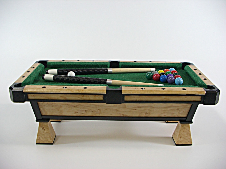

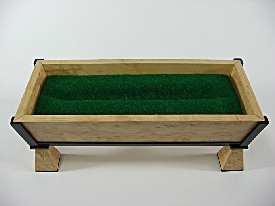

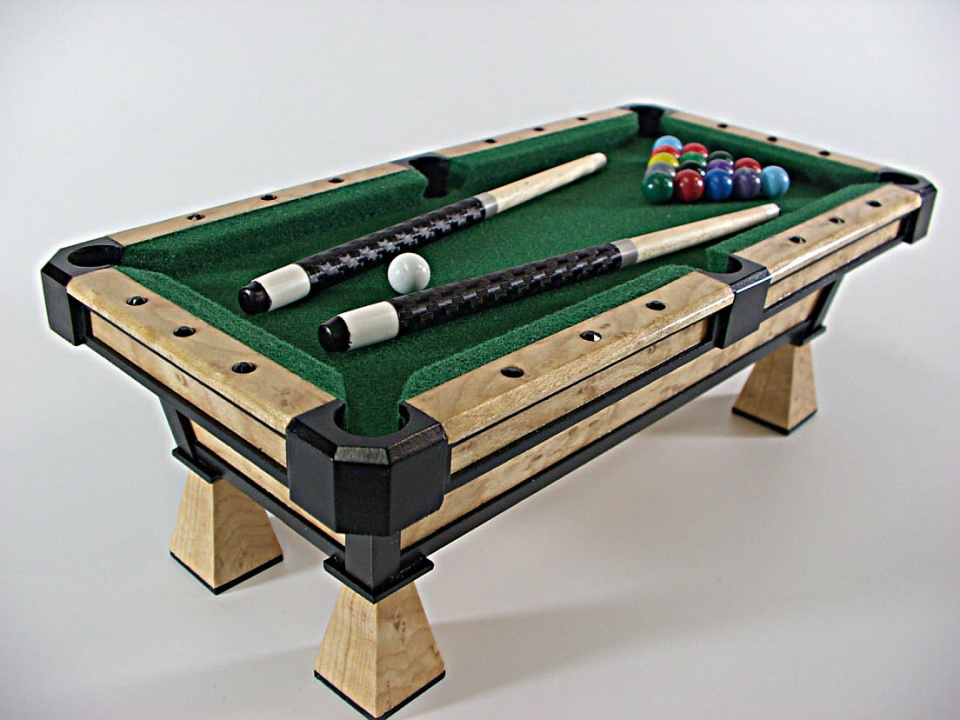

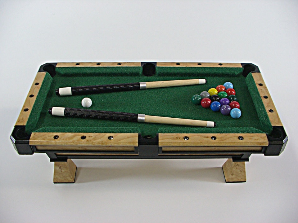

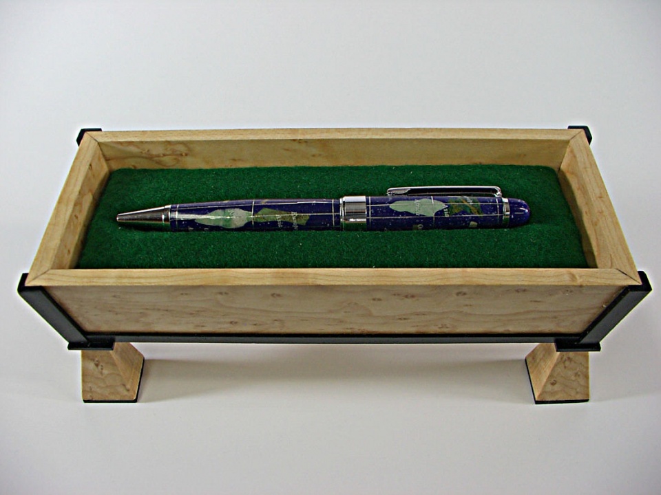

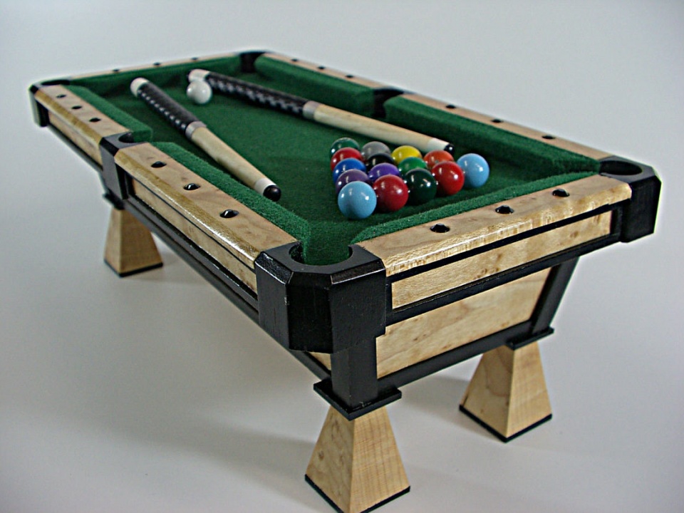

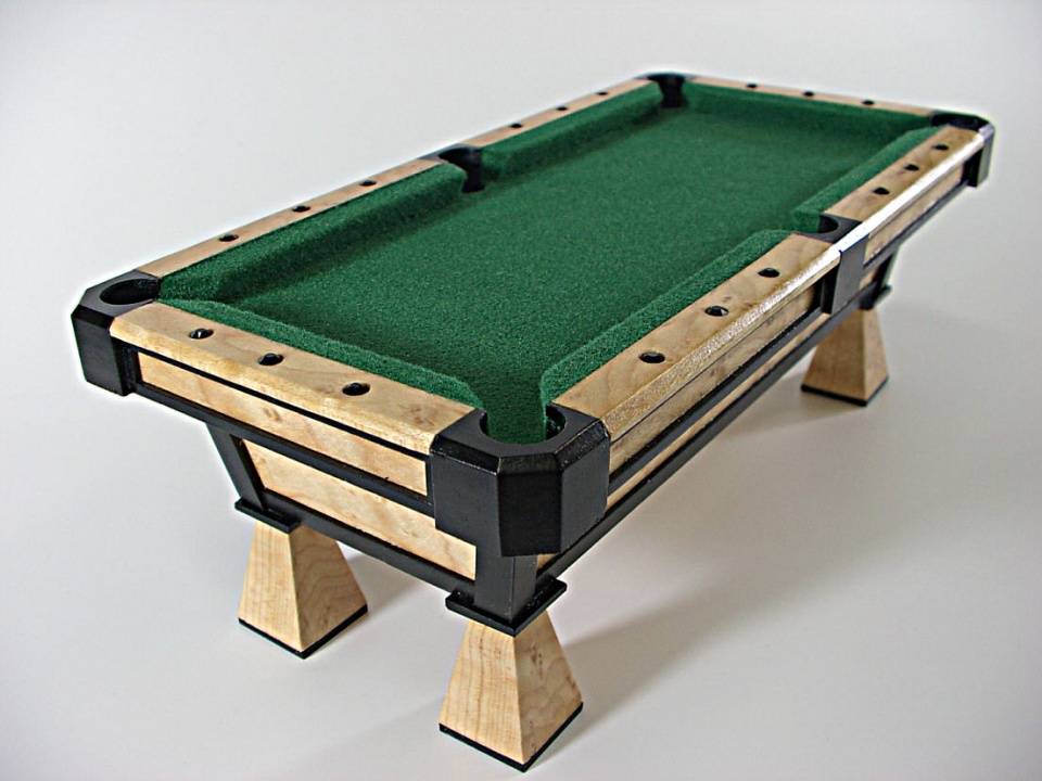

Anyone for a cool game of billiards. Now the contests are over I would like to show off my 2017 Pen Box entry. This too happened to take first place. I had this idea in my head for over a year but was just not able to make it till I was able to return to my shop. I have to say I am sort of strutting my feathers on this one because it came out almost as nice as I envisioned it. I will say I had to make many jigs to pull this off because every detail needed a cut that is not normal. Doing all the compound angle cuts was challenging. Drilling the holes for the pockets needed a jig as well as cutting the rails and trim work. The rails and pockets are joined with mortise and tenon joints because end grain is not a very strong glue joint. I did have an oops when I tried flocking the table and rails. The paint/glue I used was too thick and the fibers did not stick well. I had another can of the stuff so I was able to sand back the old and add the new and it came out well. Was able to get it done in time too. Thanks for looking and any questions or comments are always welcomed. Hopefully I can get the pen I have designed for the box done, very soon.
My replica pool table box is made from Birdseye Maple and Gabon Ebony. It's measurements are 4-1/2" X 9" which is a scaled down version of a professional table. It was dipped in BLO and then top coated with 6 coats of satin lacquer. The table top has green flocking on the table as well as the bumpers.
The cues were turned from maple blanks and are also satin lacquered. The butt grips are wrapped with carbon fiber. The billiard balls are miniature replicas. The rail sites are round black Swarovski crystals.
All the materials used were cut and angled using various jigs. The table is an easy lift off to access the pen box compartment which has a green plush felt cushion for any size pen. The lid has guide blocks to properly seat it easily on the box.
This is a neat little box which will enhance that special pen for that special billiard fan.

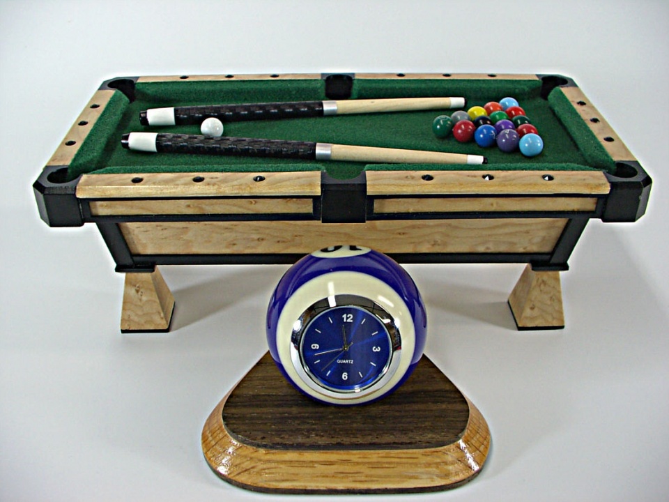

OK I could not add it to the group in the first post so here is the comparison photo to a standard 2-1/4" billiard ball that I make clocks from. Hope this gives the perspective of the box.
Very well done, you have almost every detail on the table/box, where is the chalk?
Funny my brother asked that too. I almost did. Today they do not do that much any more. Everyone carries their own personal chalk holders. I was going to put the balls in a rack but chose not too. I actually first thought of making the top to swing open with hinges but was afraid of too much weight. Then I was going to make a drawer in the table for the pen because many tables today have draws to keep cues and things in but again too much weight and it would tip over. So I went with lift off top and glad I did.
