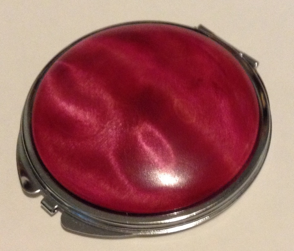

Use a coat of amber dye, then resand. The dye will stay in the wavy figure since it will really soak in, but it will be sanded off the hard grain. You might also try using an alcohol based dye, then wash it back with just straight alcohol. It will wash the dye off the hard grain, but it will still be soaked into the wild grain. This compact was dyed and washed back with alcohol.
