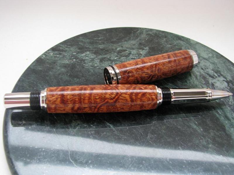

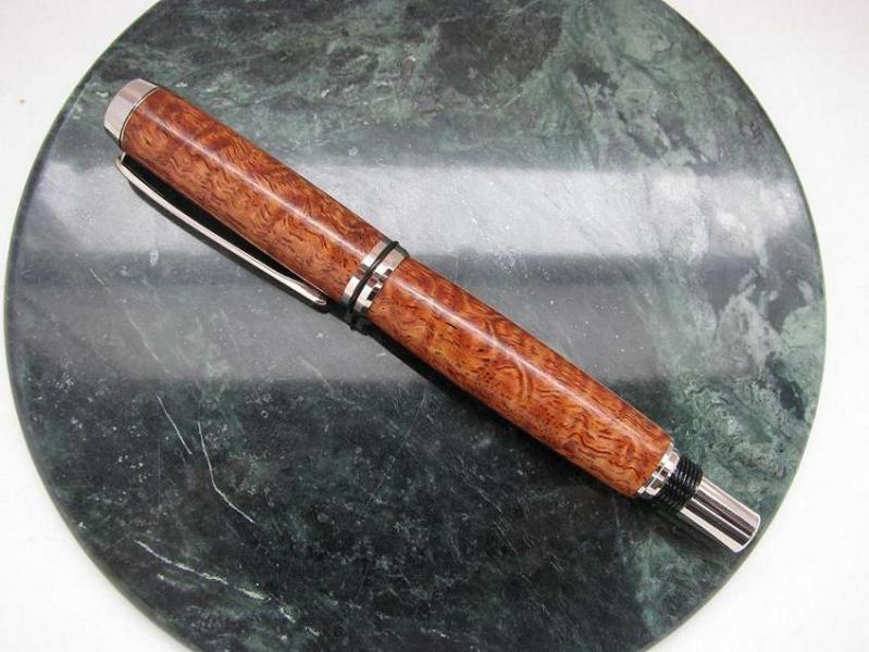

Made this one this morning. This is the 4th pen I've used CA as my finish and I think I'm starting to get the hang of it! :)

Thanks guys, it was a blast to make....still gotta work out some kinks to the CA finish as I would like it to be much more glossy...but hey, it's a start. Thanks again for all the kind words!!
