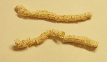

Since I have no local turners to ask, I'll ask here.
Do these shavings look like what I should be getting using a skew? They are very thin and just roll off the wood. They look like they came out of a fine tuned hand plane. This is maple that I am using for one of the challenge pens. The PR I turned came off the blank looking like fine hair. I'm still trying to figure the skew out but I think I'm on the right track.

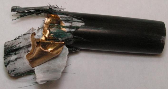

Here is what you DO NOT want!! BE carefull always. I had this experience the other night when I got distracted for a split second. :beat-up: I forgot to mention, you are looking good as to your original question.

What you are getting is a good start!!!
From the appearance, I would suggest moving the skew more rapidly from side to side and taking a finer cut. It appears you are cutting a little too deep, causing you to get your ribbons too tight.
If you have to have a problem, this is a GOOD one--don't change the angle you are using to approach the cut, IT looks great.
Thanks. I know it feels right. When I've used a skew in the past it never seemed to do what I wanted it to do. This time I made sure it was real sharp and started light and tried to ride the bevel all the time. It's very easy to tell when I'm getting to aggressive as it starts to chatter and leave a rough surface.
