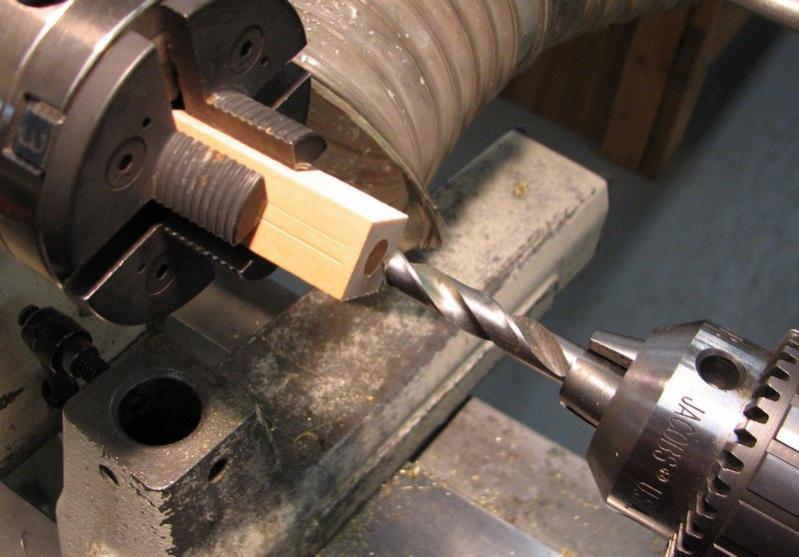

As far as the cap goes, I don't like gluing parts on a pen so I found a real slick solution. A #4 pan head sheet metal screw fits inside the cap PERFECTLY. I drilled the cap blank 3/4" deep with a letter "U" bit, it's a snug fit but that's good. I drilled a clearance hole in the cap for the screw and a pilot hole in the blank and then screwed it in by hand. I used 1/2" long screws because that's what I had but 3/8" should be long enough. It works like a charm and I don't have to worry about the cap coming off in a customers hand.:mad:

Here you go Cindy................
Drill a letter "U" hole.....................
Drill a 1/16" pilot hole for the screw..............................
Drill a 1/8" hole in the cap...........................
Put the screw in the cap..............................
Voila! I haven't tried turning one yet but I don't see any problem with putting a dead center inside the cap and turning. In fact it will cause the blank to be turned true to the cap which is what you want.:wink::biggrin:
