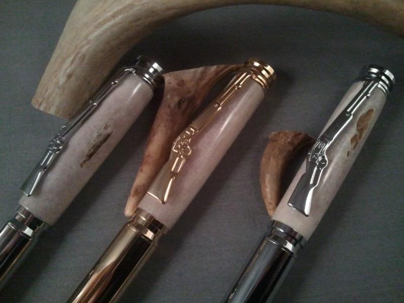

pics are not the greatest, but you get the idea.

I searched 6 pages back, and couldn't find an answer. I know I should turn slow, to avoid overheating, but I'm looking for a more specific number... what speed should I use? TIA
Thanks, guys! My GF has a bunch of antler that she cut the tips off of to make needles, so I get the rest. I'll be at WC in Orlando this week, so I might pick up a couple of bullet kits. Once I get about 10 miles out of town, the locals will eat 'em up.
