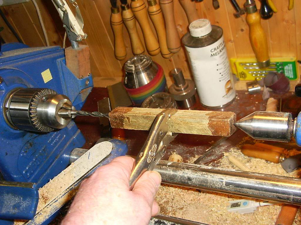

If you hold the drill bit in the metal chuck and the blank against a dead centre in the tailstock I think you should have ample room to drill by holding the blank with pliers and turning the tailstock to feed into the spinning drill bit.
Like this. You can make your own dead centre to fit if you don't have one but I'm sure Shearline or Taig does. You can also choke up a bit more on the bit. This one is a 3/8" and the blank is 2 3/4" long. Once you get almost through stop the lathe and take the dead centre out and slip a short bit of wood in its place if you need to drill through. Lots of ways to skin those cats. ;)

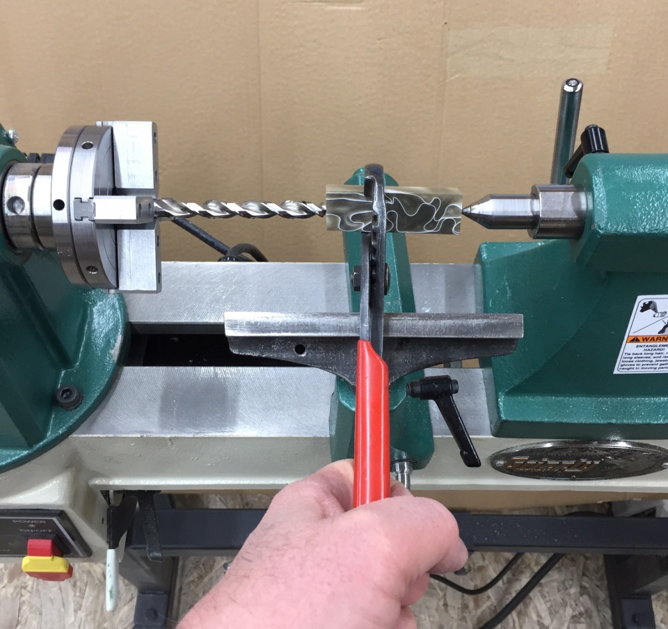

Do you mean something like this? Is that fairly accurate?
I believe you can drill the most blanks on this lathe, but it will take some playing within the parameters. First find a source of short drill bits, my local hardware store has them. You will drill first with a center bit, then stubby bit, then switch to the regular bit.
