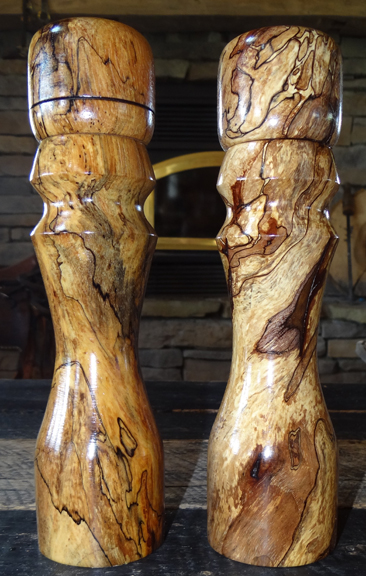

What do you guys use for finish on mills?
A generous bath of walnut oil (to really bring out the grain) and then gloss Craft Coat from Exotic Blanks (Exotic Blanks :: Tools, Glues & Finishing :: Finishing Supplies :: Craft Coat Finish - Pint Size Please Choose Type). I do 3 coats of Craft Coat (about 30 seconds between coats), wait 5 minutes, sand with 400 to smooth things out and then 3 additional coats of Craft Coat. The end result is a very durable and water resistant urethane based finish with a nice shine (but not an over the top shine).
Mike
kyaggie
Feb 1, 2013
295
Versailles, KY
Here is an example of this finish on some spalted pecan...
