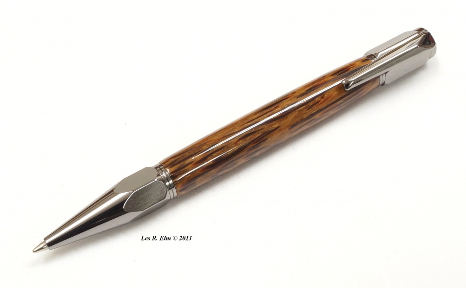

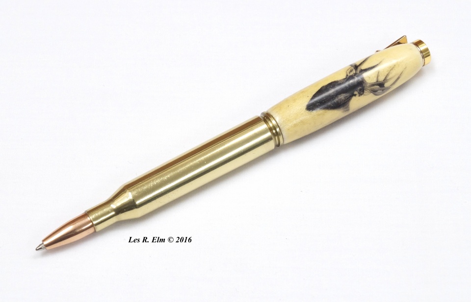

I use MINWAX WBOM Polyurethane using my Dipping Method to finish all my wood blanks and decal work on wood and antler.
Much easier to apply than any CA finish with no sanding or polishing and is just as durable as any CA finish.
Les
