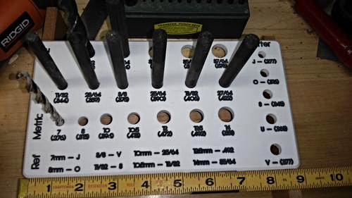

Way back in the day someone was making something similar to this and offering it for sale. I'm not really interested in starting a business with it, but I know people with CNC machines and I'm checking on how much it would cost to have this made out of PVC. Would there be any interest in this sort of thing?
I couldn't find the original thread, so if someone is still selling these let me know and I won't pursue it any further.

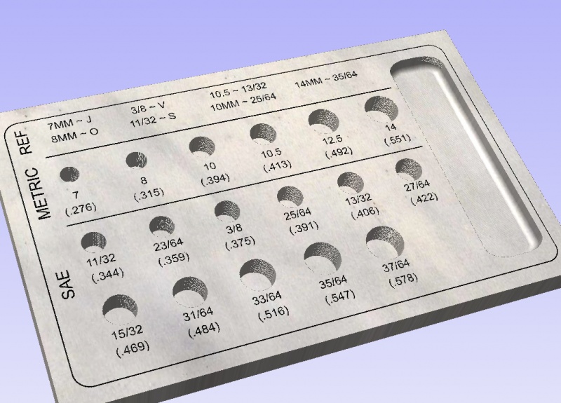

I understand what you were getting at. I work with all of these materials. HDPE wouldn't scuff as easily as PVC and the right type will hold up better than aluminum. One dent in soft aluminum and it's done. HDPE can be some seriously rugged stuff. Added benefit is the no stick. Not sure why you would need it, but it would be hard to glue anything to it.
I'll get started on a version of this.
What software do you work with? I can send you my Aspire file if you like. The only thing I'd ask is you send me one. I made each drill hole .03 larger than the specific drill bit size, so you will have to run a test file first.
Let me know.
I have plenty of software. I have VCarve Desktop. Aspire works well with VCarve Pro, but I've never tried to use Aspire files with Desktop. I've also got a couple versions of CAD software and more.
I've got a few material options on the way. .25" HDPE in Black, .177" ABS white, .5" UHMW white.
I'm betting on the UHMW being the winner here and I've got some other ideas in mind for the ABS. The UHMW is about 15 times more abrasive resistant than carbon steel, and a lower friction coefficient than nylon and Delrin, so the recesses should hold up over time to constant insertion and removal of bits/tubes. (This would also make a great sizing guide for figuring out what size a random tube is)
I'd be more than happy to send you one as I prototype it out for the work you've got in it. If all goes according to plan, I'm anticipating a final price to be around $20 for IAP memebers.

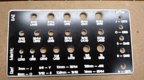

I made one for myself a while back using Aspire to model and toolpath it . I used .250" thick CandleStone , its a solid surface material used mostly for Lithophanes . I cut all the holes .005" oversize , that seemed to me to work well for ease of slipping the bits in and out . It does come in very handy for storing and retrieving my pen bits .
Great Job! What did you colorfill the engraving with? Paint? Rubnbuff?
Thanks .
I used black spray paint , after v-carving the letters and numbers , then just sanded the over spray off . I did do another where I just sprayed the whole top black and v- carved the numbers and letters as the base material is white , it shows up good as you can see in the picture but I wasn't sure how the painted surface would hold up so I ended up making the white with black lettering .

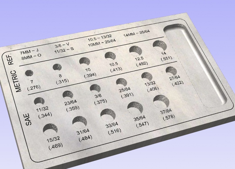

I drew one up real quick and did some figures.
I can make them from 1/2" Corian for $15 each plus shipping. So, it would be just slightly more than you want for a thinner material without shipping.
I could probably do them for less, if I ran a large batch of them.
The configuration could also be altered to any design.
