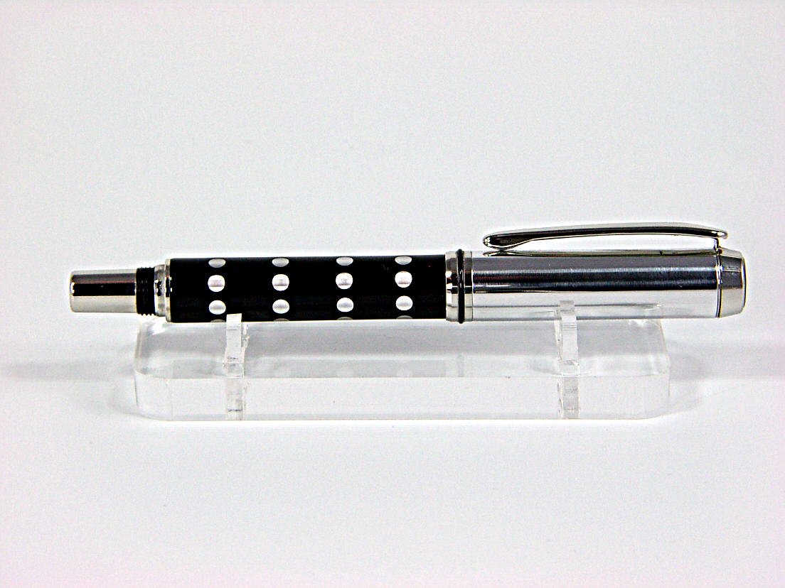

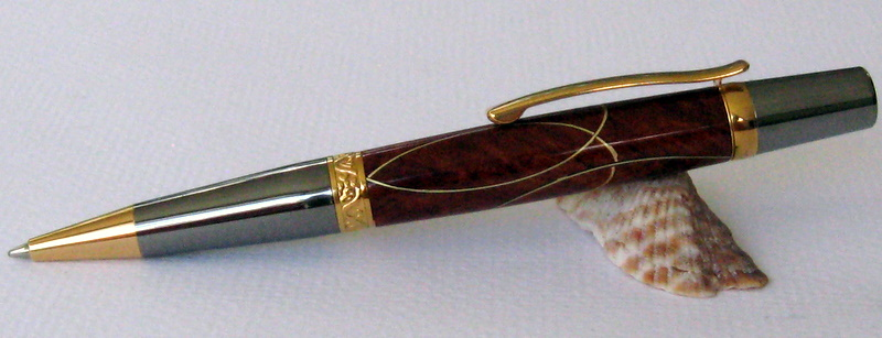

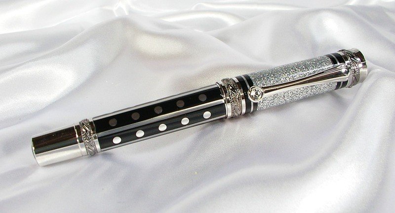

As far as thickness of materials such as aluminum used is no rule so use whatever you want. I showed in another thread recently here a pen I made the blank from all aluminum. Here are a couple segmented pens I made using various thickness aluminum. They turned very easily. As far as keeping color, You can top coat with CA if you are worried about that. Aluminum does not change color so I do not top coat it. It can be polished.
