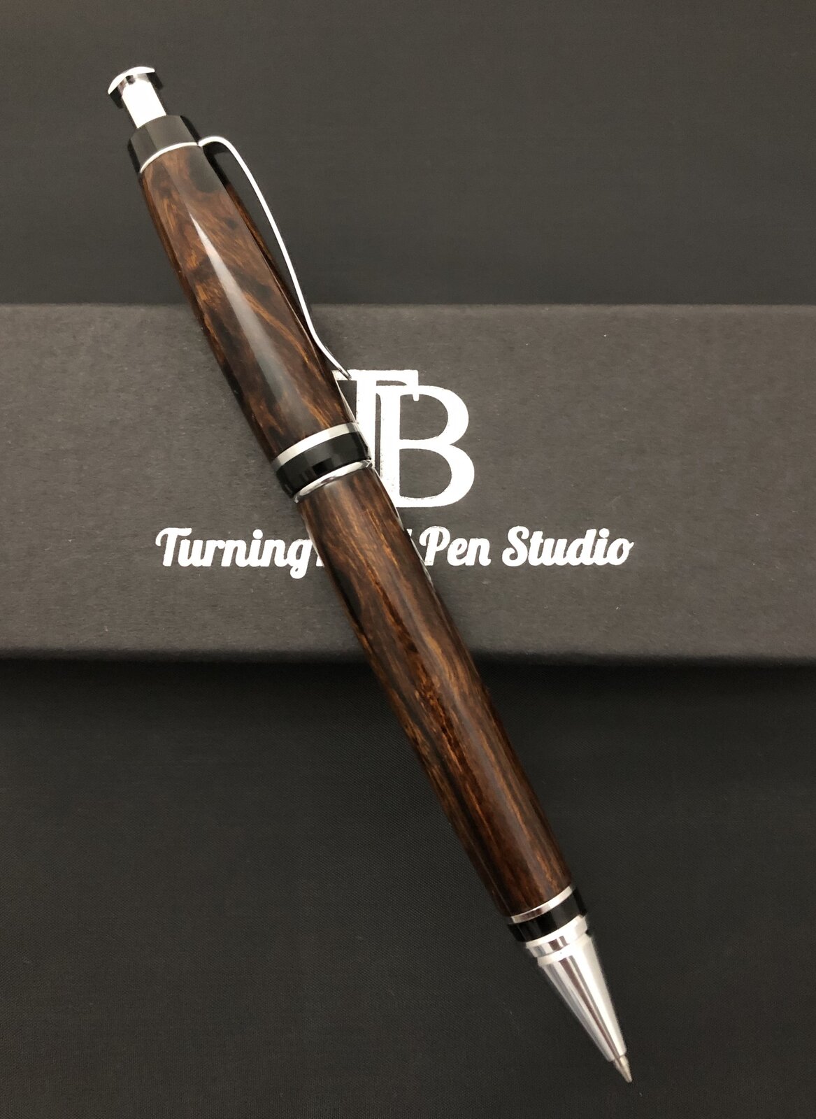

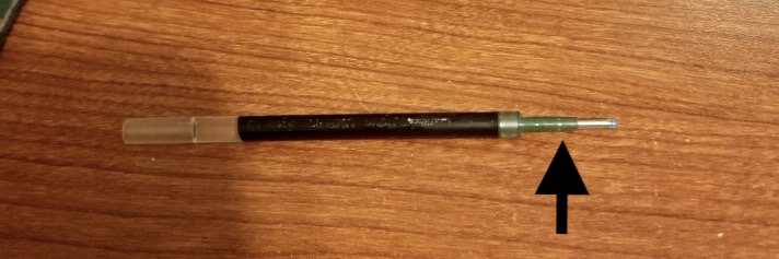

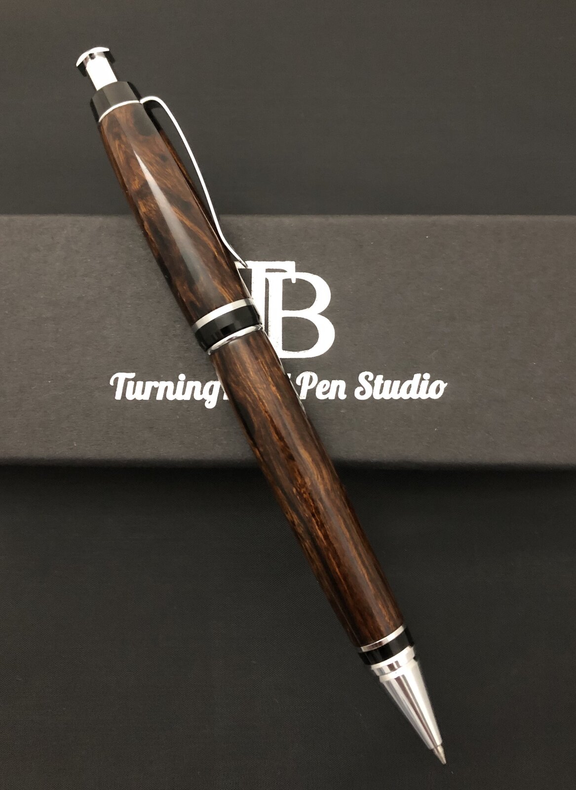

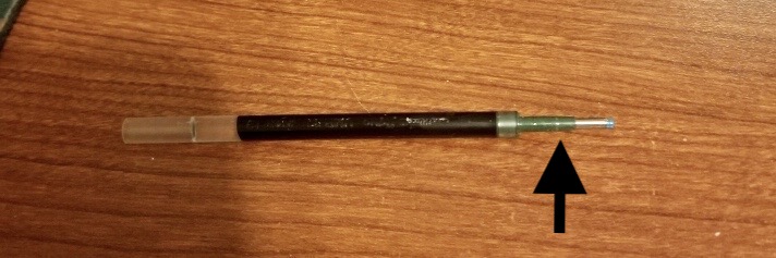

Update - Success! RB-U-344-0620 1.jpeg Customer wanted a retractible rollerball. I ended up using the click cigar. The Uni-ball refill is .505" longer than the Parker refill. So I made the barrel section 1/2" longer and finished the pen. The refill would successfully extend through the nib but I had trouble retracting. I modified several ball point springs all to no avail. The shoulder IMG_1719.jpeg on the refill kept the spring from working properly. Online I found a ballpoint spring with internal diameter to fit over the shoulder - ordered it Saturday and it arrived Monday from California to PA - outstanding service! Put the new spring on and the pen works perfectly!
I think next time I will add 1/4" to both barrel and cap sections to prevent the long look of the barrel.
