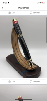

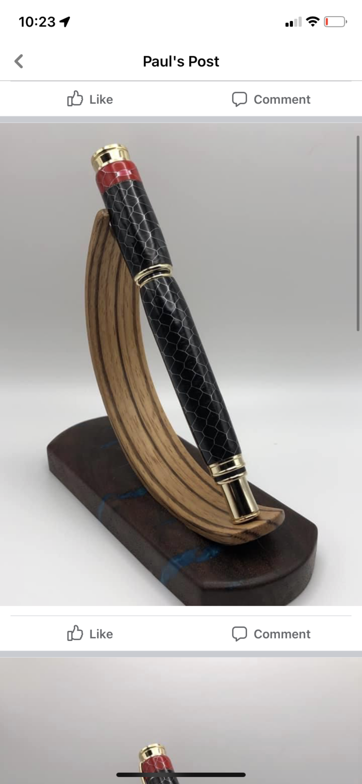

I want to start making pen stands for offer alongside my pens. I am aiming for something like the picture below. I'm assuming this requires wood bending to accomplish. From what I've seen this can be done by making a steam box but was curious if anyone else does this and if there is an alternative way to do it? If the piece was thin enough could running clothes iron over it on a steam setting work (covered with something like a sheet)?

No and maybe. Maybe some people can make with bending but doubt it. They are usually cut from flat boards as you see the width is about 3/4" I cut them on a scrollsaw but a bandsaw works well too. Draw yourself a pattern and cut it out making up your own designs.

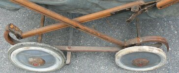

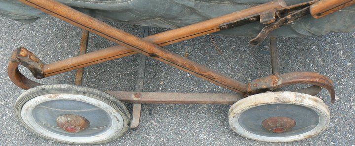

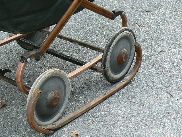

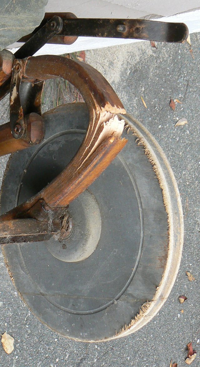

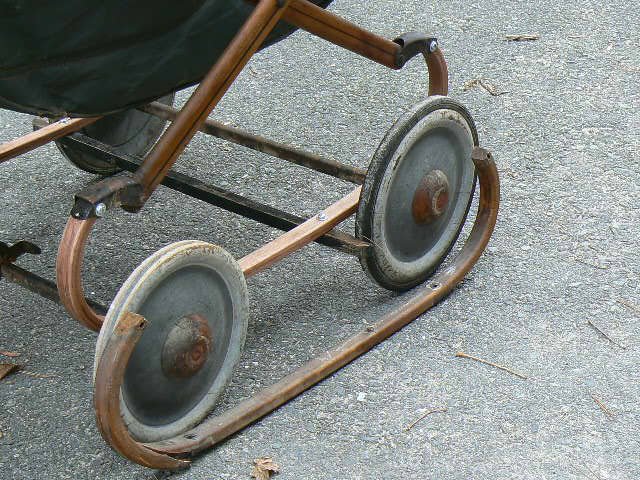

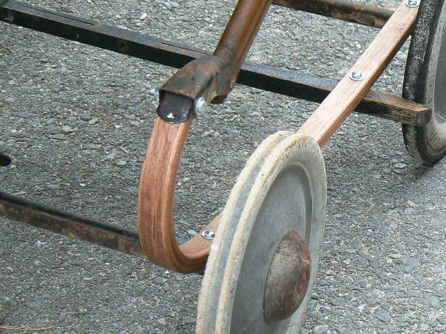

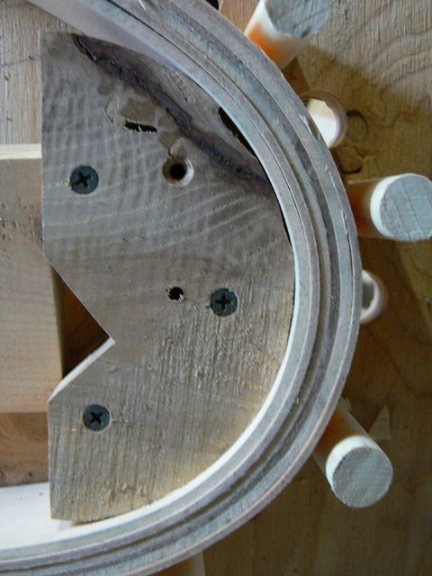

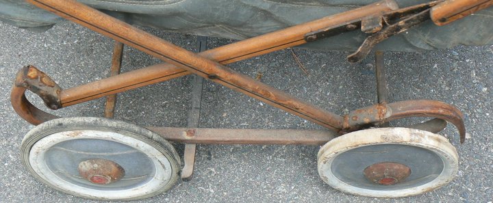

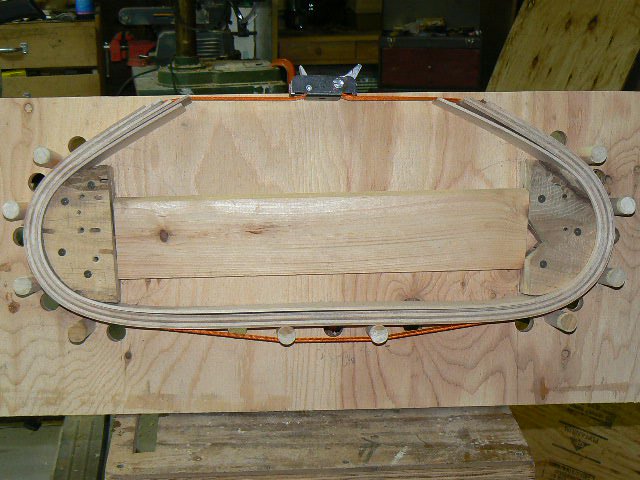

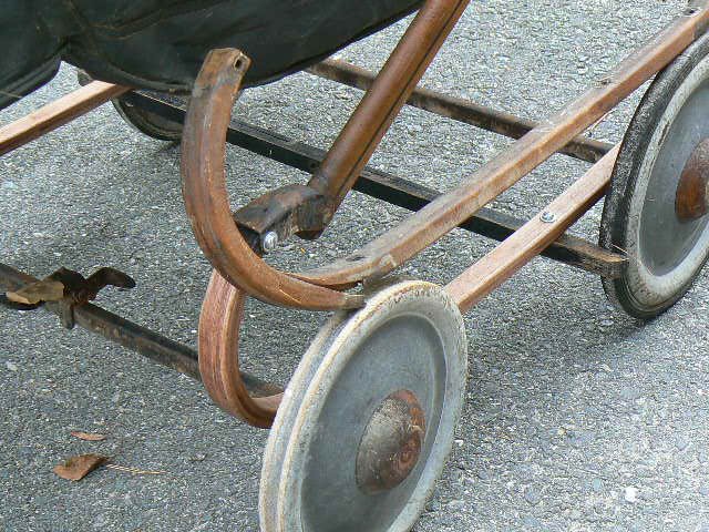

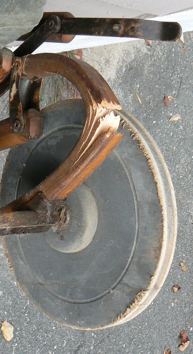

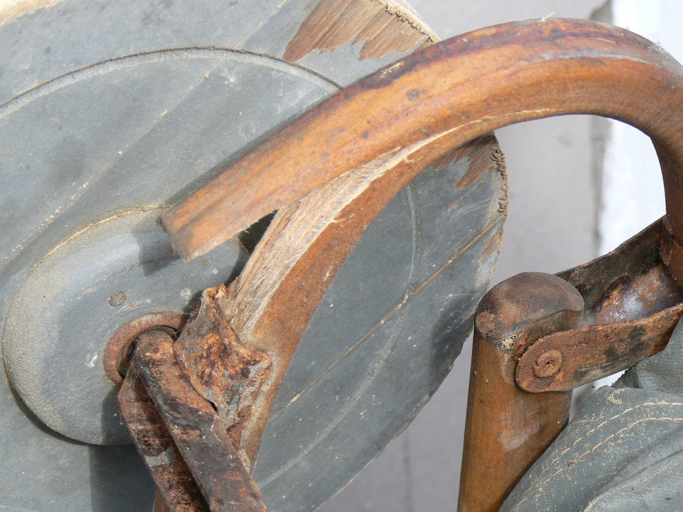

I was asked to repair the bent wood springs on an antique baby carriage for a friend or mine's wife. Laminated and glued thin strips can be easily bent around a form. I tried the steam bending but unless you have the right wood it is very difficult and very messy.
