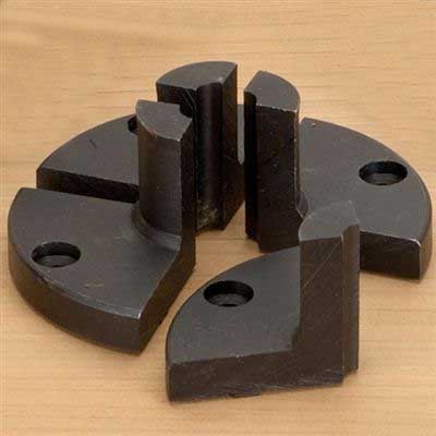

I have read through the discussions on this jaw set but cannot find where anyone indicated what the max OD is on a round blank.
Nova website just says over 3/4".
Can anyone who has a set check to see what the max OD is?
I turn all of my blanks round before drilling so the capacity on square blanks is of no use to me.
Thanks all.

I have a G2 and a G3 nova chuck. Jaws I have the 1", 2", 4" and cole jaws.
This is the 1" jaws and this is a 3/4" round Bethlehem Olivewood rod in the image.
I also drill, flatten and round using the chuck.
I have my pen plus jaws mounted on a Super Nova 2 chuck and it looks like they will take a rod just under 1 1/2" in diameter. The pictures are with a 1" diameter rod.

Also, now that Dick was kind enough to post really good pictures of the pen plus jaws, I'm not sure those would be the best idea for round stock.
I think you are correct Ed and those would be better suited for square corner stuff. They would leave indentations on the larger sizes I would think.
Thanks Ed. I think a G3 is in my future as I want to also get a reversible lathe soon and I'll need the one with the set screw.
No problem with indentations except possibly on very soft wood. Shouldn't be a problem anyway as you are going to turn and sand after drilling.
I have the full set of jaws for my Nova chucks and without a doubt the pen plus jaws give far better support for drilling.
