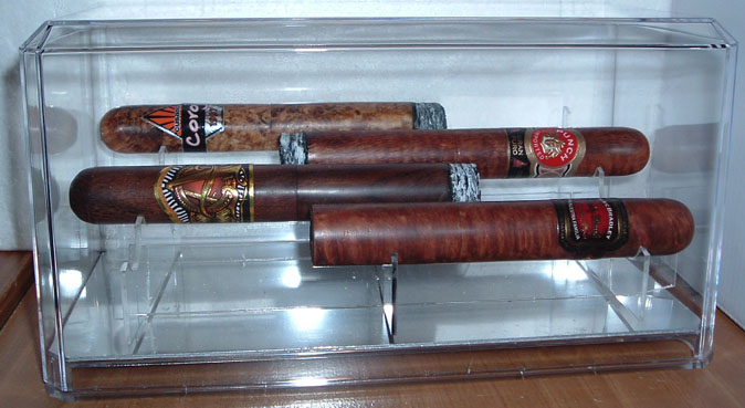

BTW, here is what I am working on that I needed to make these cuts.
These plastic display cases are too large for a single cigar but this will work for 4 in each.
I have 2 more of these to finish and another with smaller slots.
The humidor I made for display doesn't show them off as well as this does.
