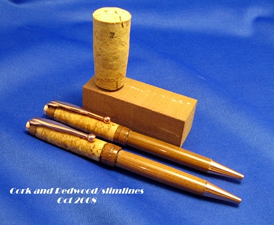

hi i have a custmer that wants a pen made out of cork. my question is how do i do this kind of pen and where do i get the supplies to do this type of pen. thanks for the help
PaulDoug
Mar 2, 2008
3,488
Benton City, WA.

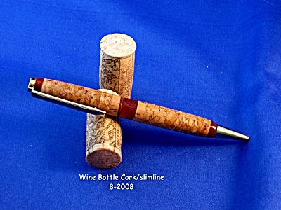

I used wine bottle corks. Drill carefully and slowly, turn with sharp tool to close the size you want. Then get some of that mesh they use to sand dry wall joint compound. It sands cork very nicely. Saturate the cork with CA and sand and finish.

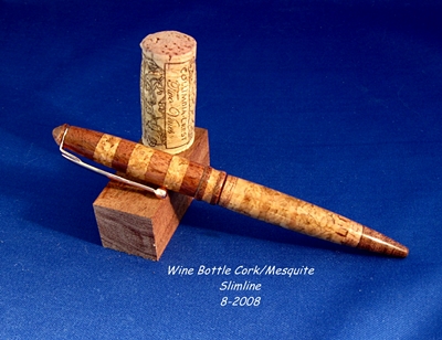

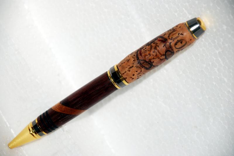

Wow. Neat.
Is there risk of the CA cracking? The cork is compressible.

I have not had any reports of it cracking. I gave the cork and redwood pens to my neighbor. The redwood was from wine barrel stave (they own a winery so I thought it was appropriate). They just told me awhile back they carry/use them all the time and have had no problem with them.

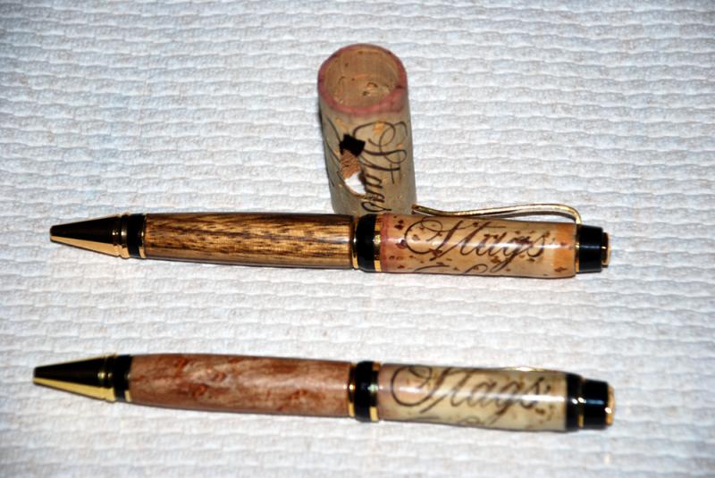

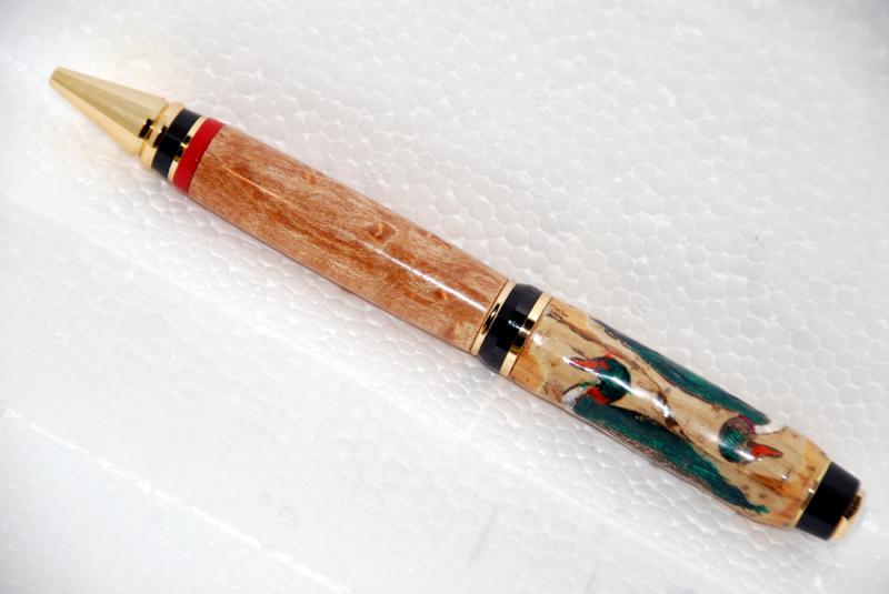

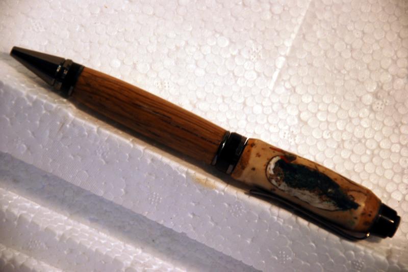

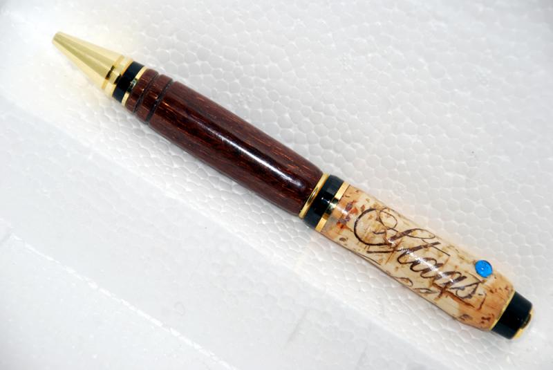

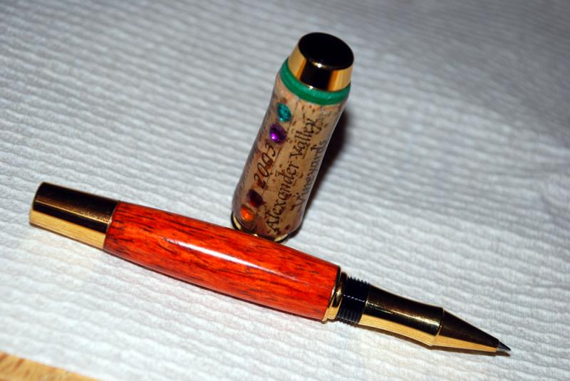

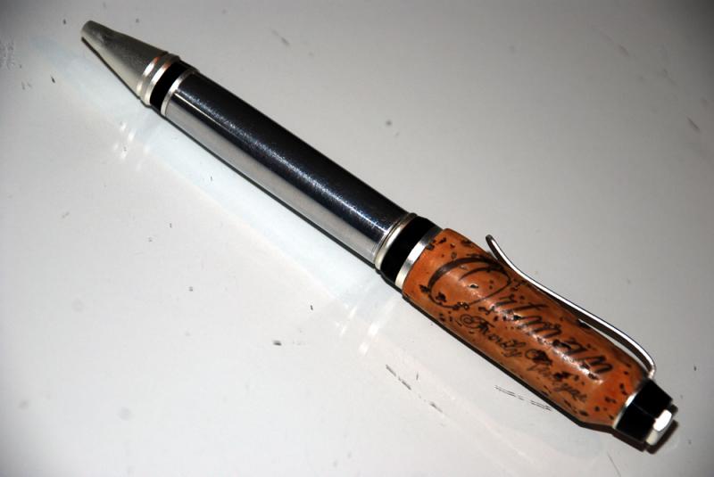

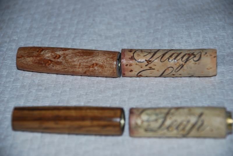

Here are some that were done by Grden's Art.

Thanks John, but you have figured out how to keep the printing on the cork. I've tried several without success. Guess I'll have to try some more.
I use a sharp brad point bit to drill cork. Works pretty good as long as the cork is supported well and I go slow.
