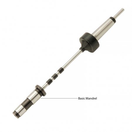

So I thought that I had bent my pen mandrel and ordered another one. However I place it into the headstock and I am seeing the same wobble at the end that made me think the last one was bad. Is this wobble normal or do I have a dud lathe? Lathe is a less than three month old excelsior from rockler.

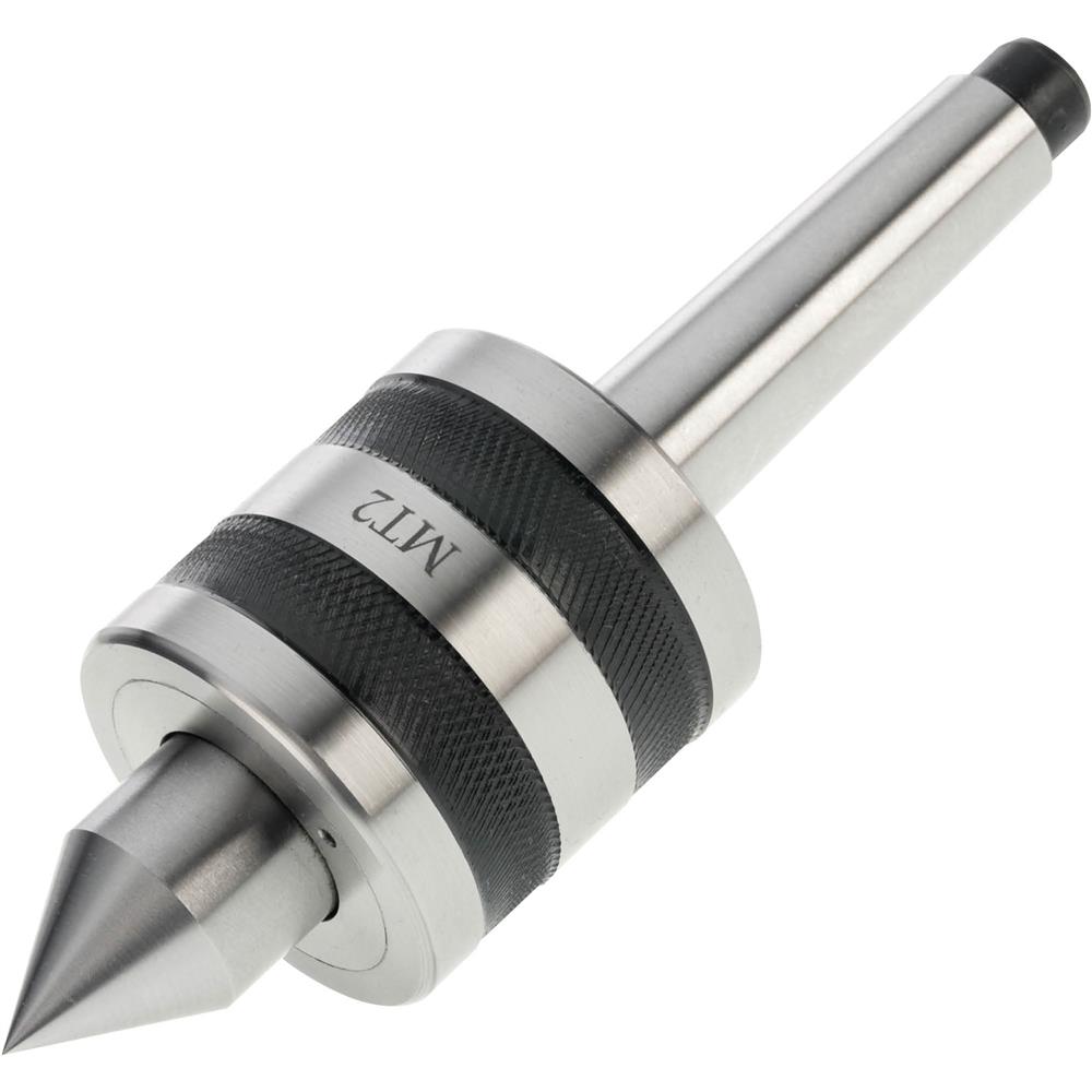

What kind of live center are you using? Is it a 60° live center? If you don't know about this, you should read up on it. It sounds like your cause.
1. Most pen lathes are WOOD lathes. Wood lathes come with a live center made for WOOD. The mandrel is METAL. When a live center that is made for Wood, is used in a mandrel, the point of the Wood live center does not match the Metal cup of the mandrel, it balls up into a tiny ball or bends and the mandrel wobbles.
2. You need a 60° live center.

The mandrel has a tiny "cup" on the end, and that "cup" is actually a 60 degree cone-shaped indentation.
The live center which you use in your tailstock should also have a 60 degree pointed tip as a match to the "cup".
When you buy a live center at a place that sells wood-turning lathes and accessories, they might sell you one that is more sharply pointed than 60 degrees. If the live center that you have actually came with the lathe, it is almost certainly too sharply pointed.
That could very easily result in the situation that you are experiencing, as Hank suggests.
You really do need a live center with a 60 degree cone-shaped pointed tip.
If you go to a place that sells metal-working lathes and ask for a live center, you will almost certainly be shown a 60 degree live center.
But you also have to be sure that the tapered shank of that live center is the correct one to match your tailstock.
The most likely taper to match your lathe will be a Morse taper #2 (MT2), but it could be a Morse taper #1 (MT1).

Here's what my mandrel looks like and the 60 degree live center.

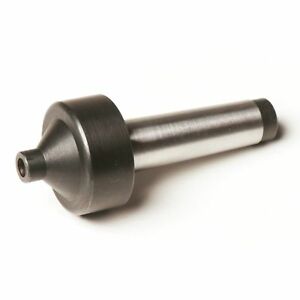

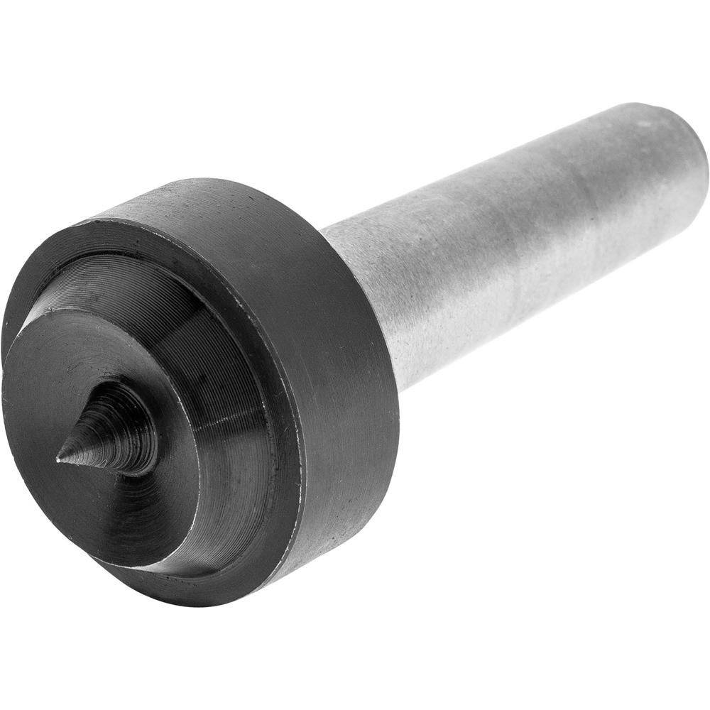

Bobby, That which you posted is a mandrel saver, not a 60° live center.
60° live center:
Made for Wood live Center:
The one made for wood is more pointed and will bend or ball up on the very tip when inserted into the cup of a mandrel.
60° live center:

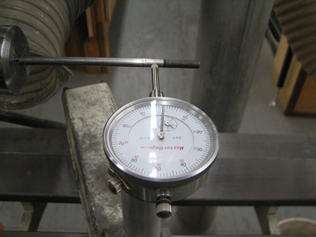

Get yourself a dial indicator and you can "tap" on the mandrel with a small hammer to get it running true BEFORE you hook up the live center,
EXAMPLE...
