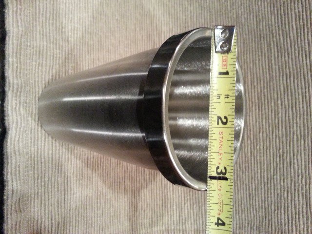

The length is perfect, but the width is a little short. Here's a pic of a stainless liner. I need about a 1/2" a more than it to give me some wiggle room. Can a bigger mold be made?
Any size pvc can be used as a mold. So 4" PVC would work.
BINGO! That is a great idea. That is exactly why people like me reach out to people like you for direction.
As much as I hate casting in PVC this would be the easiest way to go before investing serious $ in a silicone mold.
