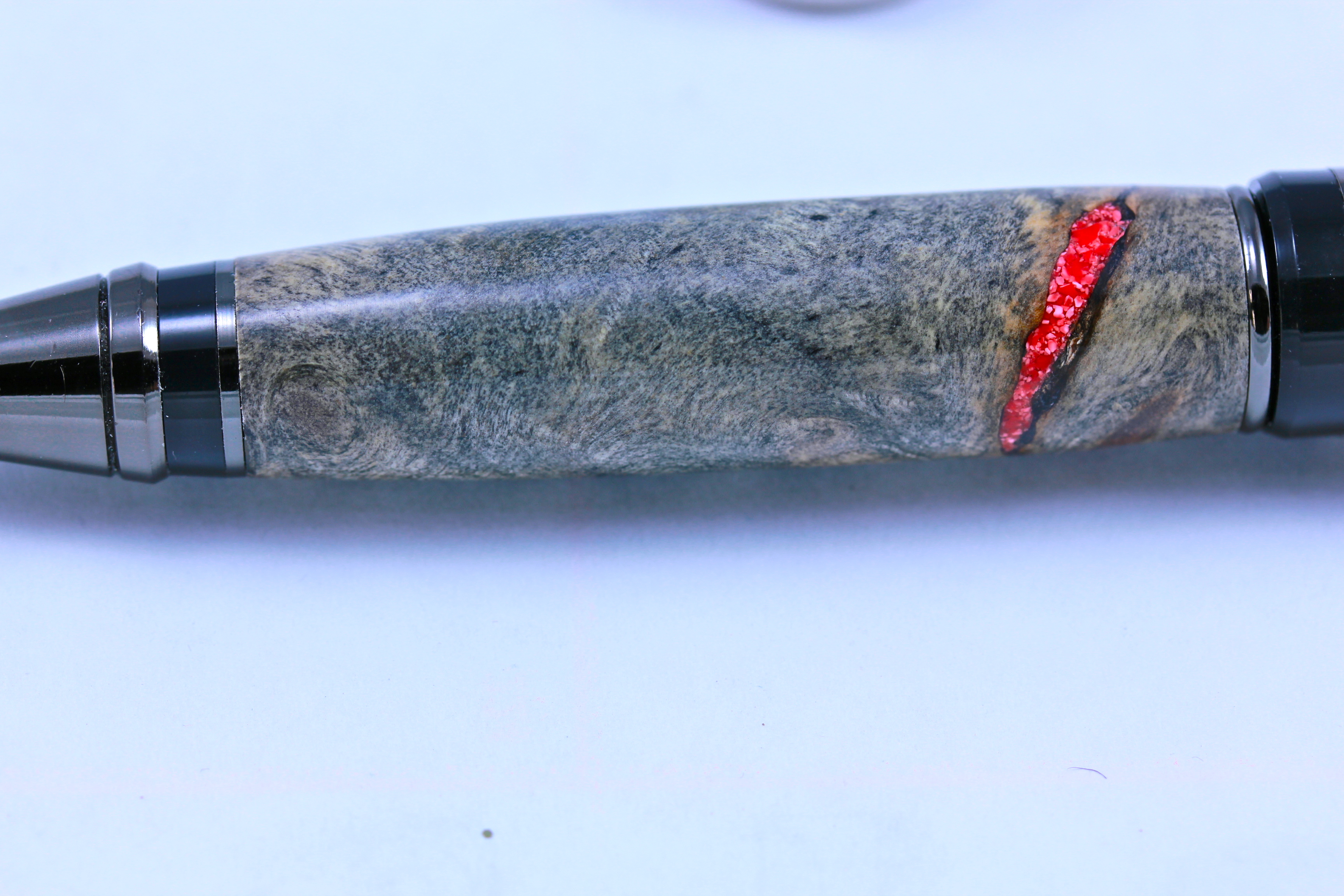

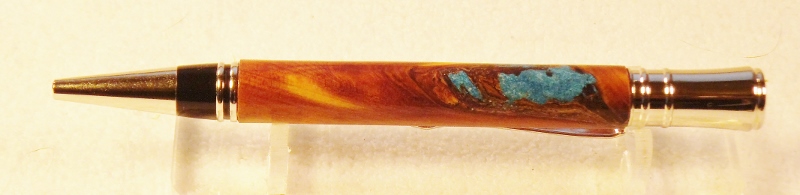

Others will have more experience. But, I have done a little bit of this. All with CA, thin and thick. I've used crushed coral, sand, and embossing powder.
Have FUN!
View in Gallery

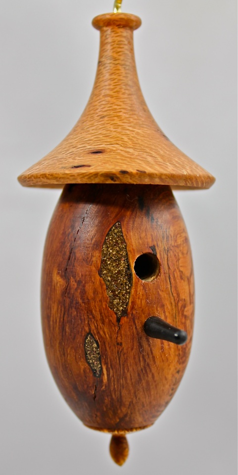

Years ago, the building at work was getting re-keyed. I asked the security manager if he could get me some of the brass filings from when the keys were cut. He looked at me like I was a crazy man, but did bring me a bag of brass shavings. I've used those over the year to fill in cracks in bowl blanks. I'll pack the void with the shavings then start drizzling CA over and into it. It turns away smooth since the CA and brass are softer than HSS.

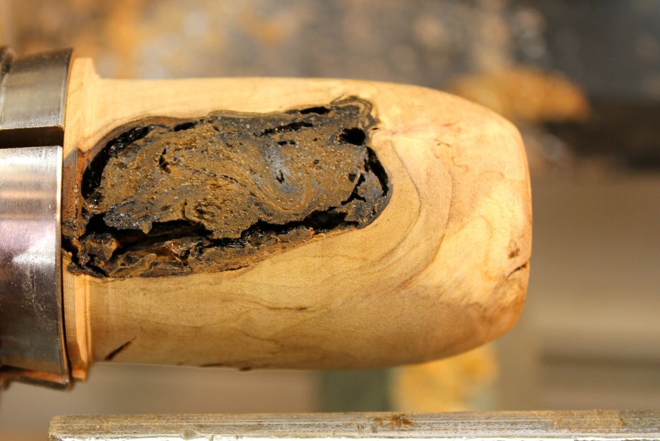

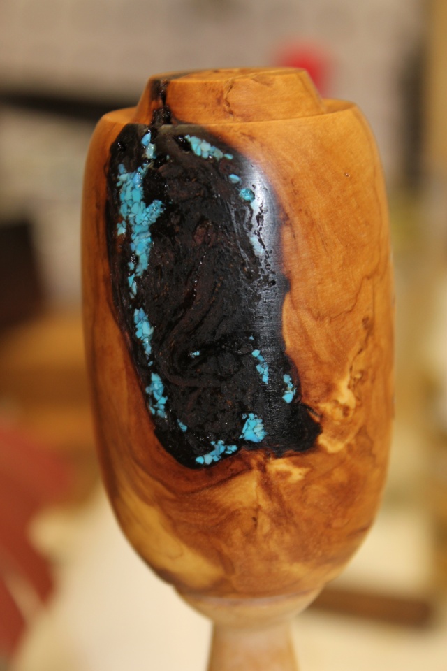

I had a woman who wanted pens made from a piece of wood from a tree her kids played on when the were kids. The wood had voids from bugs, and was slightly spalted so I mixed up some black Testors paint with a little epoxy and filled the voids with that. Hope this helps,
Bill
