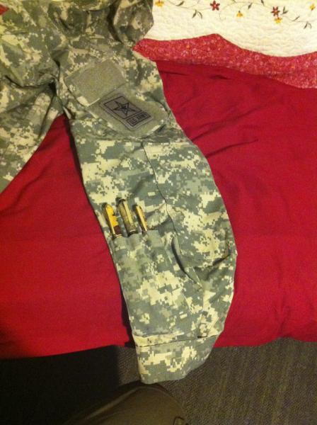

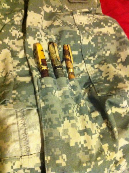

I'm a supply Sergeant in the army. I carry a cigar pen, a Trimline, and a designer with me most days. I've also been know to carry a Presmo (PSI) or Jr gent. The Army Combat Uniform (ACU) has gone through three changes so far and the sleeve pen pocket that we use has been enlarged with each know design. There is a forth addition to our uniform selection but it only used in Afghanistan at this time. I don't own a set of those "yet" so I'm not sure what the pen pockets look like. Our regs state that pen should not show but nobody enforces it expect maybe our combat guys. In that case black enamel or gunmetal would work better, they can show. (Pic's attached)

I agree Trimline, slimline, and designers work the best.
Thank you for the comments and the pictures. So no to the pink, yellow, and purple with the gold stars. :biggrin: This is quite helpful. If you think of anything else please let me know.
