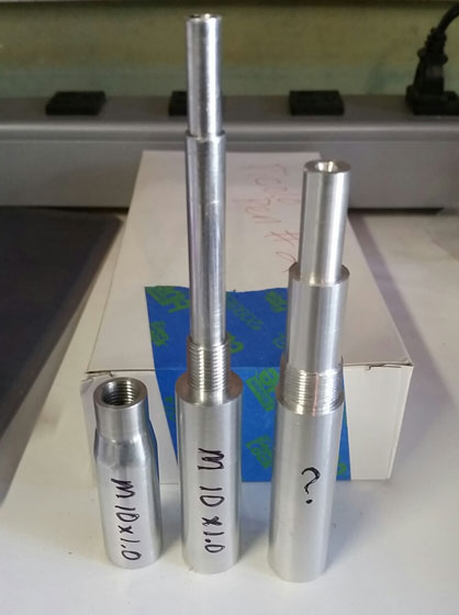

I'm starting in on turning kitless. I will save the nib section for later and focus on the body, cap, and finial sections. I'm pretty set with taps and dies, although I haven't had any luck finding a triple start 14mm set. I think the attached photo has a mandrel (far right in the image) that is for a 14mm cap thread.

I already checked with Mike. He doesn't have one. It doesn't look like there are any available. I will just make do with what I have. I just thought it would be nice to have a set since I have the mandrel.
