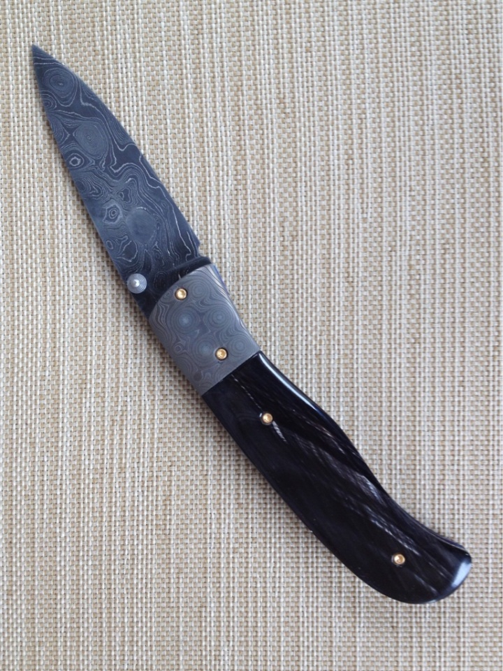

After making a few consider scoring some Damascus from Alabama Damascus, great steel at a reasonable price. The Damascus makes for a memorable blade and the patter helps hide those minor imperfections in your grind lines.
Danny
