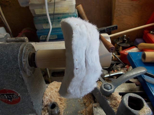

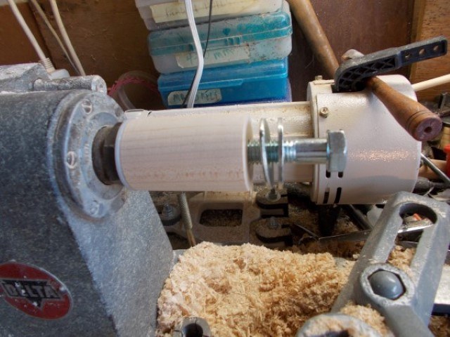

I bought some 4" wheels from Caswell plating and made a mandrel that screws on to my Taig lathe. I drilled and tapped a 1.5x1.5x3 block of wood, only drill and tap deep enough to fit the spindle threads. Turned it round and then drilled and taped the tailstock end for a 1/2-20 bolt. These pics are not on my Taig, but to give you an idea of what you want to do. I also think I picked up small buffing wheels at Harbor Freight, but unless you have the compounds, I would wait and order from Caswell Plating.
Before going to Caswell read this link. http://www.penturners.org/forum/f30/buffing-kicked-up-notch-55476/
He covers the compounds and the buffing wheels.
