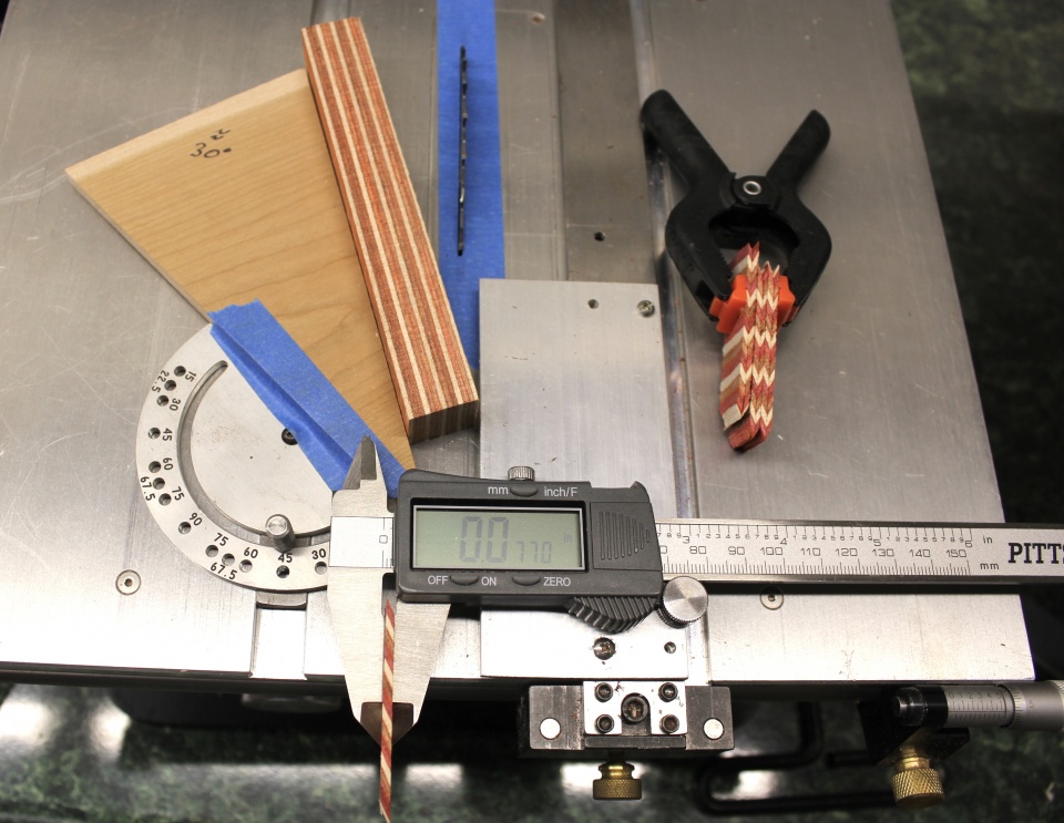

G'Day Tim.
I have both machines - and am very happy with each. (I lucked out and got them used).

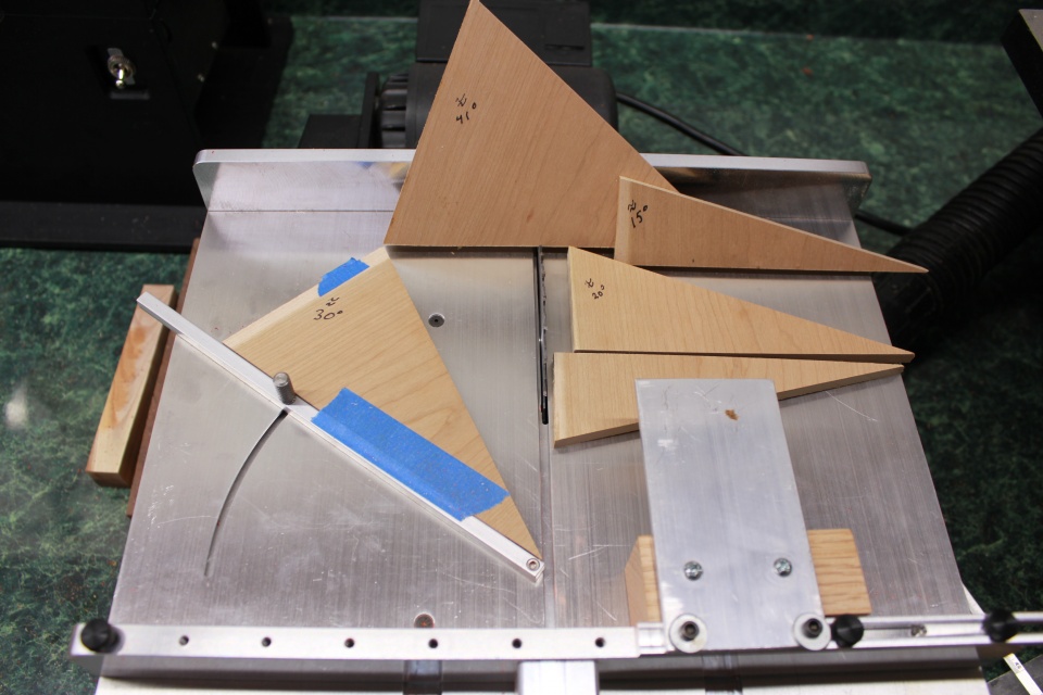

They each have some advantages, and to be honest, for my segmenting, I need/use both extensively.
The highest the table saw blade cutting height is about 15/16" So any pen blank close to 1" thick will need two cuts. And my machine (an older year - newer motors may be different) will stall out with 3/4" hard maple, etc... Yes, I can work around that.
Blades, online will offer replacements, and I have a local shop for sharpening - I prefer the carbides. I can supply all sources if you need.

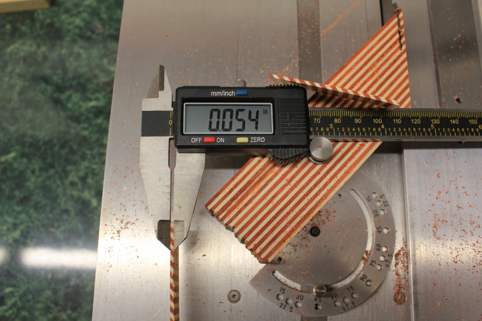

If you are cutting a 1/2" - 3/4" board, yes, you will be able to cut very thin slices; I have gotten down to about .05" (I'll look for evidence!).

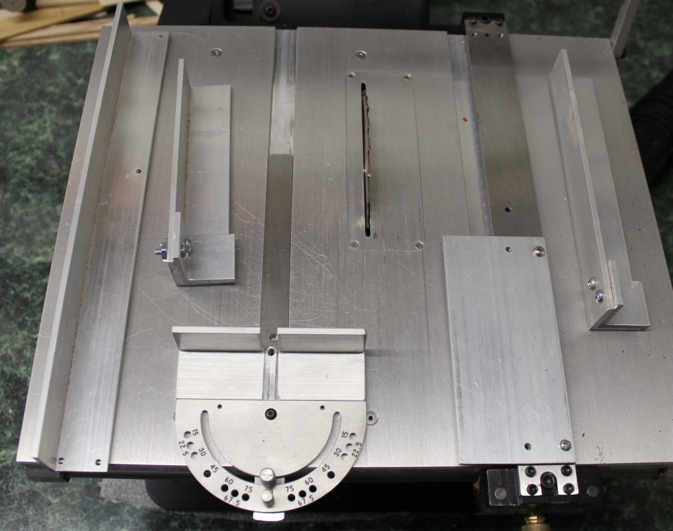

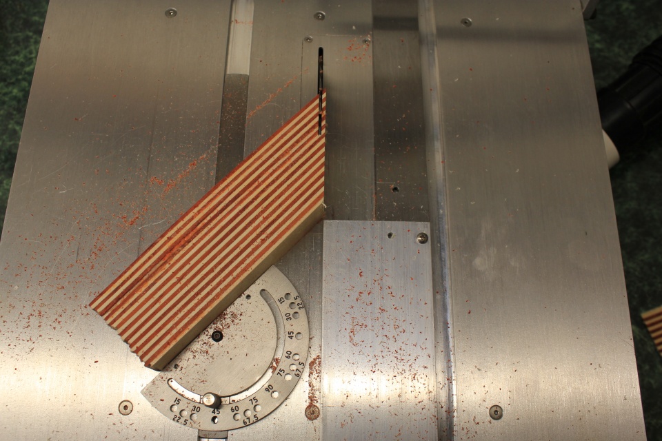

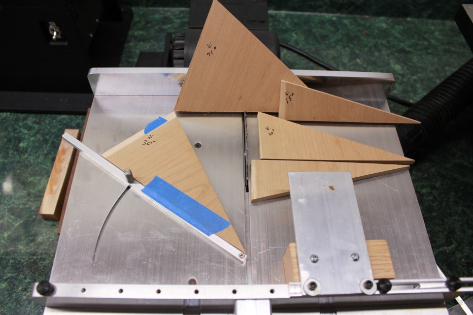

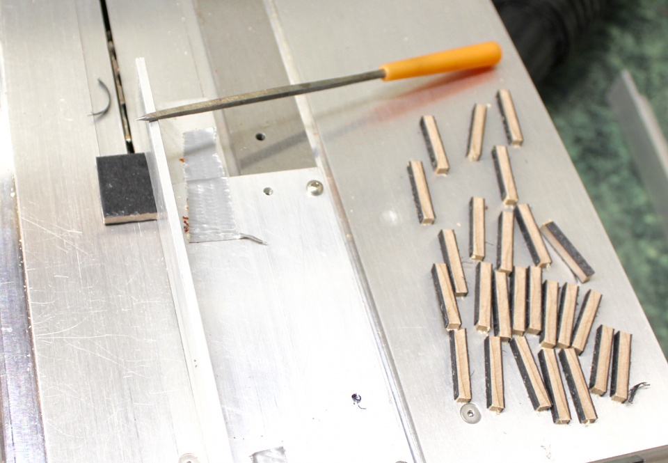

I use quite a few jigs - pictures to follow.
But, the thickness sander is crucial for getting equal dimensions for thin stock.
It may be beneficial for you to try to think what type of segmenting you are interested in. That may help you decision.
And I am not giving a commercial for the Byrnes machines - I love mine, but other brands may be just as good.
So, some pictures follow, and ask any questions that arise.

Yes, I have usually used the 24 Tooth carbide. When I got the machine (very lightly used) there was already a new second blade and several others, non-carbide and smaller than 4". I have used both 4" 24 tooth carbides and have had them resharpened - (about $4.50/each - don't quote me). I have had no need to explore the other blades, but I am hopeful that some, any design will prompt me to do so!!!
