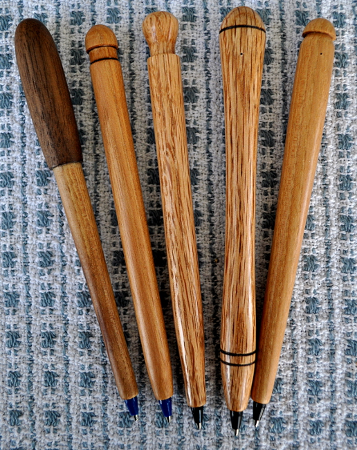

Here's a picture of a few of these pens that I made last week.
I drilled a breather hole on four of these pens using a very small drill bit in a pen vise. I know that the interior hole in the pen on the left is drastically off axis (the walnut end was added to repair the damage where the hole came through the side of the pen body!) If you look very closely, you can see a breather hole in the two pens on the right. In the next two over, the hole was drilled through an edge of the finial at the top of the pen so that it doesn't show.
L-r: walnut/ash, ash, 'mystery oak', 'mystery oak' , and ash . The 'mystery oak' is wood that looks and acts like oak, but came to me in the form of a very grungy shipping pallet.
