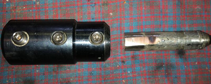

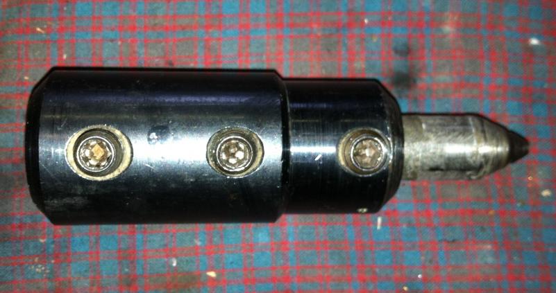

Mike,
Go down to Lowes, HD or Ace and buy a 1/2" by 6" HSS bolt. Cut off the threads and then start grinding. Your dead center does not have to be an exact 60 degrees. Then mount it in your router chuck, and there you go. I have been using mine for nearly a year now with no problems. Here's a couple of pictures. Notice in the 2nd one that I flattened one side of the shaft so the hex screws will hold better.
Good luck.
John
