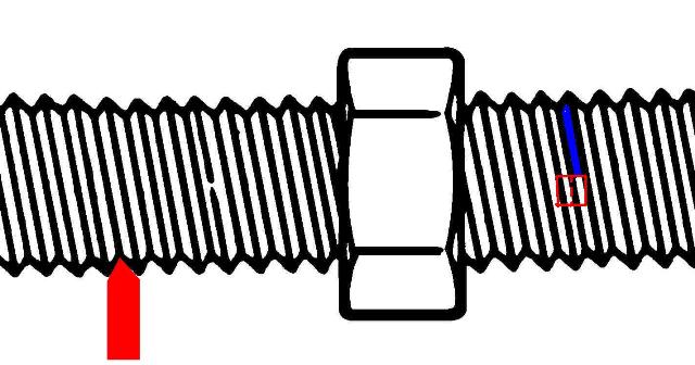

I'm sitting on site waiting for the client to get here so I knocked up this drawing to show the negative rake on the right hand side of the groove.
Look at the pic....on the left of the nut is the normal way cutters are shown in books and stuff. This is looking from above the work. But on the left of the nut I've drawn the cutter from the side ( or front ) of the work.
It's not a great pic but you can see that the left side of the cutter will have positive rake while the rhs (blue) will be a negative.
Like I said, I just ignore this on fine threads. Hope this helps

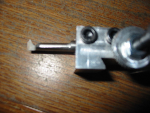

Would a side cutter (in the pic) accomplish the same thing as the 29.5 degrees
if I left the topslide parallel to the ways? (or offset by .5 degrees?) If the
cutter is held perpendicular (coming straight out of the tool holder) it looks
like it would have 0 degrees already .. as if the left side of the cutter is
making a parting or facing type cut.
no, because youre still going straight in and cutting with both sides of the cutter. the reason for the compound at 29.5 is so you have some relief on the back side of the cut, you are actually cutting more on the feed side leaving some room on the backside. less chatter and better cut. when you get close, go straight in with the cross slide for a thou or so to clean things up. once you do it a couple times it will make some kind of sense for you. personally, i dont like carbide inserts for thread cutting. i prefer to grind them out of hss. thats my preference though and a lot of people use em. a good thing to practice on is some pvc pipe. soft, easy to cut and disposable. main thing is to have fun and dont hurt yourself. regards, j.d.

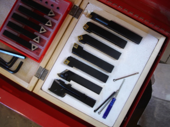

I'll interject Charlies post because it all relates and I am being informed here too. I have those same cutters he has there plus this other set. I think the second one from the bottom is a thread cutter for outside threading. It comes to a skinny point but also it is tapered on the bottom side. Am I correct that this is a thread cutter? I am pretty sure I know what a couple of the other cutters are for, but how about someone list what they all are, for me and anyone else starting at the top. Thanks!

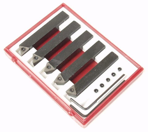

As long as the cutter is 60 deg it doesn't matter what you use, carbide insert or HSS. We all have our preferences. I really don't like the carbide inserts as they are very unforgiving. :redface: Sometimes you will want to cut a thread simpy by rotating the chuck by hand ( power off ) Well I've broken more carbide tips than I'd care to count. Only cos of my own stupidity really. If you turn the chuck backwards with a carbide cutter still touching the work, then it'll snap the tip off.
I love HSS, it slices stainless steel like butter and you can make all sorts of cutters to suit any requirement.
Some people say that carbide cutter give a superior finish. Mmmm, perhaps, but I'm gonna polish the finish anyway:biggrin:
Jeff, the gauges are dirt cheap and you should easily find them at any tool shop. But let me know if you really can't find one and I'll post you one.

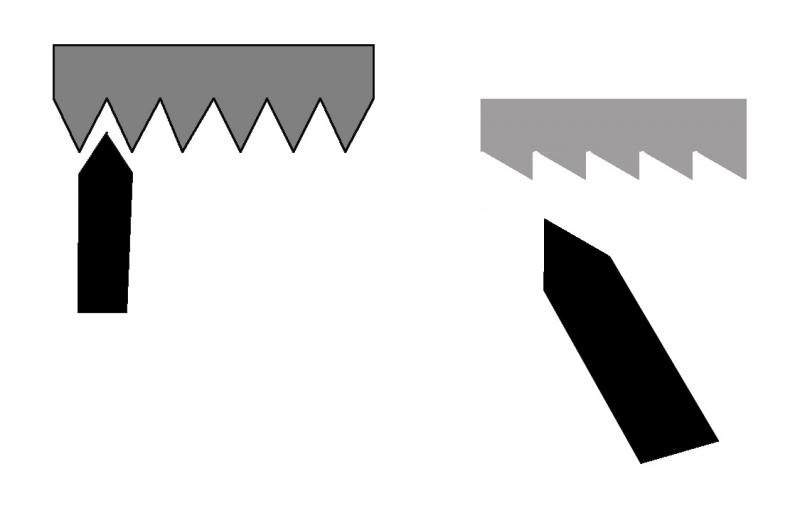

Here's a visual of what I was wondering.. turning the compound 29.5 degrees..
Would it do this to your threads? First one is going straight in with a
60 degree cutter. Second is the same cutter turned 29.5 degrees.
Is that right? Or am I missing something pretty basic?

Charlie , the cutter should be perpendicular (like your picture on the left) to the work piece it's the top slide that is turned to 29.5 degrees , then by advancing the top slide you will be cutting mainly on the left side of the cutter and slightly to the left and a little deeper .

Yes and by advancing the top slide you are just cutting with the left side of the cutter . I do it the same way skippy does for fine threads and it seems to work well .

OK, I keep seeing the "set the cross slide to 29.5 degrees" after setting the cutter
perpendicular. Won't that give me the thread shown in the figure on the right?
Or am I setting the crossslide to put the CUTTER at 29.5 degrees? (rather than 30) ?
.. half of the 60 degree cutter head = 30 degrees
Setting the cross slide to 29.5 gives you a 0.5 angle on the left and 30.5 on the right.??
One of these I understand.. the other, I don't.

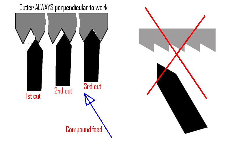

Ok .. something just clicked.
You NEVER move the crossfeed. Only the compound is moving. And that's driving
the cutter toward the headstock AND into the work.
So .. is the cut really only being made by the left side of the cutter tool?
Looks like it would be a scraping cut?
One of the things that was throwing me is that my tool holder locks in 90 degree
stops .. so if I turned my compound to 29.5 degrees, the tool would also be at
29.5 degrees. I'd have no choice.
I've now changed that out for a QCTP, so I can do this..
thanks!

Here is your sketch. I've shown three passes to do the thread.
If this doesn't sink in after this, then I'm gonna come over there and slap you!!!!!:biggrin:

Yep.. the one with the X through it is what would happen on my lathe if I tried
to change the compound to 29.5 degrees.. since the tool holder was locked to

Jerry.. I think the idea isn't the angle of the cutter, but the angle of the compound.
You want it to move into the work at 29.5 degrees. The cutter still stays perpendicular
to the axis.
It looks like each successive pass takes more off of the left side ,but not really anything
from the right hand side.
