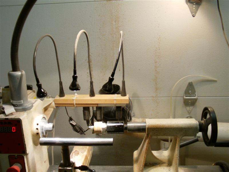

I got this idea from another site. These are LED lights from Ikea. Each light is $9.95 and the goose neck is about 24 inches long. ( maybe 18 did not measure). This way you put the light where you want it. I have seen some guys with 6 lights. The mounting arm in the back can have a second arm attached with a pivot point if needed. I have a power strip mounted underneath the arm with a power on and off.

Dave, I like that but it sure interferes with dust collection.
Dave,
My dust collector comes up just under the arm. In fact it is the black object just behind the arm. You could attach it to the lathe somewhere else but I have it connected to the place where the guard snaps in.
