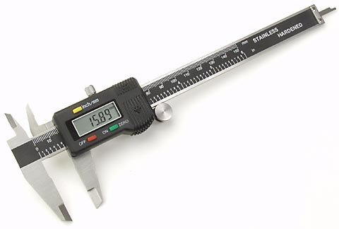

Mikey - Here's what a digital caliper looks like:
