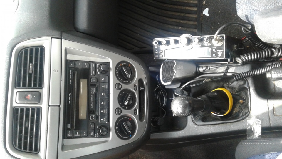

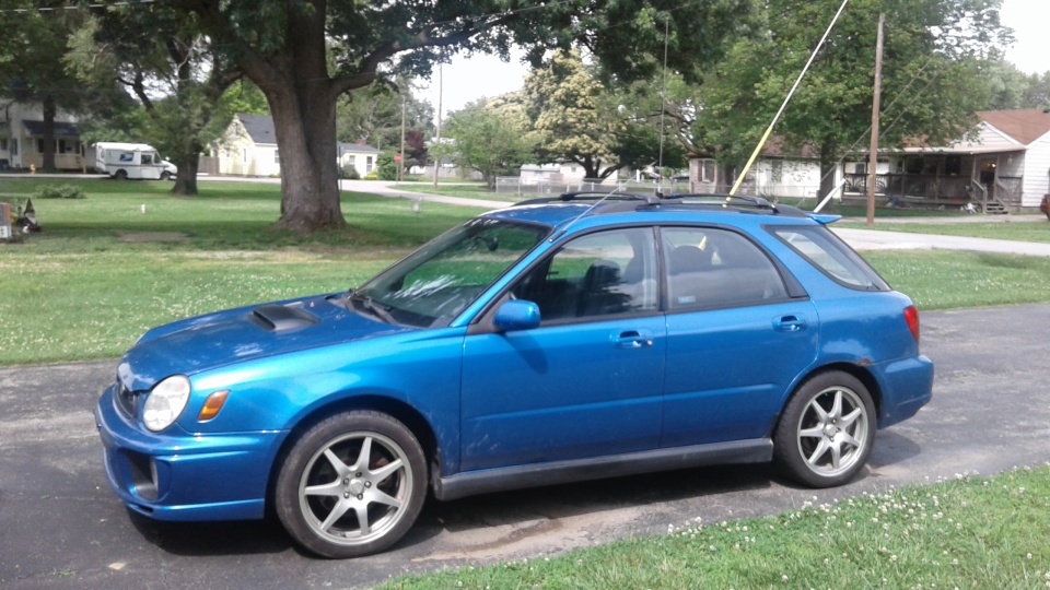

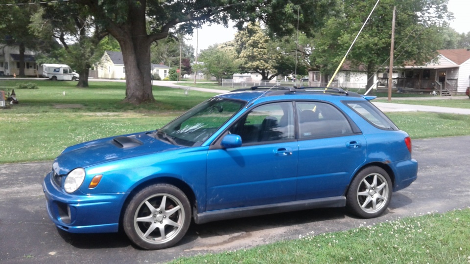

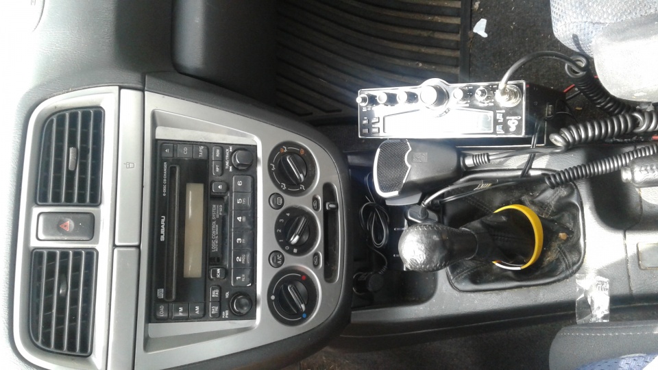

Here is a couple pics after I installed it. I spent a few hours at the guys shop. He probably had over 100 cb radios.
At first, I thought the guy wires for the power pole were your antenna!:biggrin:
Looks good! You will have to give us a report!
