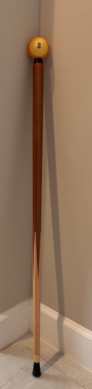

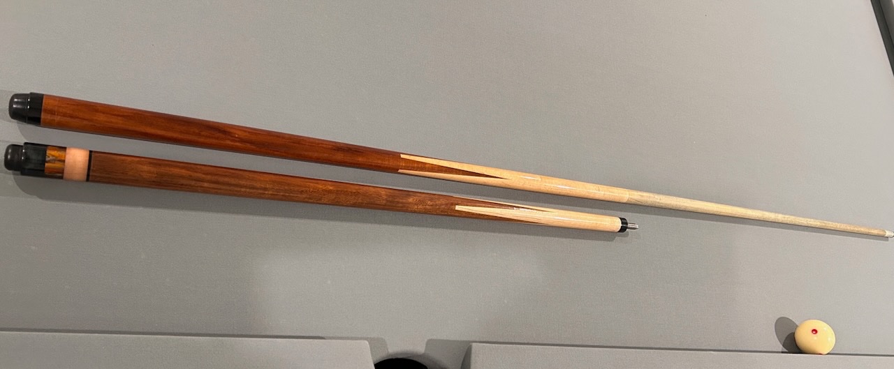

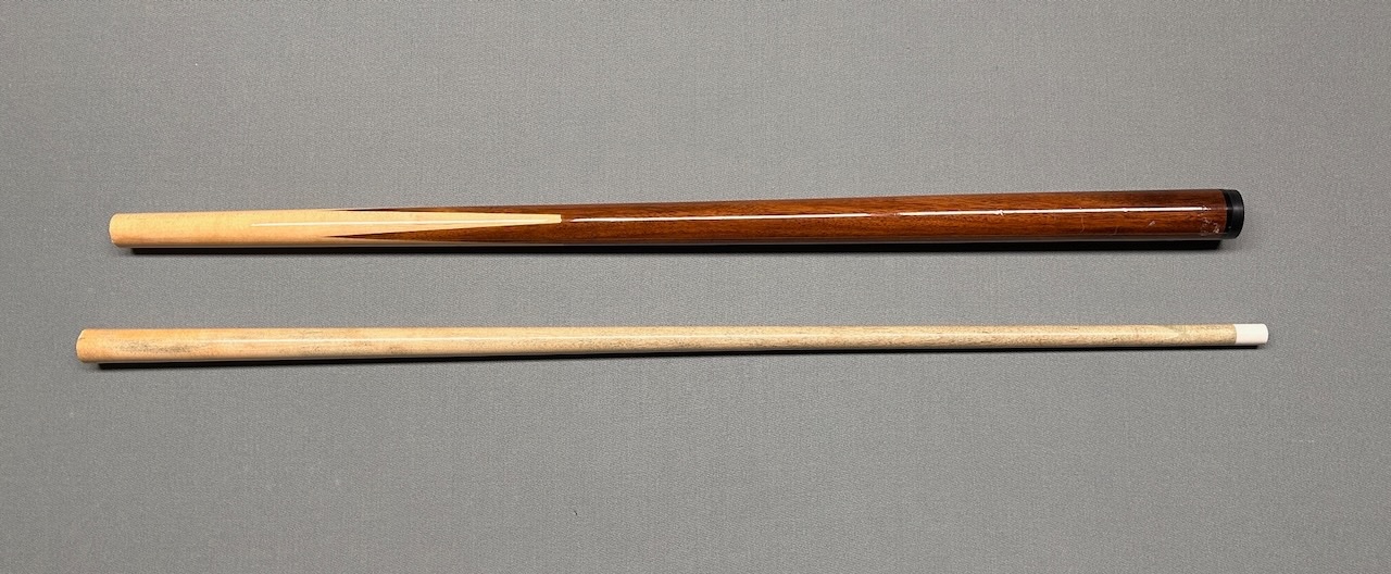

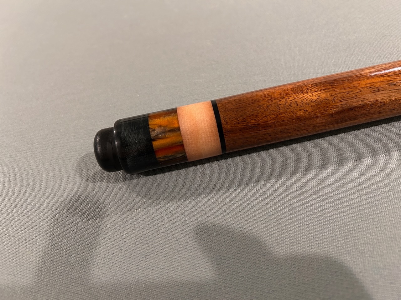

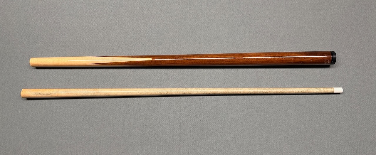

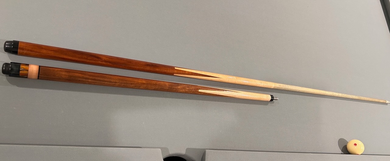

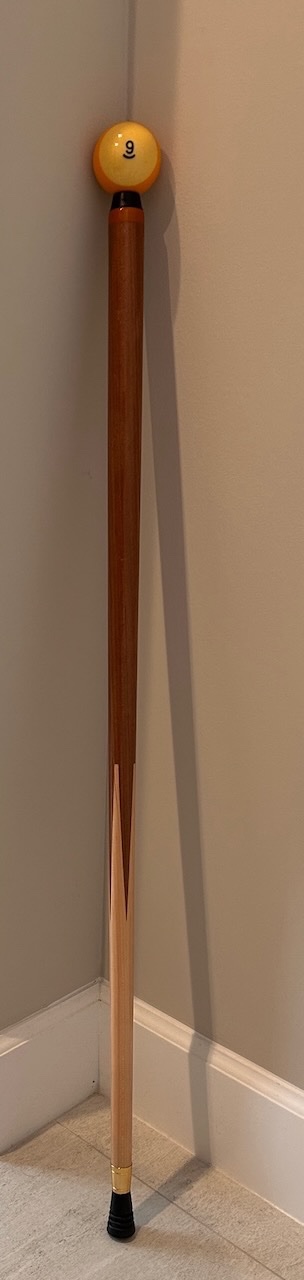

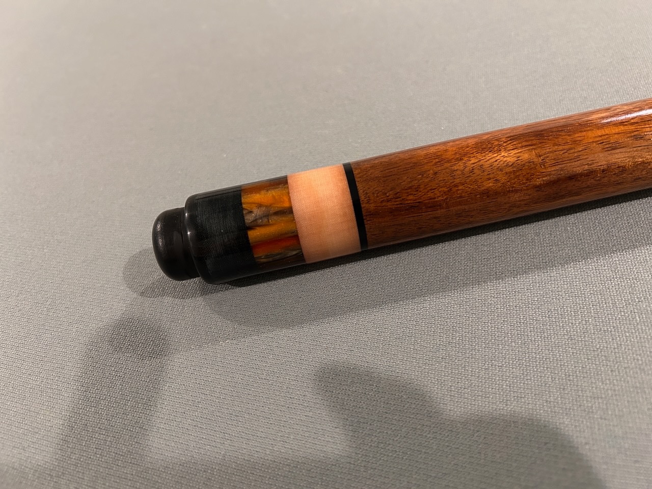

Hey hi...welcome aboard. Pool cues... looking for a stand for my cue lathe accidentally turned me toward pen turning. I use to pass by PSI weekly and went in one day looking for a stand...had no idea what kind of place I was in. I just did my first conversion on a beater. I used the Ring blank on the butt. Turn some canes while you're at it. Are you on AZB Billiards?
