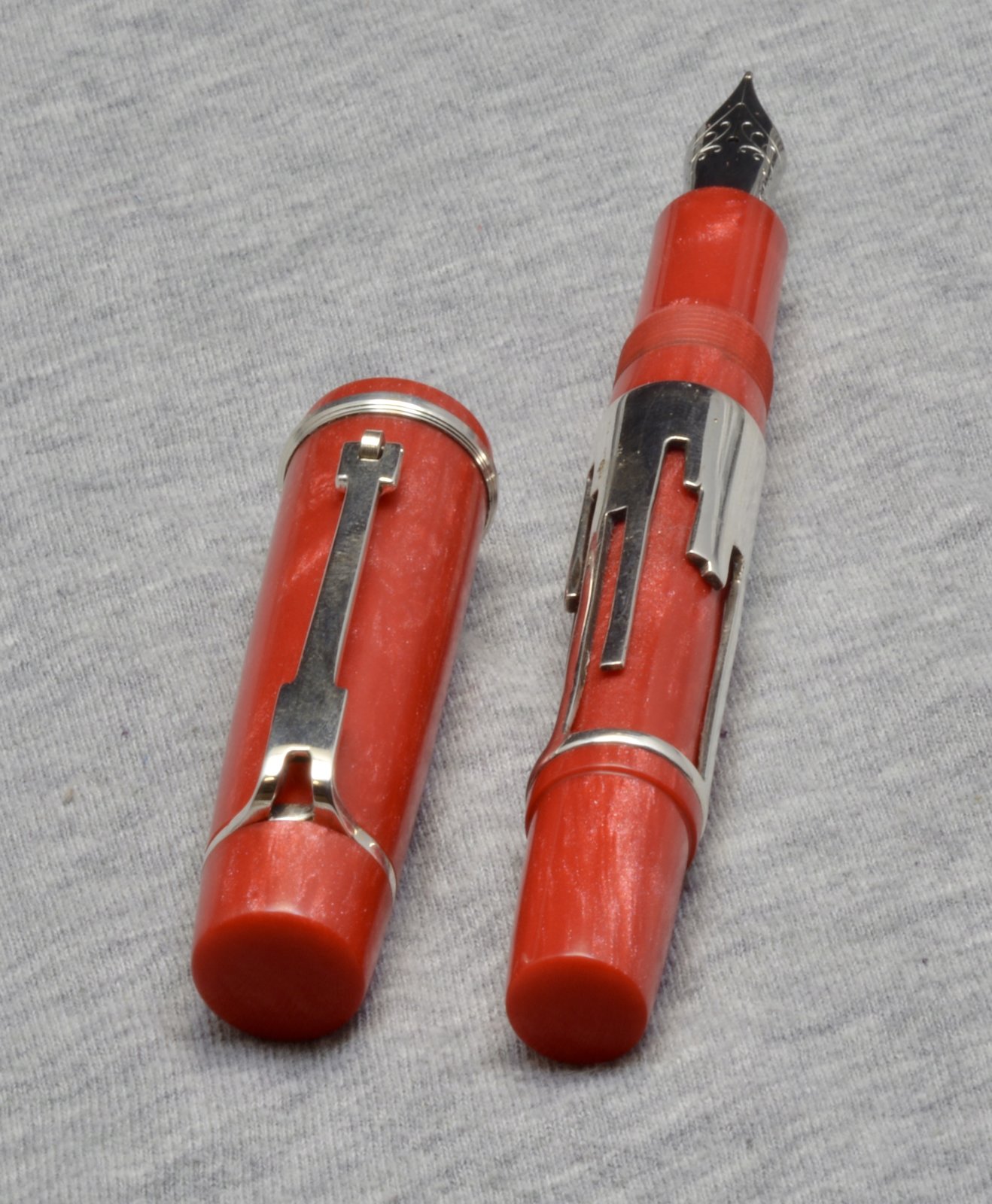

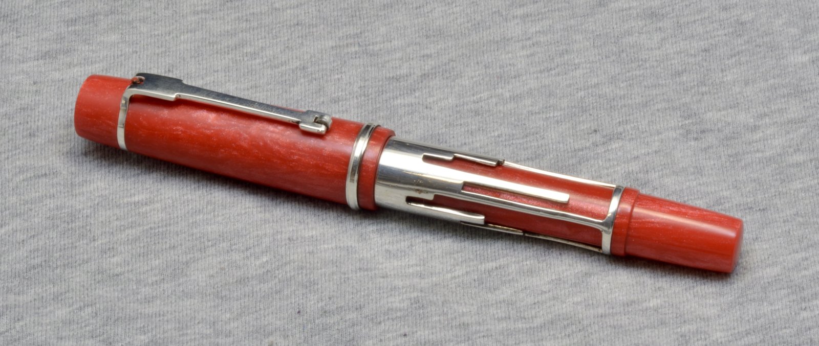

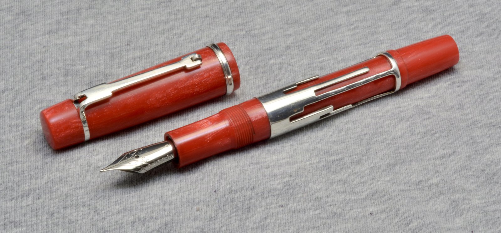

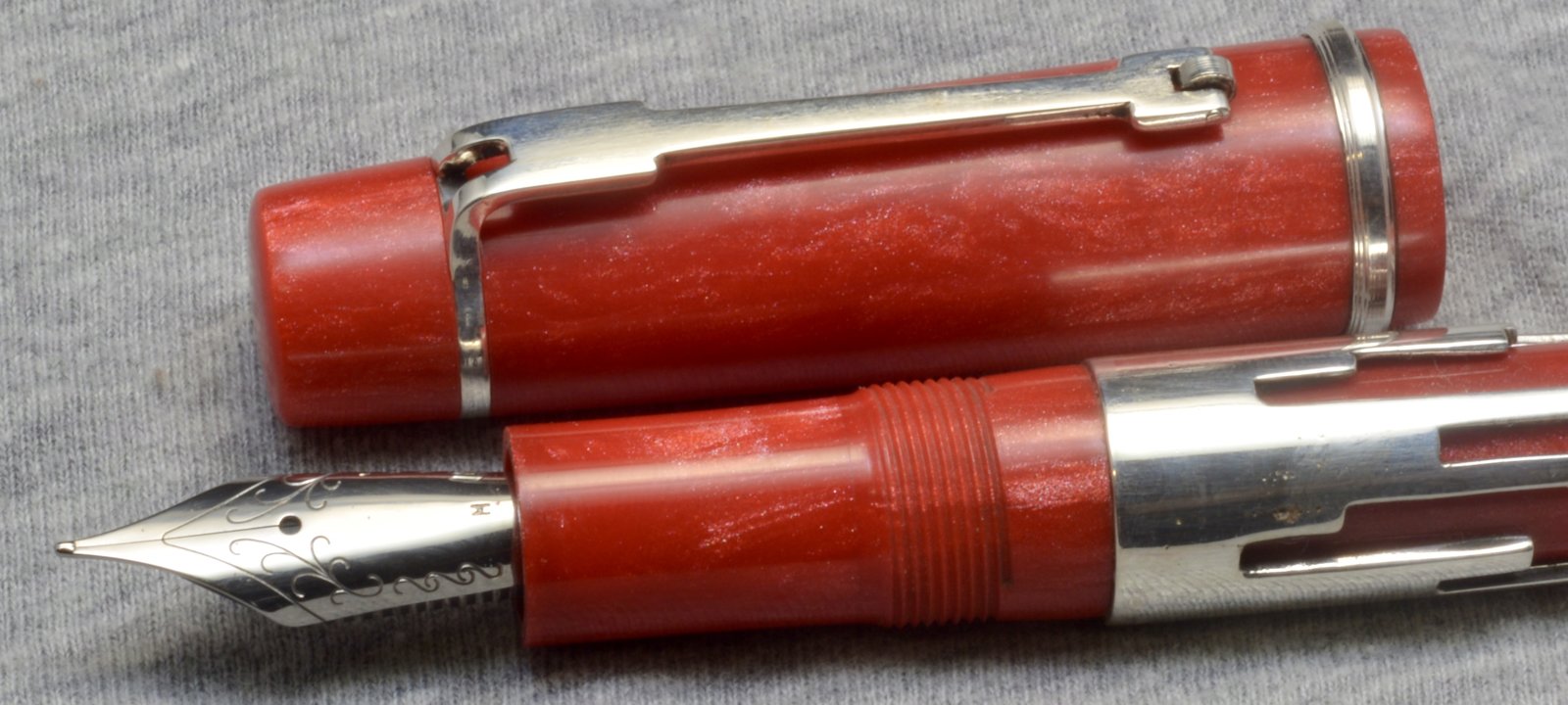

I finished a pen today that I'd been fighting with for several weeks, primarily in regards to the overlay. I made the pen from a coral alumilite I poured (yeah I know, it looks orange, but I couldn't seem to capture the color accurately) and argentium. The pen is mid sized, with a diameter of a half inch at the cap threads, and I used triple lead 12 tpi threads, since I haven't done multi lead threads in a while. I fabricated the overlay from sheet stock, which I rolled up and soldered after cutting out the design. Lastly, I made the roller clip from square wire. The nib is a #6 jowo
Outstanding design and craftsmanship !!
I LOVE it !!!
Glad to see that you still have a tap and die !!
The clip is fantastic !!
