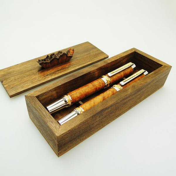

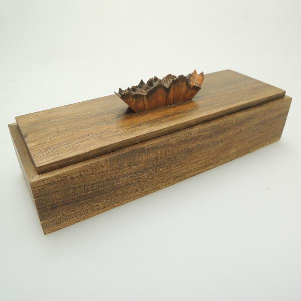

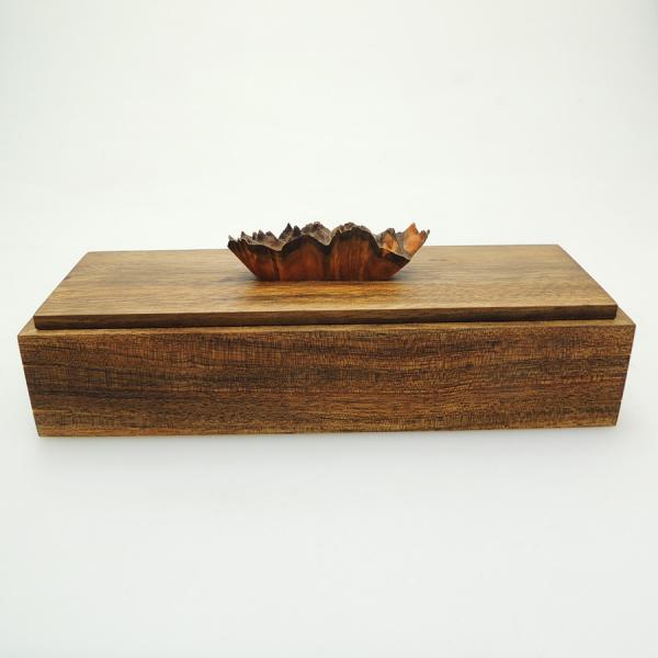

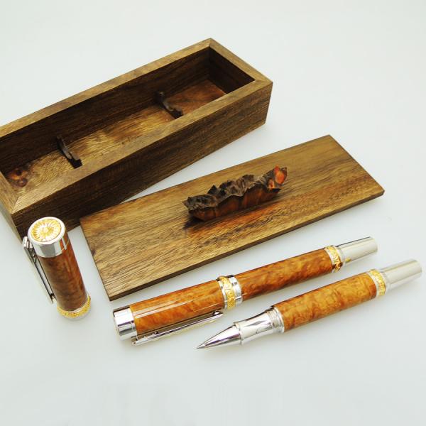

At it again.
This is another QLD Walnut box set.
Playing around with different handles, this one is a scrap piece from a burl cap. I quite like it, might start making these handles as standard. Much easier to make than my other handles.
Here is the result.
The pens are burl Brown Mallee Roman Harves Rollerball and Fountain Pen.
Sanded to 600grit, 20 thin coats of CA. Micromesh all the way then hit it with Brasso, corn flour paste and Automotive wax.
Hope you like it as much as me.
As always, comment or suggestions are always appreciated.
Regards
David

The pens are beautiful--the brown mallee is gorgeous stuff. But the boxes are what caught my eye. Nice design! Love the burl handle! All goes together very nicely indeed.:good:
:bananen_smilies046: I see down under, you not only think out of the box, but also fill the box with great craftsmanship. Great job on pens and box !! Jim S
