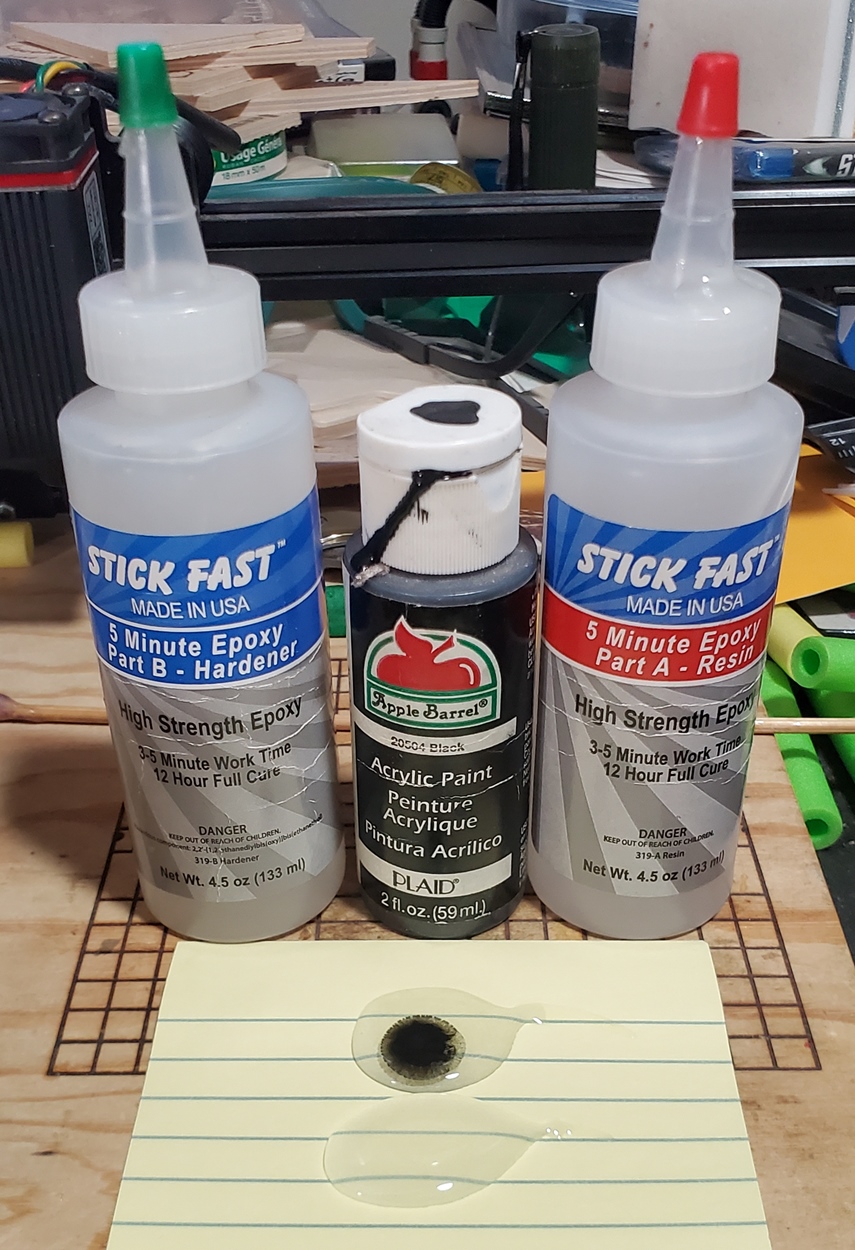

Absolutely yes you can. A five minute 2 part epoxy is all I use on acrylic and other synthetics as well as wood. One thing to note: let the "five minute" epoxy cure for about 12 hours. I recommend that you rough up the tube with 120 sandpaper before you glue it in the blank.

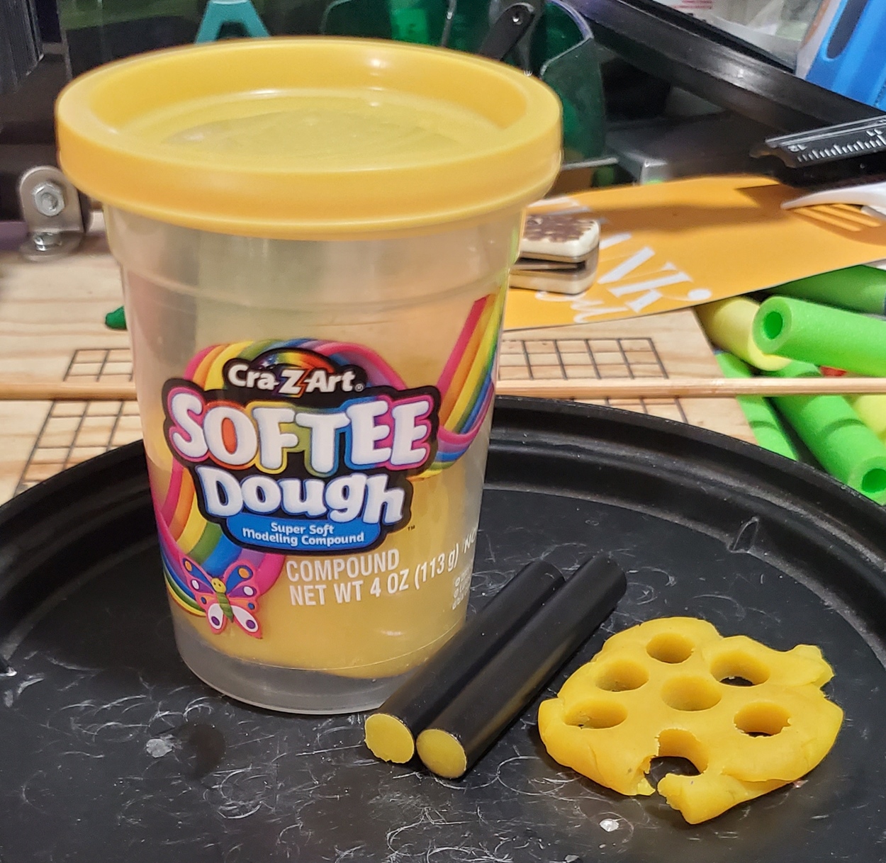

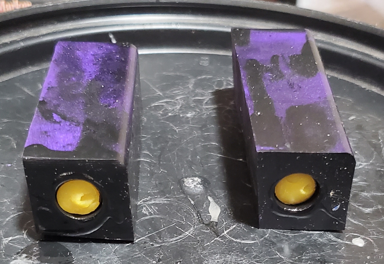

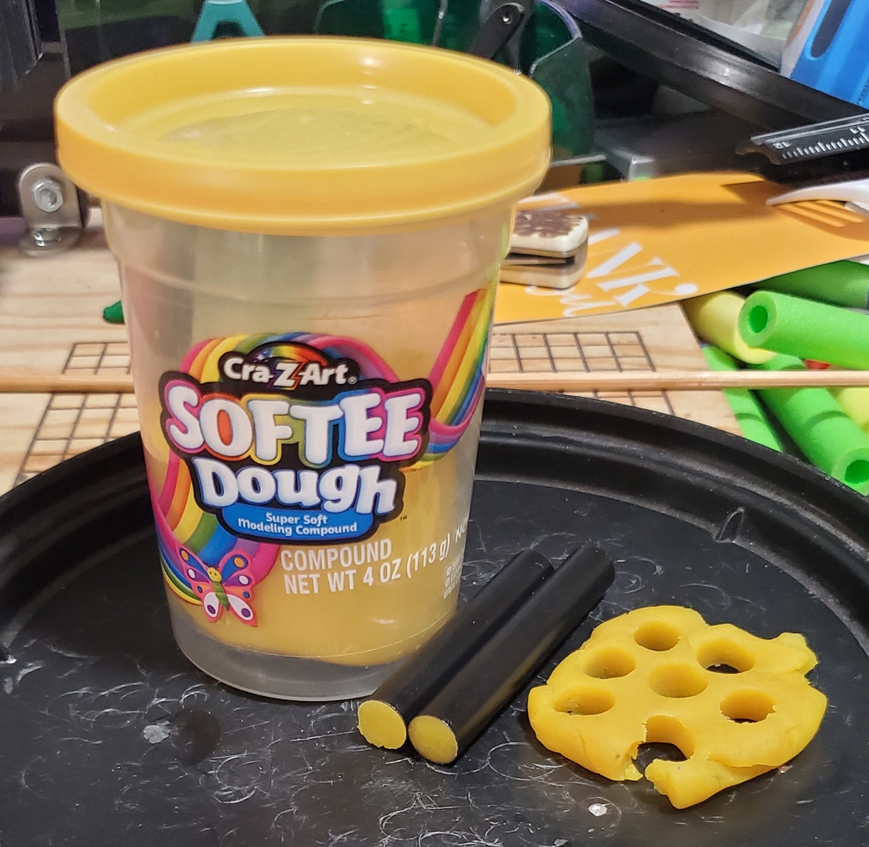

I don't use CA on tubes anymore. Two part epoxy will allow you to accurately set the tubes to the desired depth within the blank. I would use some kind of putty or clay in the ends of the tubes to avoid getting epoxy inside.

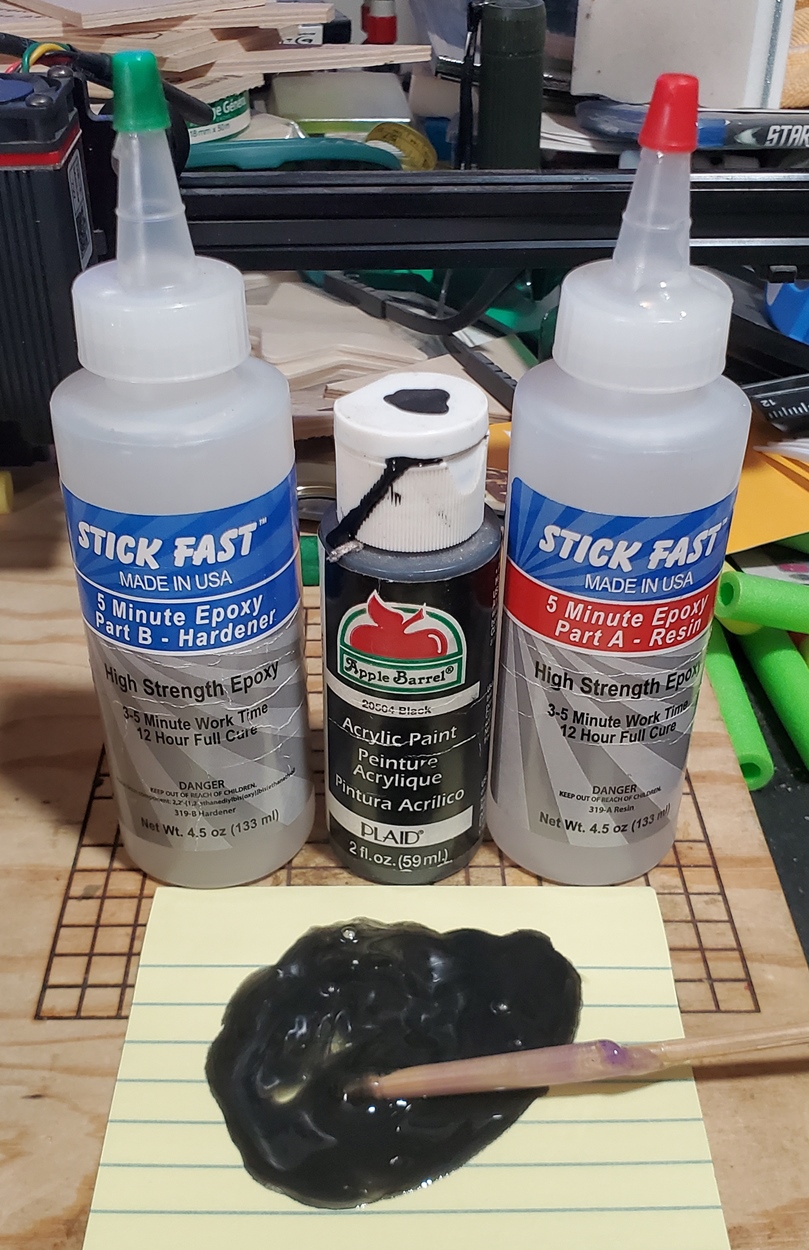

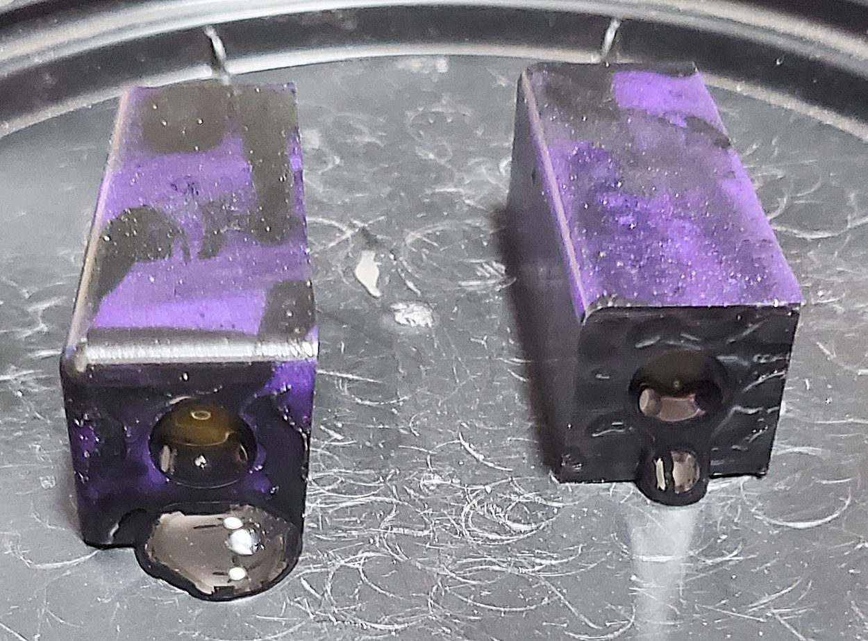

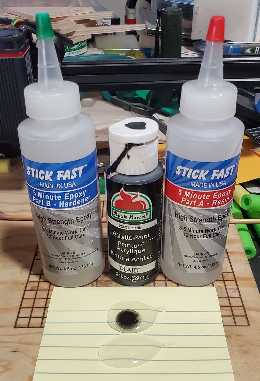

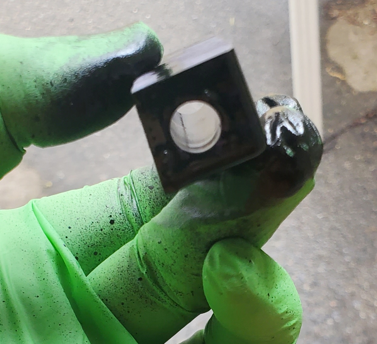

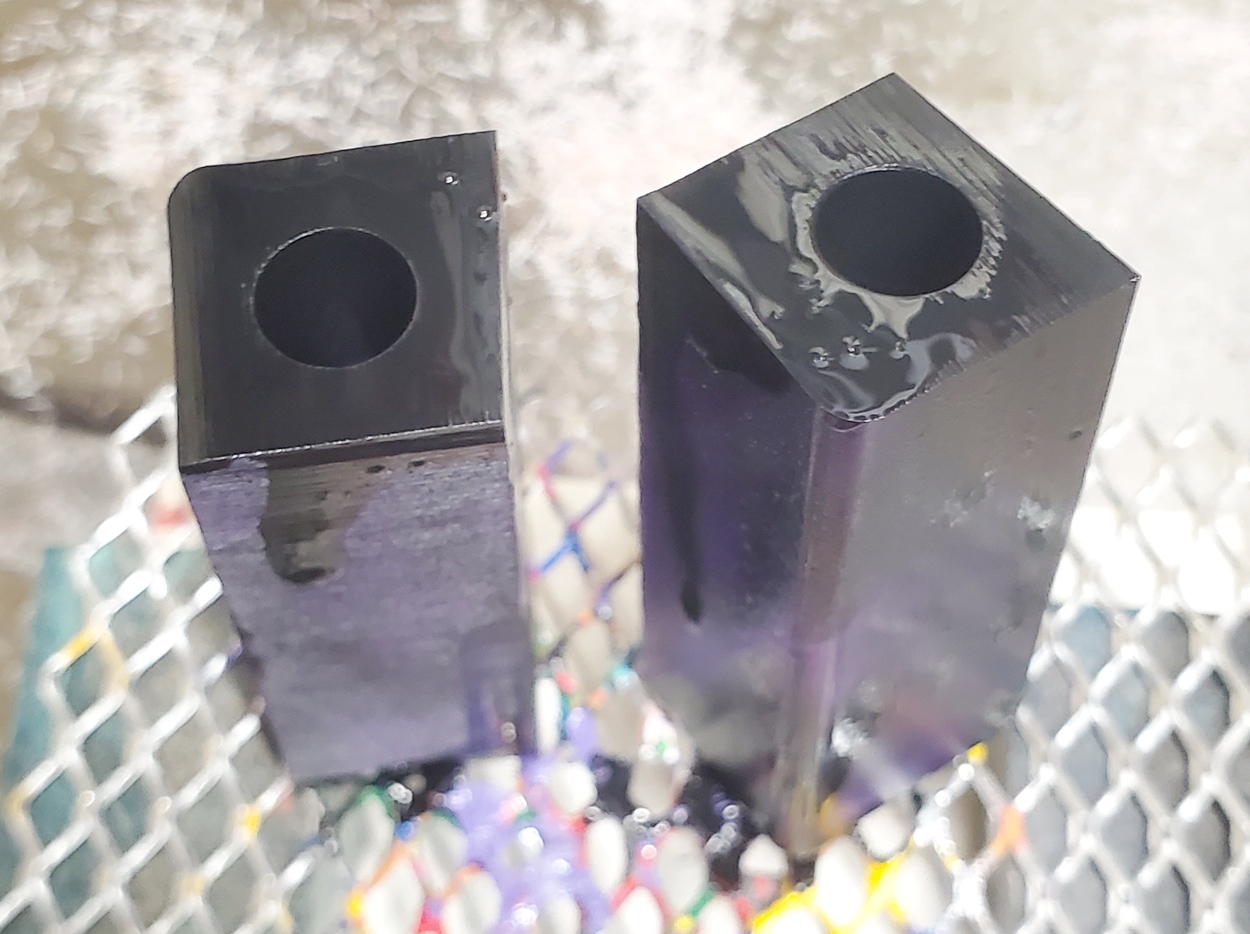

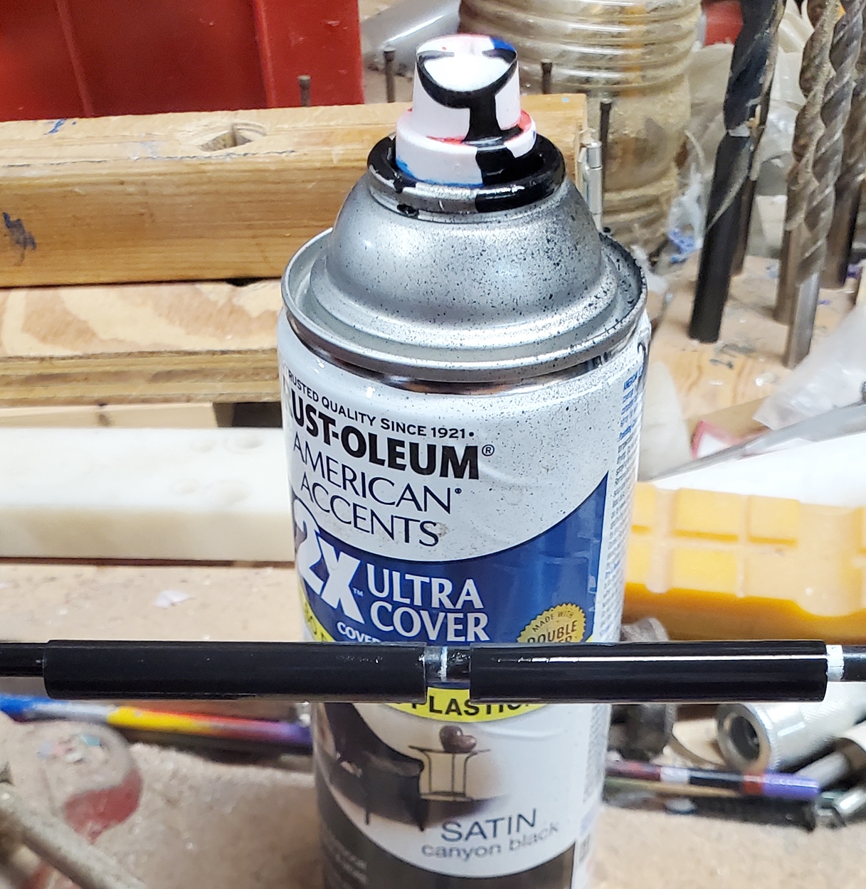

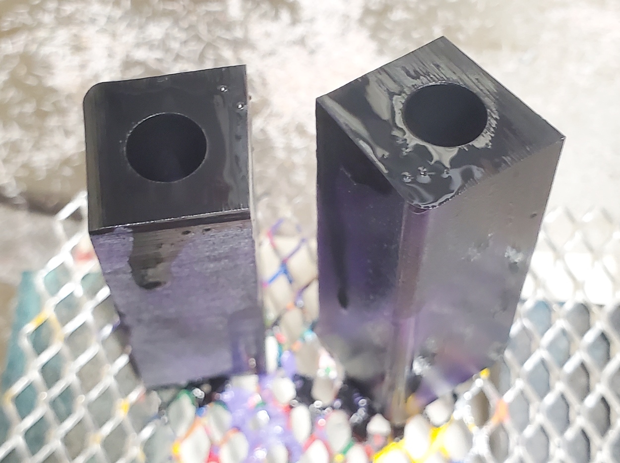

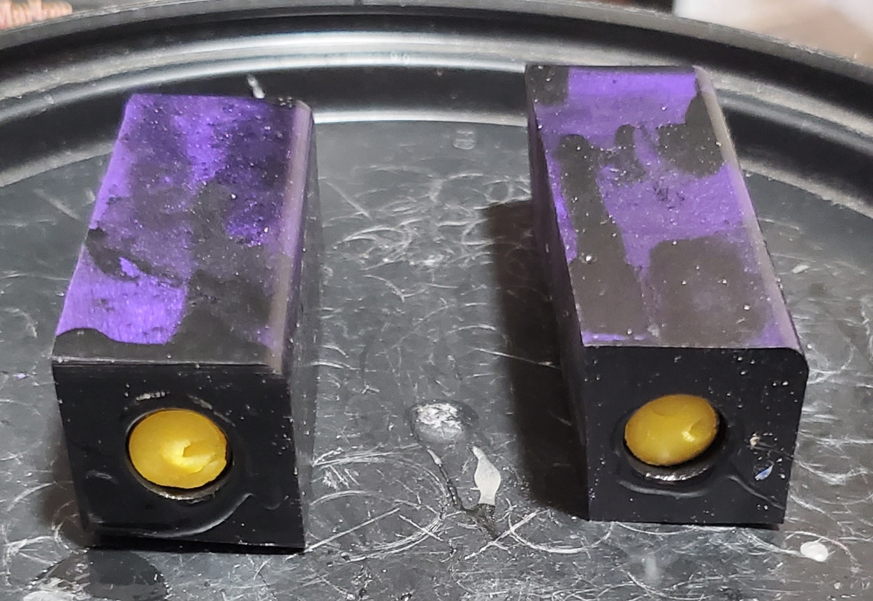

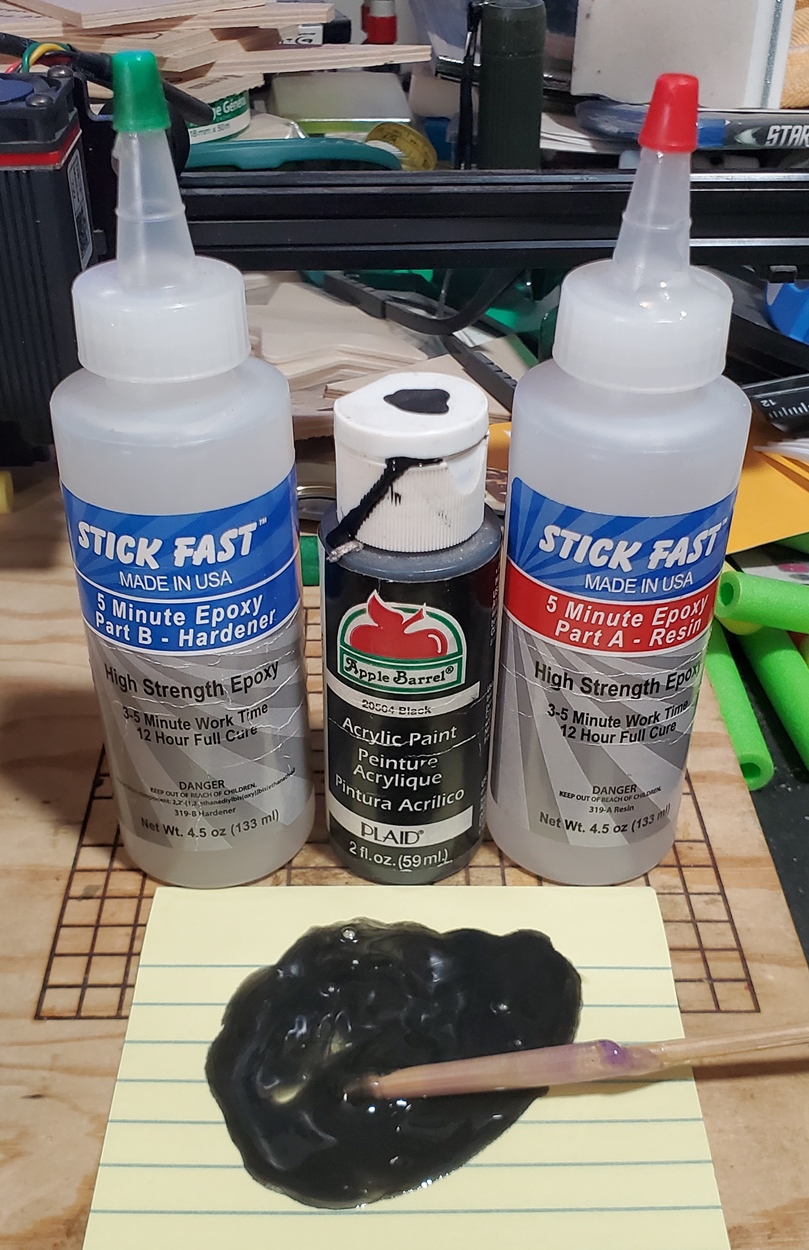

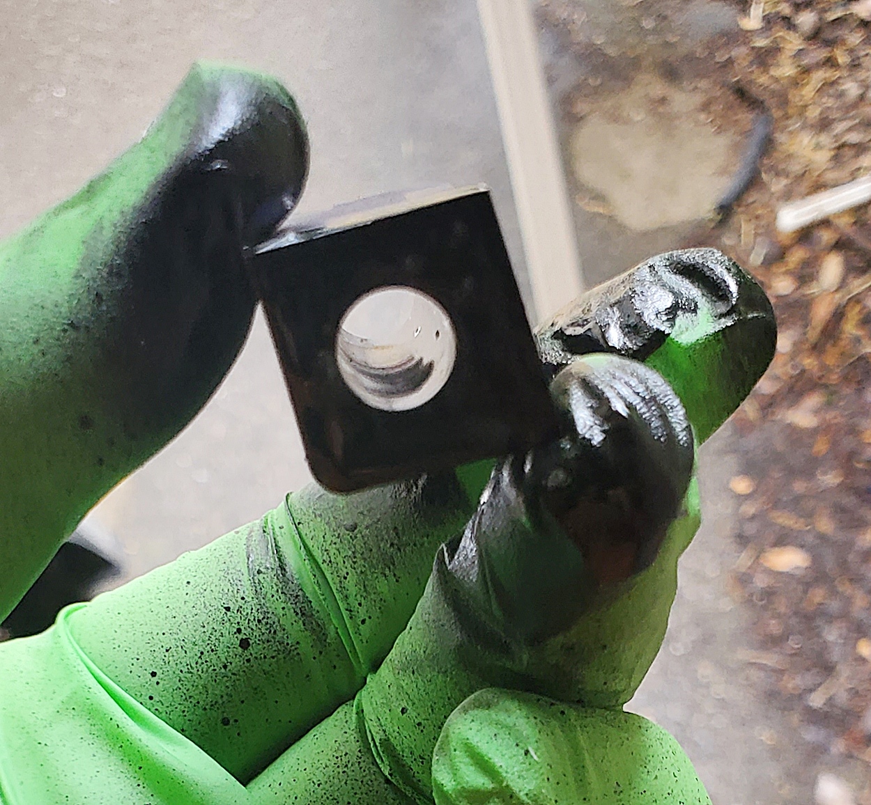

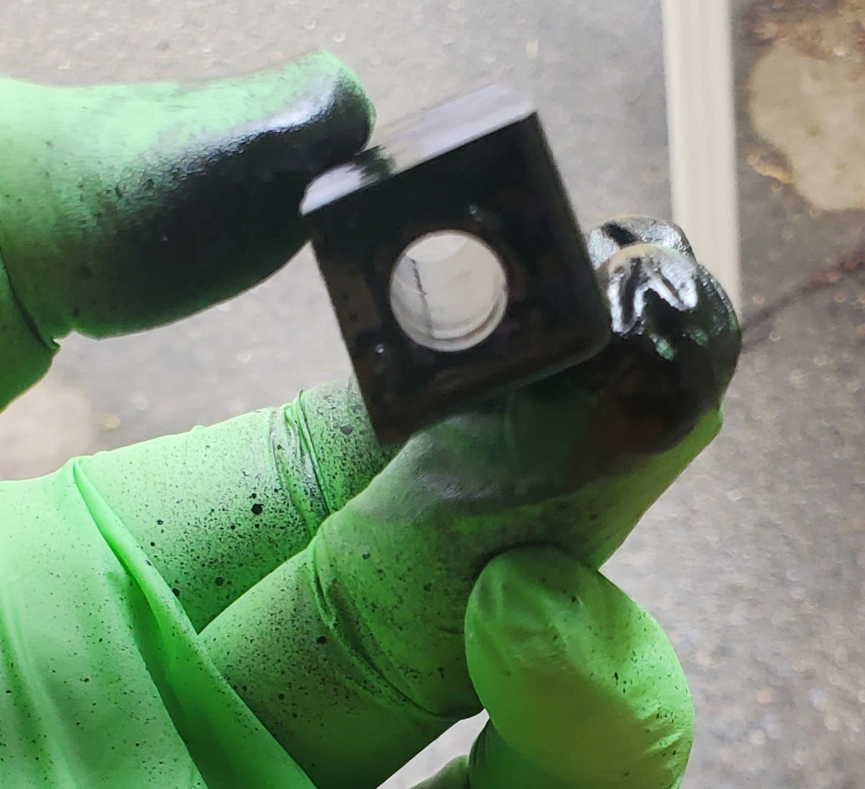

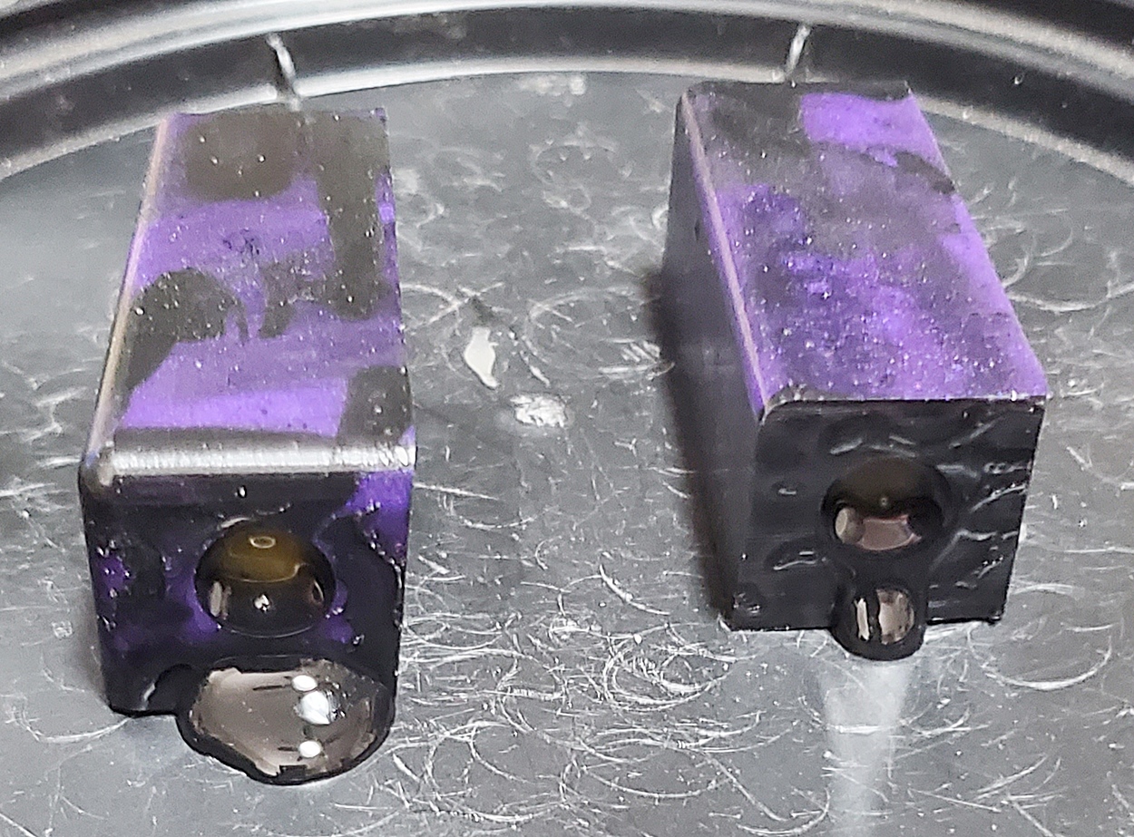

I never use CA. I've been using two-part epoxy for over 20 years. I normally use 5 minute, but if I'm gluing multiple pens I'll use 15 or 30 minute epoxy to give me more time. I paint almost all acrylic blanks so the brass tube doesn't show through. I paint inside the hole in the blank and the brass tube. I also color the epoxy, which you can't do with CA. One or two drops of acrylic paint is all it takes.

I've just used a shop paper towel to wipe off any excess and a q-tip to remove any glue from inside the tube. There's many ways to keep glue out of the tube. You just don't want any to harden inside of the tube.
