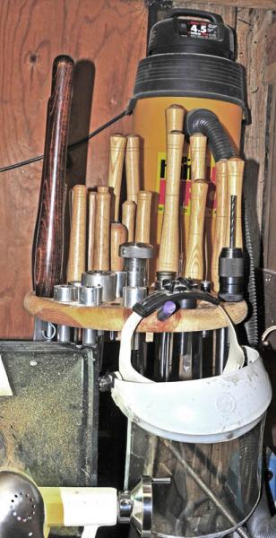

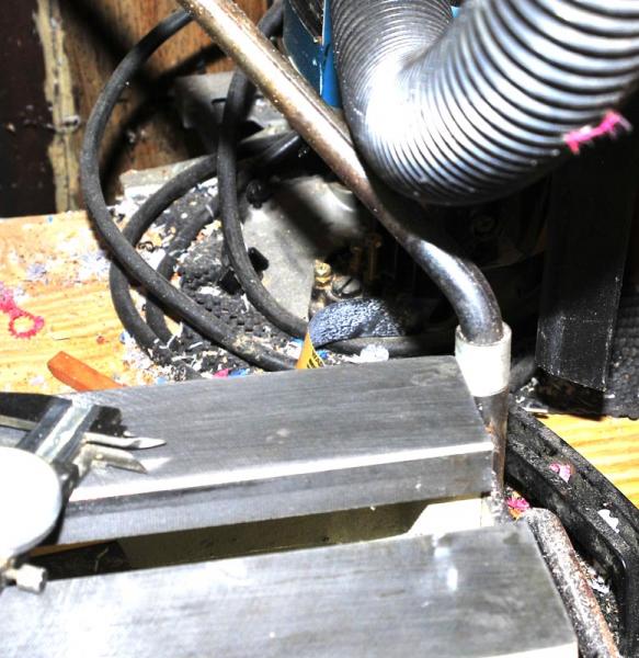

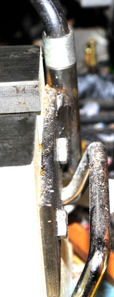

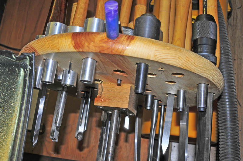

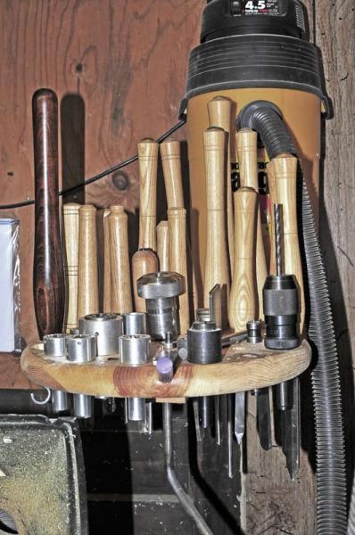

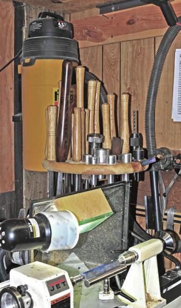

How about something like this. I mounted a piece of pipe, welded to a steel flat, drilled and bolted to the end of my lathe. Using 1/2" cold roll rod, cut and bent as I desired, I inserted bottom end into the pipe and placed the top end into a 9/16 (approx.) hole in a block screwed and glued to the bottom of a stool seat. (At least that's what I think the intended use was:eek:) As you can see in the photos, I drilled the necessary size holes for turning tools, centers, custom made die holders, various type chucks, a dowel in the center for my collet chuck, etc. A bad blank glued into the outside for to hang eye protection. Hey, It works and was cheap. The tool holder is free to rotate, and by pushing back on it, you can swing it out of your way, if it get's in your way. :rolleyes::rolleyes::rolleyes:

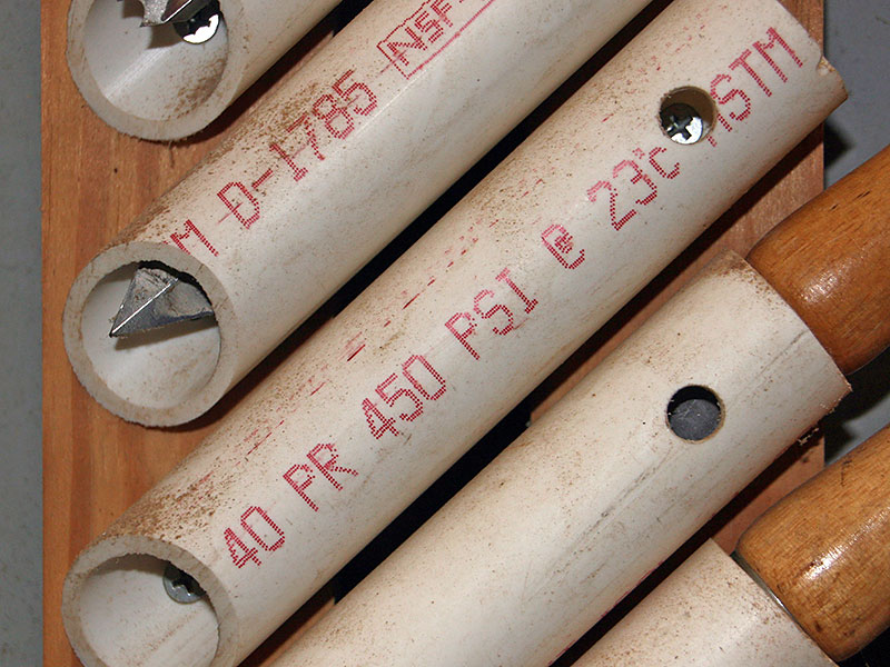

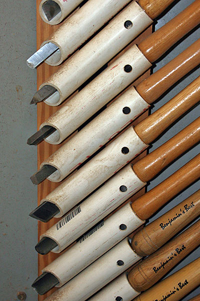

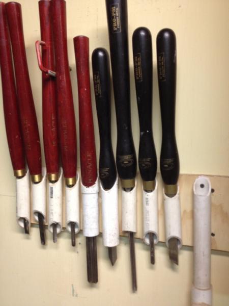

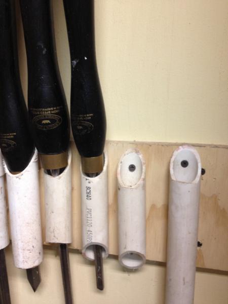

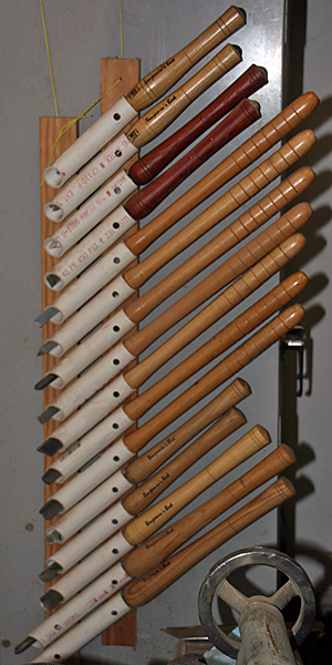

This is what I made:
The rack is stuck (with magnets) to a steel cabinet next to the lathe. I cut the PVC pipe to length and mitered the end so I can see the tips of the chisels. I drilled a hole (just through one side) near the upper end of each pipe and screwed the PVC to a wood backing.
I don't recall what diameter pipe I used, but it's just big enough for the ferrules - which holds the chisels nicely. It's very convenient to have them mounted right next to the lathe.

I finished mine yesterday, 30 degree angle at the top, open on the bottom and just screwed to a wood frame. Single wood screw did the trick and I used CA to attach the two smaller sections to the front. I have a row on both sides of the frame and it seems to be pretty sturdy

Wow, nice rack. Gonna have to redo mine to be like this one...
Jeff: As Buggs (bunny, that is!:eek:) might say, be vewy, vewy, kaafull! Sharp edges pointing up?:bulgy-eyes:
I don't know about you, but I can visualize many scars on the forearms, if I would need to be reaching over them for anything.:mad:

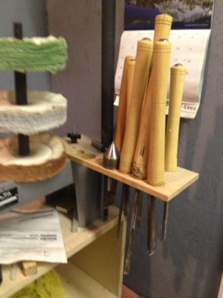

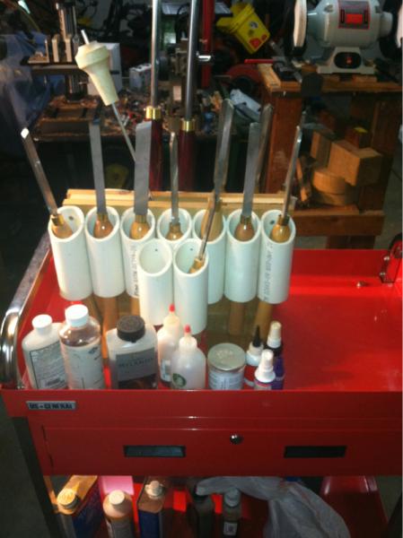

My set up, something fast and simple.

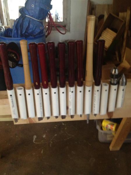

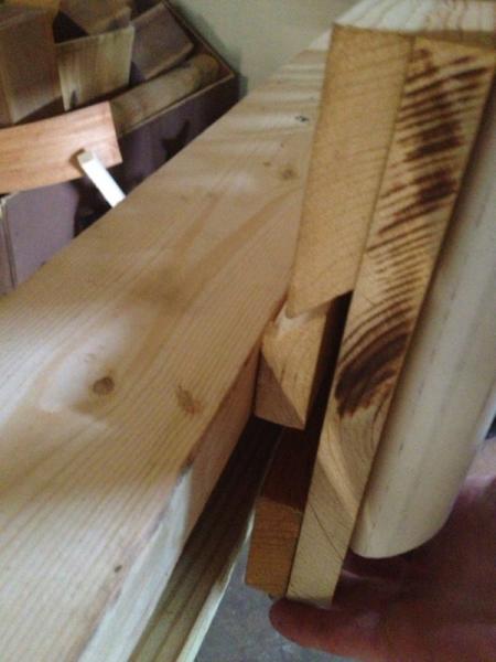

I made one today. Used the PVC idea. Two screws makes the pipes very secure. Angled bottom lets you see the tips - most of them anyway and keeps dust and shavings from accumulating.
I put a 45 degree cleat on the back so I can move the whole rack to wherever I put a cleat to hold it - wall, lathe, beefy sawhorse (as it is now).
