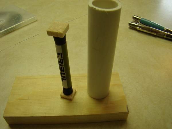

To keep the barrel straight with 3/4 in PVC I glue a square piece of wood to the end of the cork that was just slightly less than 5/8 inch. As long as you glue the cork to the middle of the piece of wood it will be perfectly centered.
