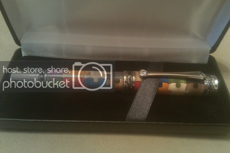

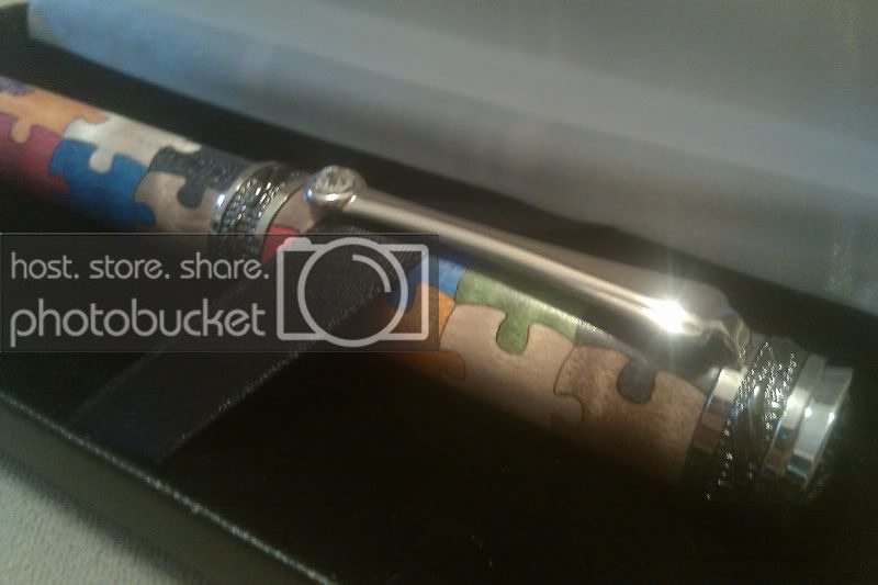

ok, thanks for all the advice and tips.I finally got around to making the kit sunday. All comments welcome. Keep in mind, this is my first lazer cut kit. (and I am aware my pics aren't the best, I was off to work and used my cell phone real quick)
It was supposed to be for my sister for x-mas, but when it was all done, it seemed to be a bit big for her. so i might have to buy another one in the junior kit.
